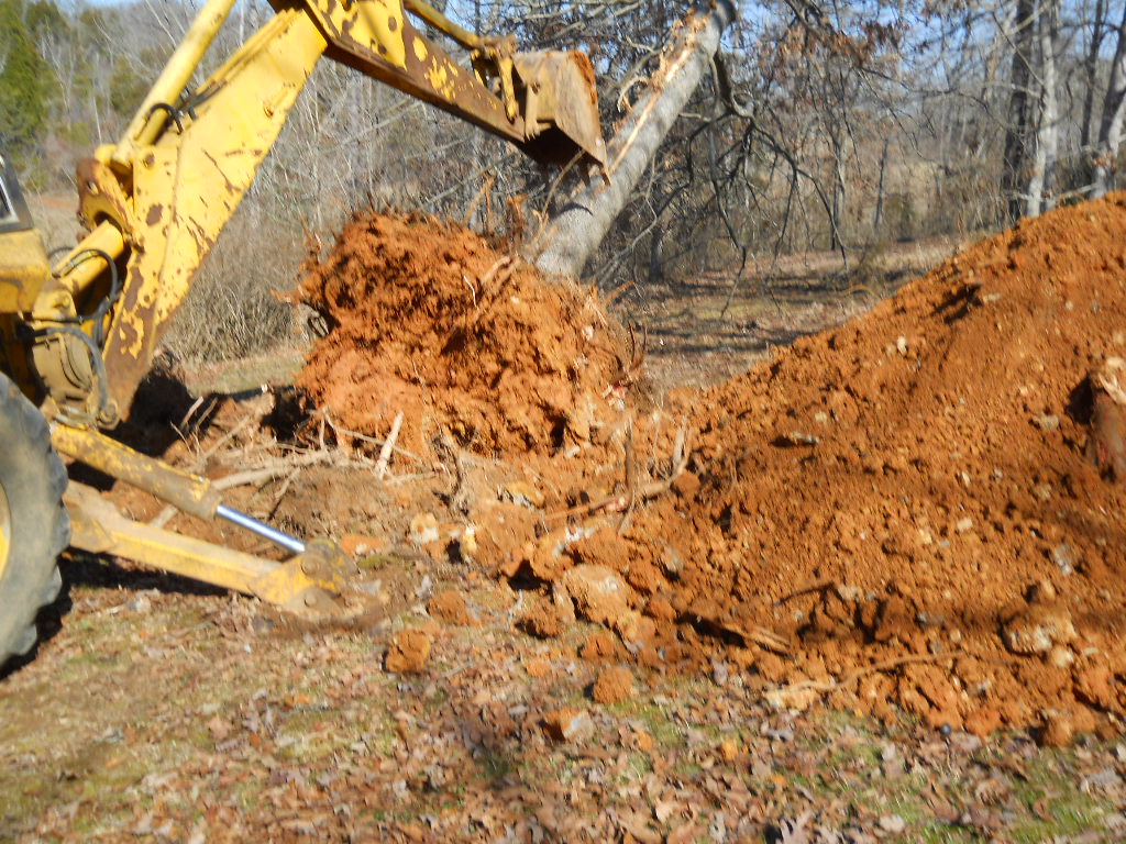

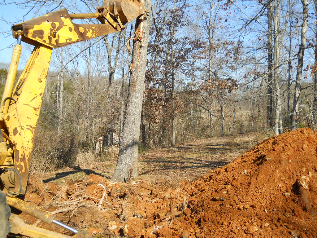

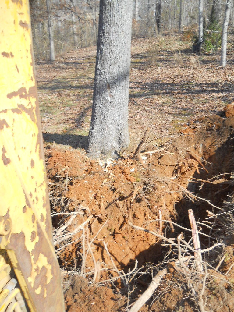

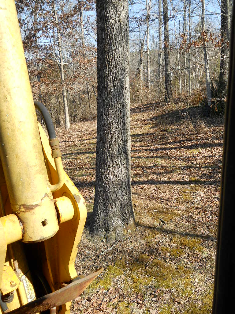

The fastest, easiest and cleanest method that I'm aware of is to dig down through the roots on both sides of the tree, then change positions and do it again on both sides so you have a big, deep trench on all four sides. The tree will stand there during all the digging and cutting through the roots. Then decide where you want it to go and get on the opposite side. Reach up as high as you can and push it over. Sometimes this works quickly, other times you have to dig a bit more. I use the tip of the teeth at the corners closest to the tree and dig under it.
This is essentially what I did.
I dug on three sides, leaving the falling side intact thinking it would act as a 'hinge' and help hold the tree (in case it decided to fall towards the house)
Maybe it's a good excuse for you to rent a large backhoe?
This was my wifes uncles house next door and the tree was right where his son (her cousin) wanted to build out the patio.
Was a bit nerve wracking but it's gone and he cleaned up the mess.
