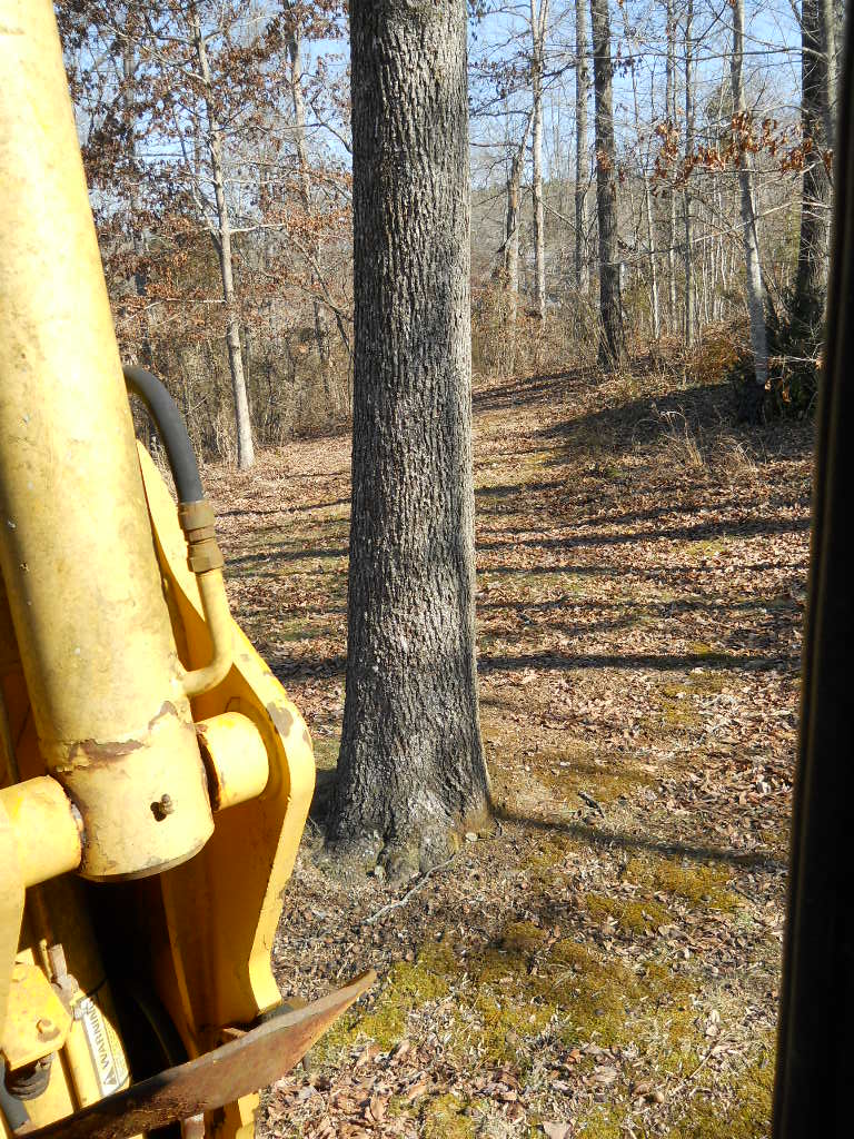

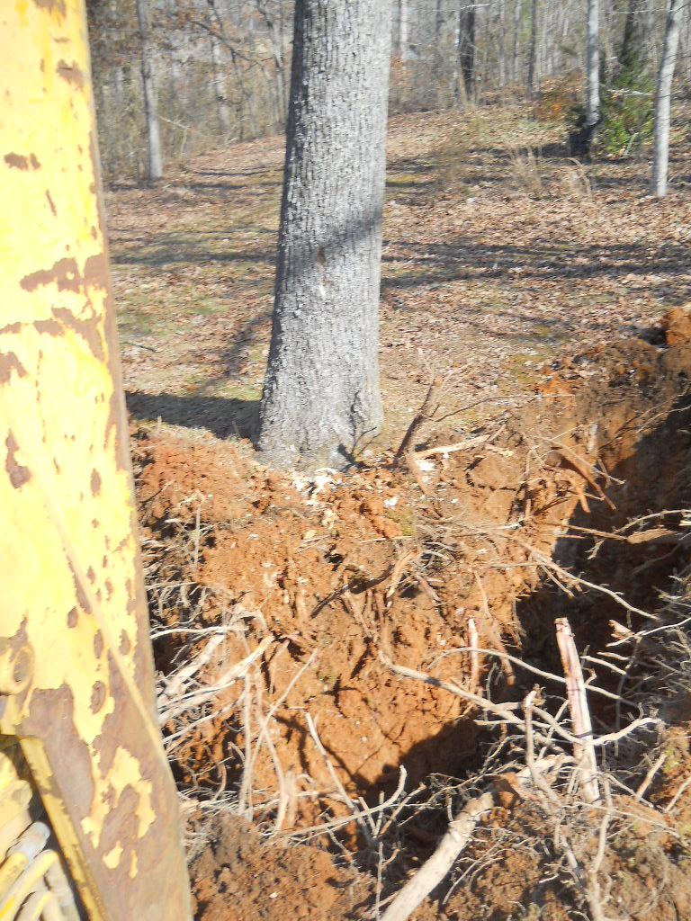

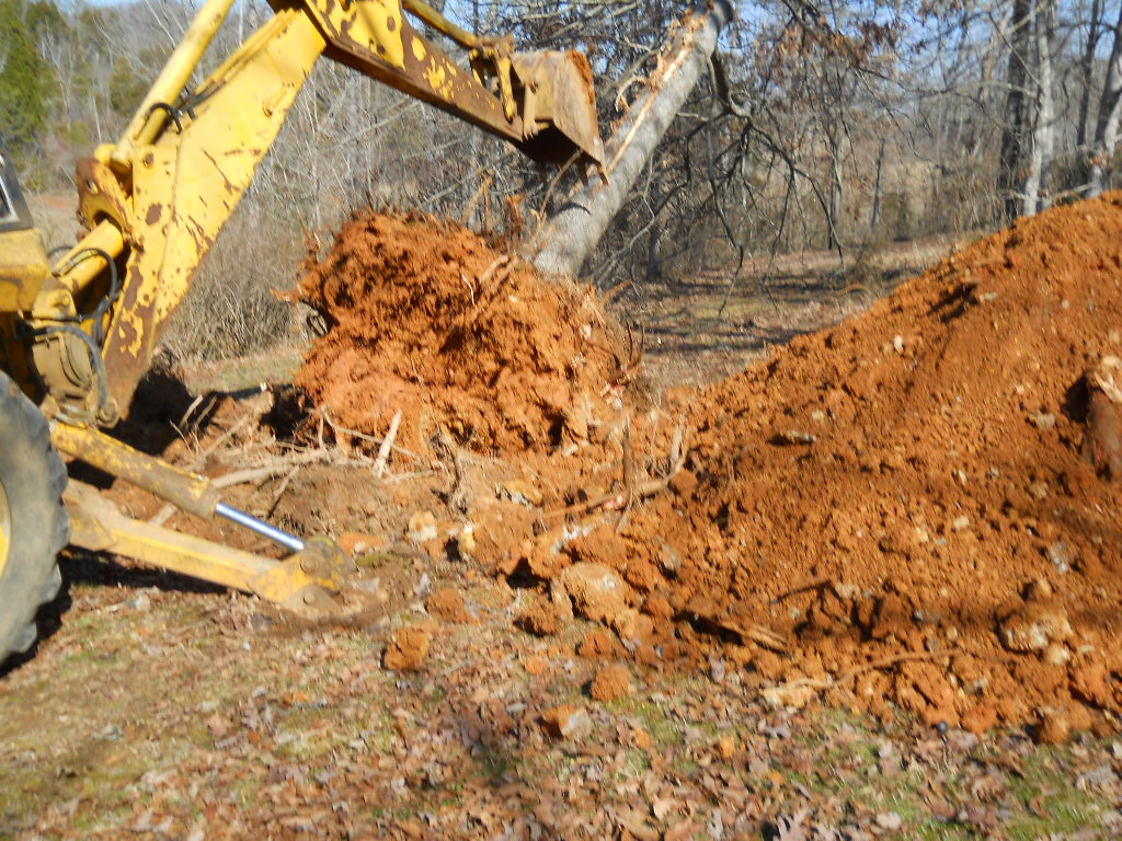

The fastest, easiest and cleanest method that I'm aware of is to dig down through the roots on both sides of the tree, then change positions and do it again on both sides so you have a big, deep trench on all four sides. The tree will stand there during all the digging and cutting through the roots. Then decide where you want it to go and get on the opposite side. Reach up as high as you can and push it over. Sometimes this works quickly, other times you have to dig a bit more. I use the tip of the teeth at the corners closest to the tree and dig under it.

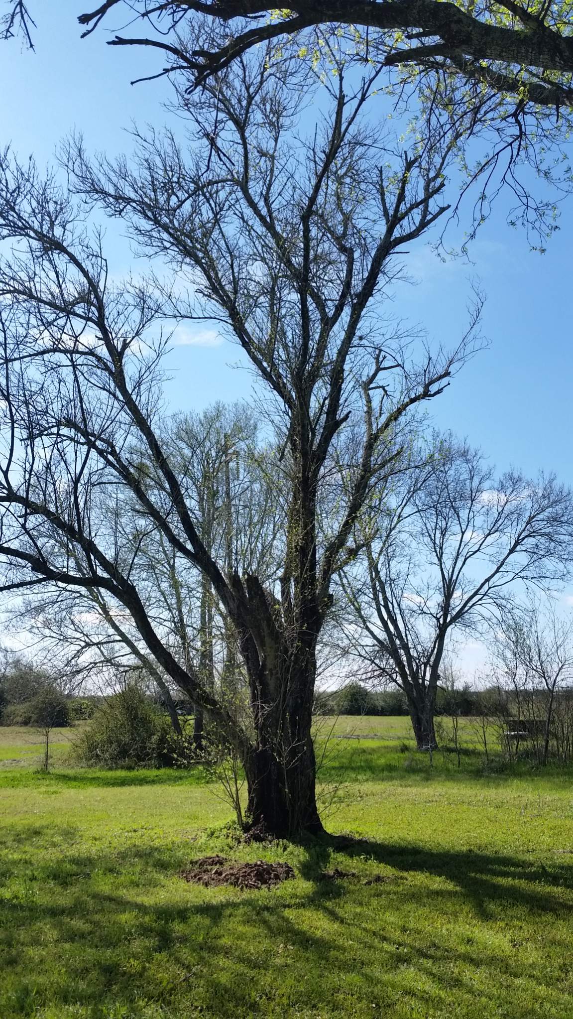

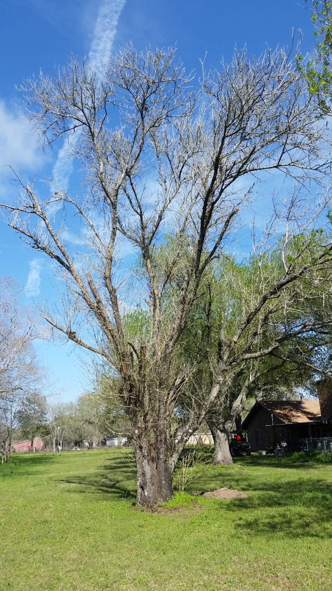

Pictures of the offending tree..
I might see if I can rent a larger backhoe - or maybe see if one of my neighbors will let me borrow theirs for an afternoon.
As for the pool, I'm going to put down a heavy base of sand over the top anyway - I've had above-ground pools before and never had an issue with that.
I've taken out many many smaller trees with my BX25 before, and when I rented a big JD 310(?) several years ago I used it to dig out at least half a dozen larger stumps. I used the method described where you dig a trench all the way around and push the remains over.
Keep the ideas coming guys! I appreciate it!

After seeing the tree, if you want it done safely and in less time than a solid 20hrs work, then ya, rent a larger machine

After looking at those pictures, why don't you just cut it down with a chainsaw then dig out the stump? :confused:

It looks like the top broke off some time back. If so, decay could make anything you do trying to push it over very unpredictable and unsafe. Cutting it down could be risky, too. Get someone over there with a BIG excavator and he can safely have it on the ground and dug up in less than half an hour and can prep the ground, too.

Speaking as a former professional tree surgeon, that is a potentially very dangerous tree to try to push over, regardless of size of machine. The bigger the better though if it has to be done by push and trench method. There is dead wood hanging overhead and lots of leaders that can't be evaluated by your pics except to say they pose problems.
Best over the net evaluation with existing pics is drop as many leaders as possible then drop the remaining stalks and then dig out/grind stump or dig it out/burn it out.
Hard to tell what the center area of the trunk poses; rot/decay or solid connections to the various leaders, and therein lies the potential for things to go from bad to worse.
I say hire a pro and get it done safely. Any thing else is sheer foolishness.
People will tell you all day long how many times they've removed a forest full of trees simply and easily with this or that piece of equipment, BUT they won't be there to pay your hospital or funeral bills, of that I'm absolutely certain.
Your life is the only one on the line.

From what I can tell in your picture, the branches look like they are blooming and the rot is all pretty much broken off already. I like how open and flat it is with plenty of access. This looks like about an easy a job as you are going to find to take it all out with a backhoe. I've never used a compact one, so that would change my opinion, but for a full sized backhoe, it's a piece of cake.
I would dig my first trench on the side you want it to fall. Dig it deep and get all the roots you can. Then on the opposite side, dig it down deep enough to get all the roots. My guess is they are a foot or two down, spreading out. If they are too thick to cut, go out a little bit farther until you can cut them, and then work your way back to the main tree.
Change positions so the backhoe is now facing the opposite direction of where you want the tree to fall and the hoe is facing the direction you want it to go. Dig out the roots on both sides and then push. Get as high as you can when you push and it should fall over easily. They always seem to fall in slow motion.
Look at the tree and decide which side has the most branches or which side you think is the heaviest. With all that room to work around, keep it simple.
I would never use a chainsaw to on this tree. Take it out whole and avoid the nightmare of dealing with the stump.
