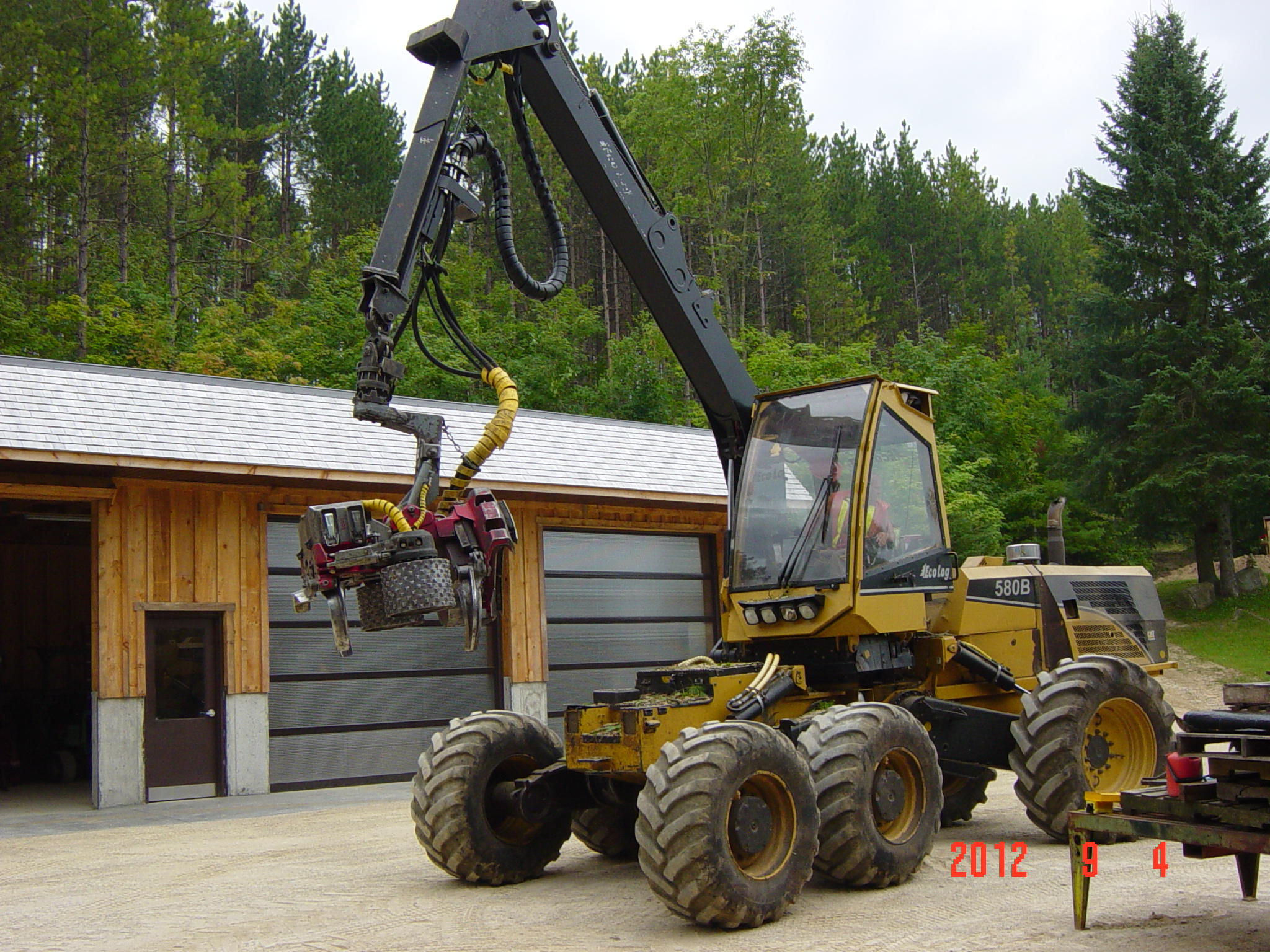

You say the right tool for the job. Well this is obviously it:
This harvester was on the property doing a pre-commercial thinning of our pines.
He also did some selective removal for me in a very short time. Could do in ten minutes what it took me a day to do. Plus, I would have damaged a lot of trees I wished to keep, or have trees hung up. He could grab them, cut them off and if need be carry them upright to a clearing, drop them, delimb them and cut them into pieces, leaving the slash all in one neat pile. All in maybe a minute!
These type of guys are never far away. You might get lucky.

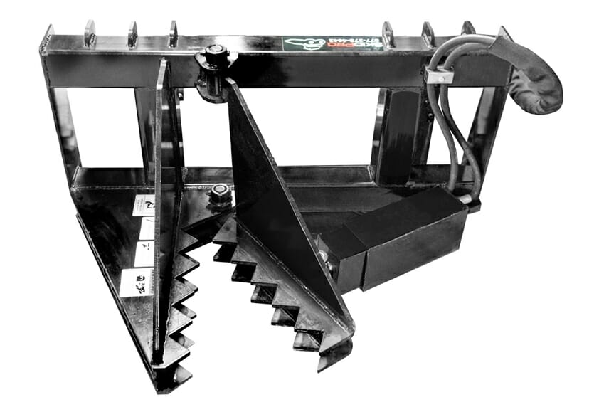

I don't have one yet but am seriously considering getting one. I have done more than a fair share of research and narrowed it down to this one.12" Rotating Tree Shear HD 5" Cylinder Skid Steer Tractor Loader Attachment tire It is pretty much the same spec as the one you linked to but is about 1K less. I agree with others that I would not use one on a very small tractor. What size tractor do you have? Also, consider the stump issue. Do you plan on mowing over them, spraying or??? Other considerations could be (if your tractor is big enough) pushing the trees over and pulling them out with either a grapple or a Dansuser Intimidator tree puller.Intimidator Tree Puller by Danuser saw, dig, pull, and carry any land growing obstacles trees or bushes

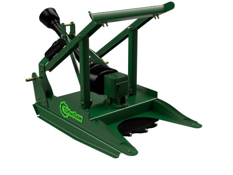

Another alternative may be the Turbosaw LT3200. It will cut off tree and push it away from Tractor. It mounts on your 3-point and can cut stump below ground level.
They also make similar unit with a grapple lid.
2017 TURBO SAW LT3200 For Sale - YouTube
That looks like a great machine for what I need to do I like the idea of pto power and a grapple. But with a shear might be a little safer to have helpers to spray stumps around.
