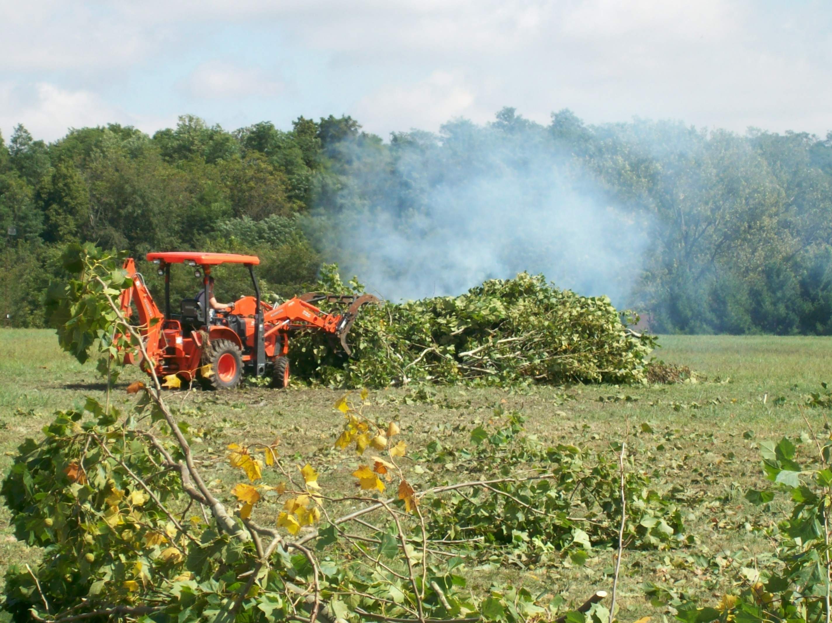

xfaxman how do you like the telehandler and did it work good with the shear? I was thinging that it would speed cutting around fields and still be able to handle hay bales and a hay accumulator?
Someone mentioned using a shear with a grabber on it and I don't want that as it don't take much of a tree to push a excavator around little own a tractor. Below is some stuff I have cleaned up after storms and saved for lumber my favorite clean up tool is the b26tlb and grapple.

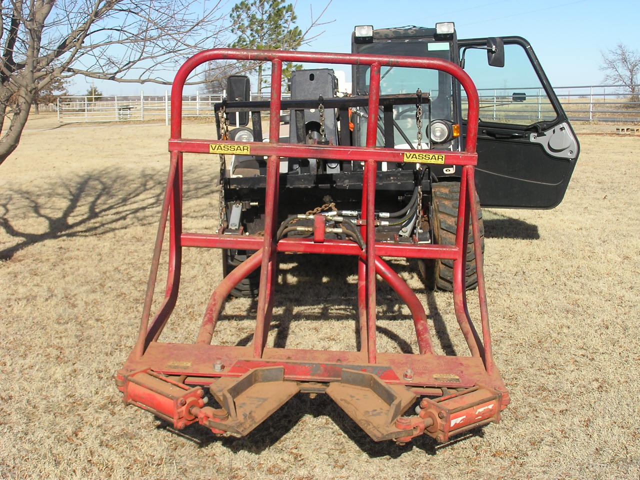

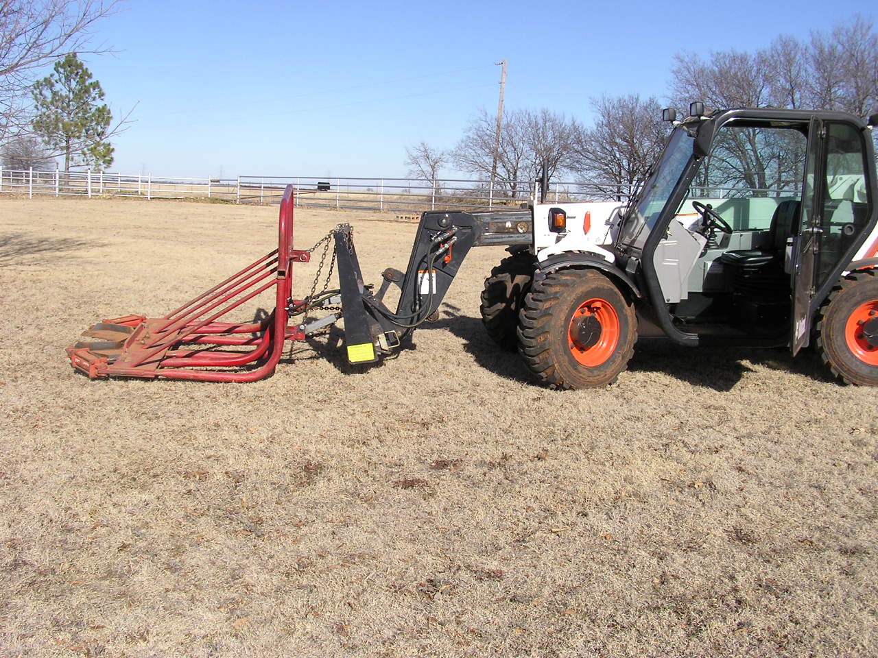

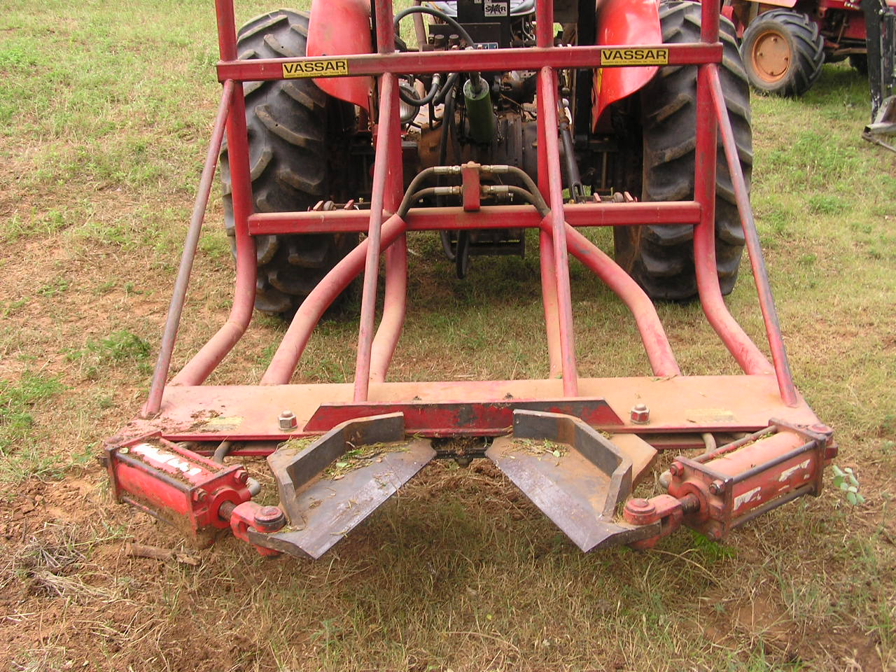

The compact telehandler is the most awesome machine that I have ever owned and I have owned more tractors than I count on all my fingers. :D
It was so easy, faster and no neck strain from looking behind trying to line up the shear.

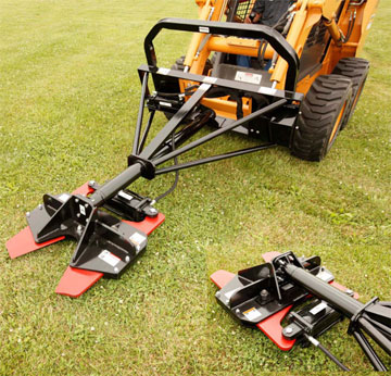

That old cedar tree cutter isn't made now, but you might look at this style: Tree Shears - Long Reach Tree Shear - XLR12UN | Sidney Attachments
And: "Commercial" Skid Steer Mount - Precision Manufacturing

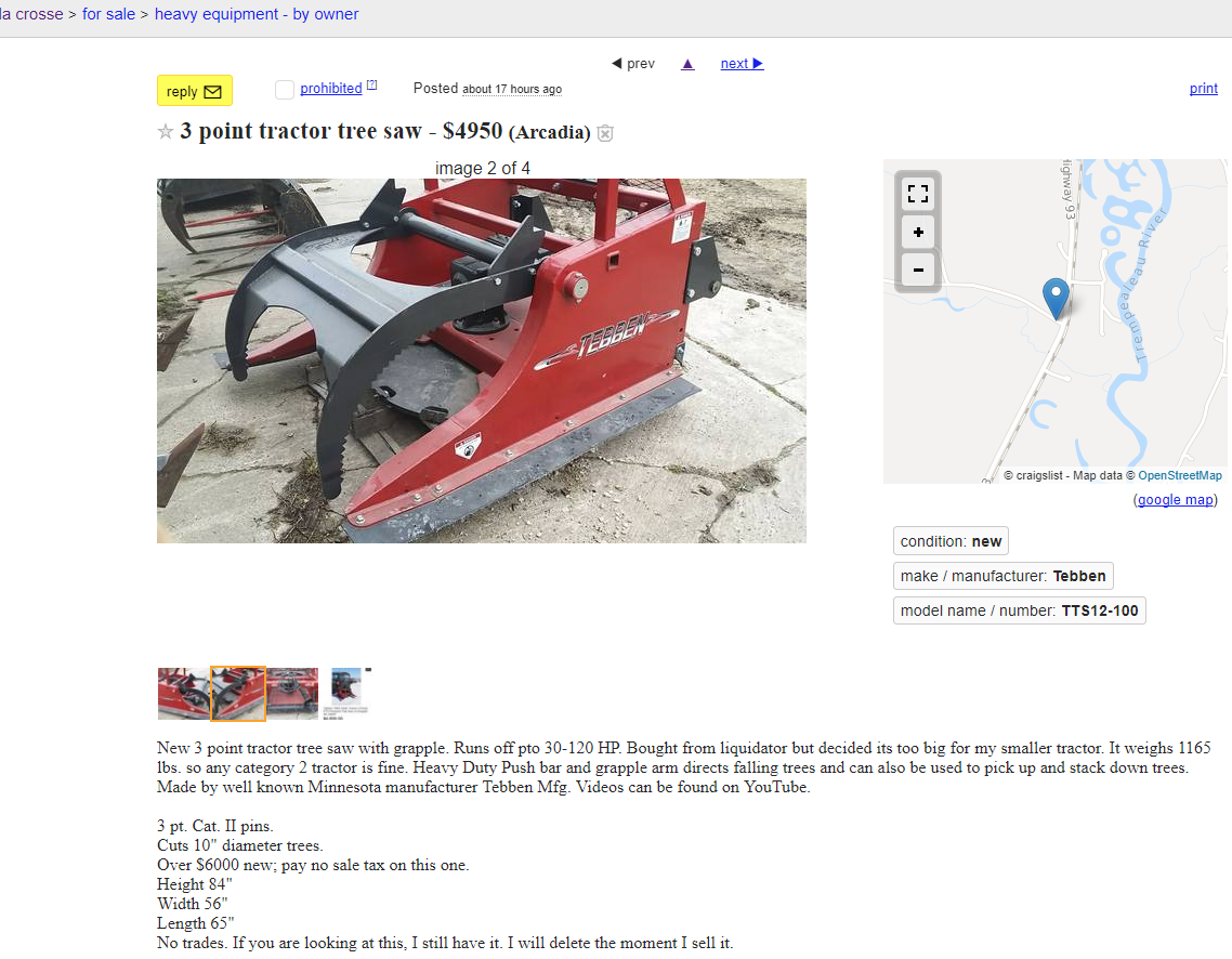

Not sure if you moved on something yet but the pto driven tree saw will remove a lot more tree(s) in a shorter period of time. Cuts clean to the ground. PTO version on a tractor has zero loss of power. Private party selling one cheap on craigslist in Arcadia, WI.2017Dec Craigs.PNG20170420_154356.jpg.

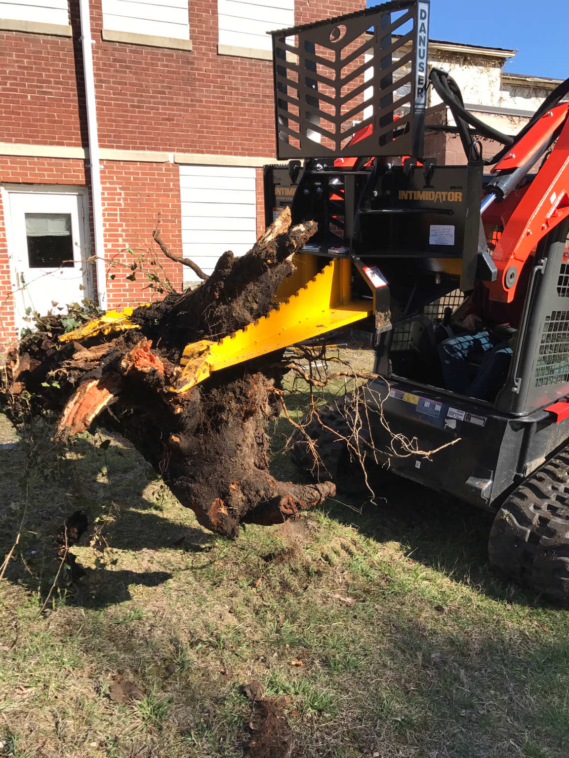

I've never used a shear, but I know a puller is WAY faster than a chainsaw. IMG_9353.JPG
/ Tree shear #33
I've never used a shear, but I know a puller is WAY faster than a chainsaw. View attachment 532438
Yep. For trees 6" and less, especially pine trees, a puller on a CTL will amaze you in it's speed. 2 or 3 times faster than a chainsaw. And no stump left behind.
I helped my neighbor clear app. 150 cedar trees. I ran the CTL with puller. He ran the tractor with grapple. He couldn't begin to keep up with me. Neither of us did any hard labor. :)
