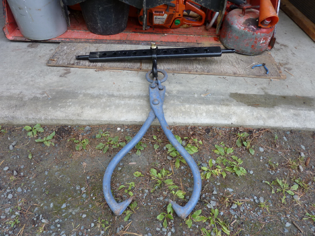

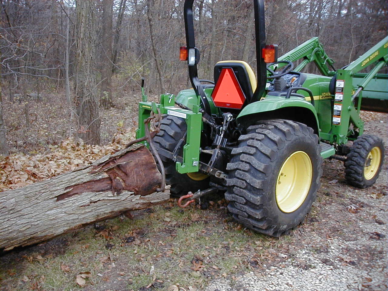

At the risk of being accussed of putting you in danger here is a picture of what I use. It is a draw bar that goes between the lift arms and a tractor hook. Both available at tractor supply. Be sure the tractor hook is big enough to accomodate the ring on the tongs. Just read the above thread and be careful.
gg

This is what I use. I made it out of an old reciever hitch a draw bar and some steel tubing. Handiest thing I've built for my tractor. Before the safety police beat me up, know your limits your tractors limits and pay attension and you'll be fine. No matter what you do logging is a deadly profession so be carefull.
