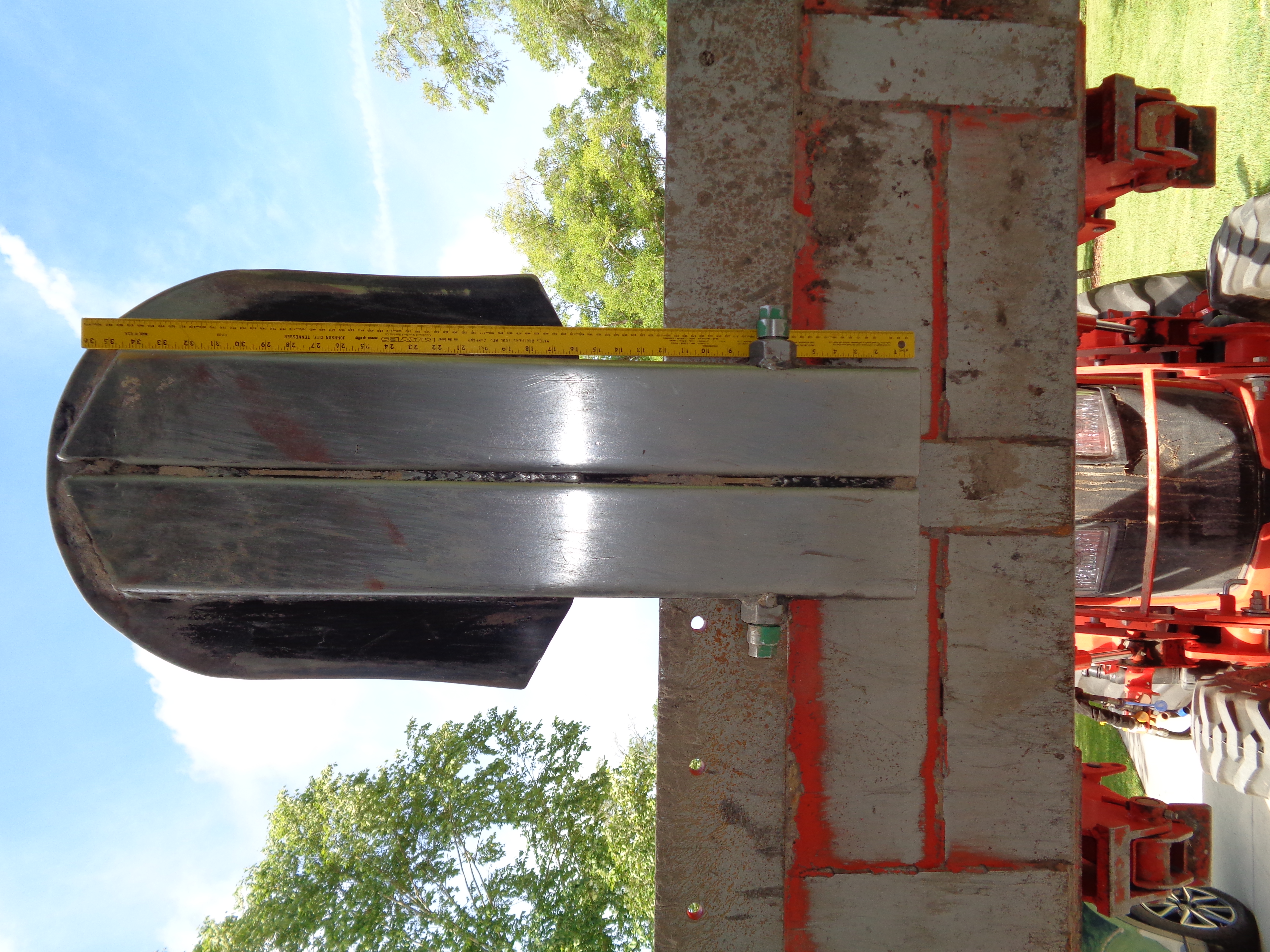

I owned a 36" length SSQA tree spade but found it too much for my 3,700 pound bare weight tractor with 37-horsepower. Bought it, tried it, sold it thirty days after arrival. Tractor requires SSQA {{Skid Steer Quick Attach}} FEL coupler for every tree spade I have seen marketed.
MORE: https://www.tractorbynet.com/forums...ylee-root-ripper-stump-bucket.html?highlight=
I have a 18" wide X 22" length (operating dimensions) clamp-on bucket spade from Bucket Solutions that would work well on your 2,700 pound bare tractor weight Kubota L, used with prudence. There are lighter, shorter bucket spades you should research and consider before purchasing the 100 pound model I have. The Bucket Solutions bucket spade is best on 3,500 to 5,000 pound bare weight tractors.
MORE: https://www.tractorbynet.com/forums/attachments/328798-bucket-spade-today-fel-bucket.html?highlight=
PHOTO: Bucket Spade on Kubota B3300SU, one of my previous tractors. Kubota B was significantly lighter than your Kubota L.
