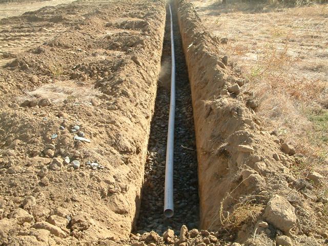

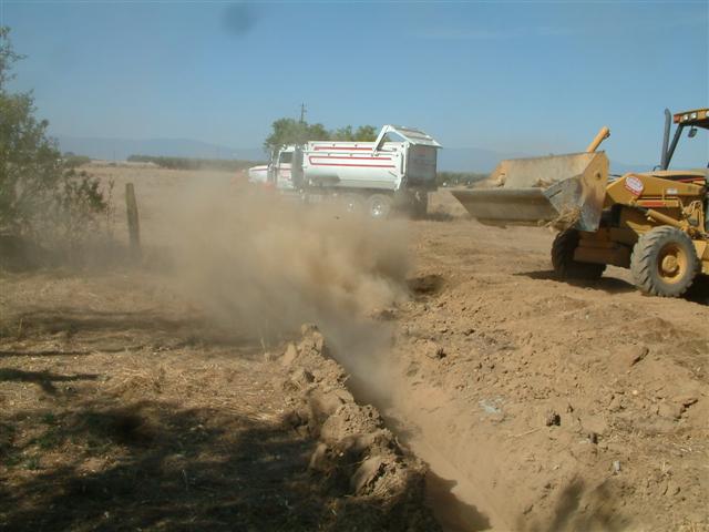

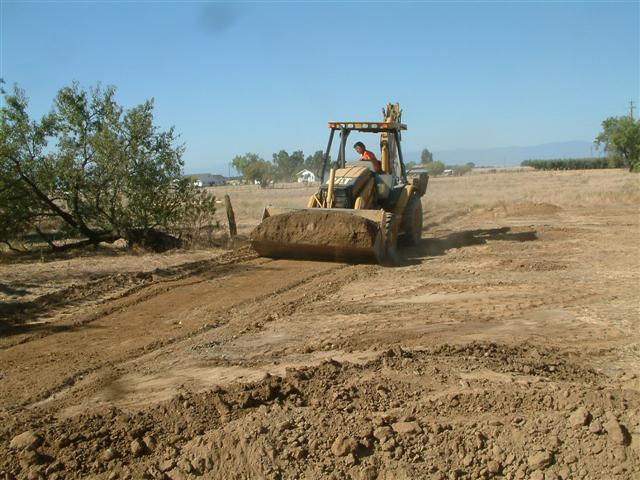

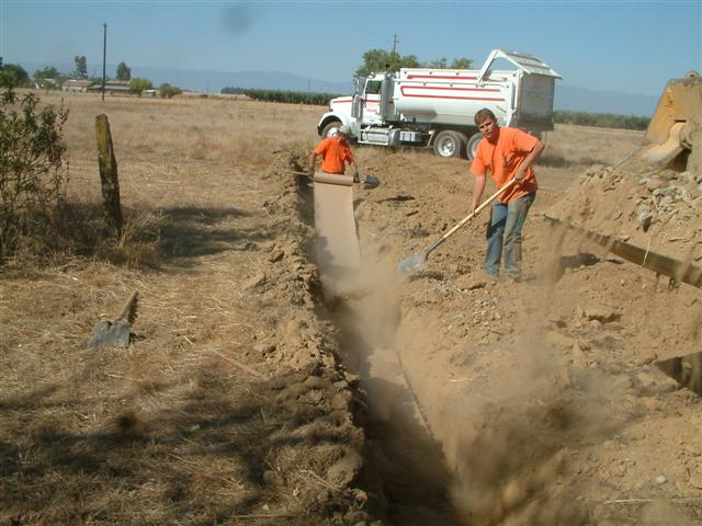

Here's what my contractor did when he installed the leach line for my septic system
That was in late 2005. Never have had a hint of settling along that trench since then. Nothing like using a big, heavy CAT TLB to get compaction:thumbsup:
