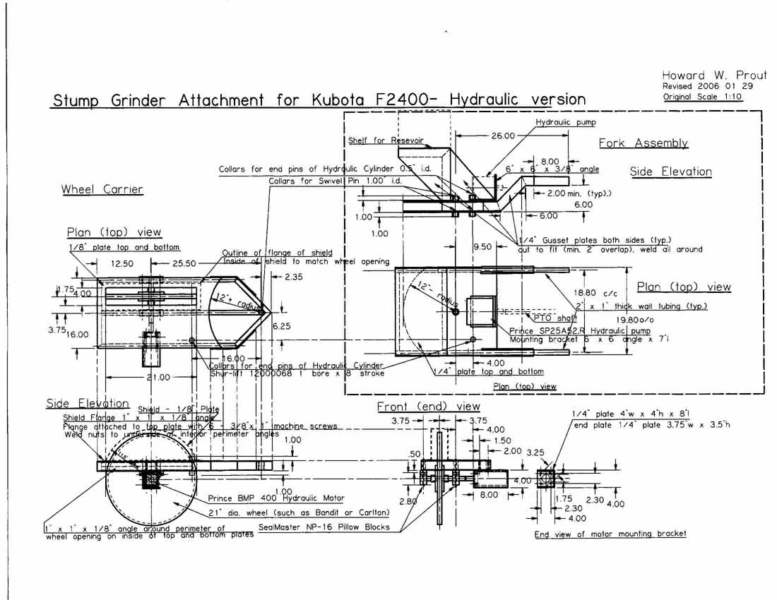

   / Trencher and poorboys stump grinder #34
Sandman's posts got my juices flowing again for a stump grinder, so I have been working at designing one for my F2400. I am working on the design of two versions, a hydraulic drive (see attached) and a chain drive (attached to the next post). I would welcome any comments on the designs. At the moment I tend to favour the chain drive version. /forums/images/graemlins/smile.gif

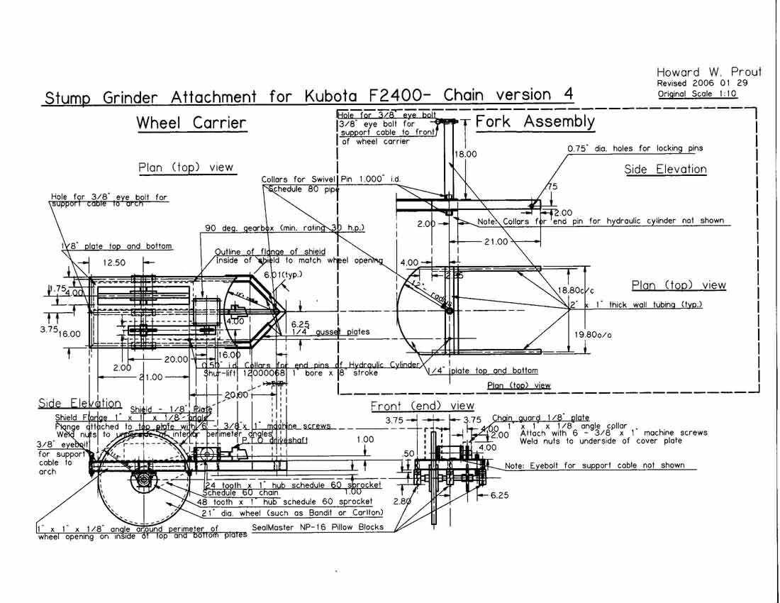

   / Trencher and poorboys stump grinder #35
Now the chain drive version. /forums/images/graemlins/smile.gif
