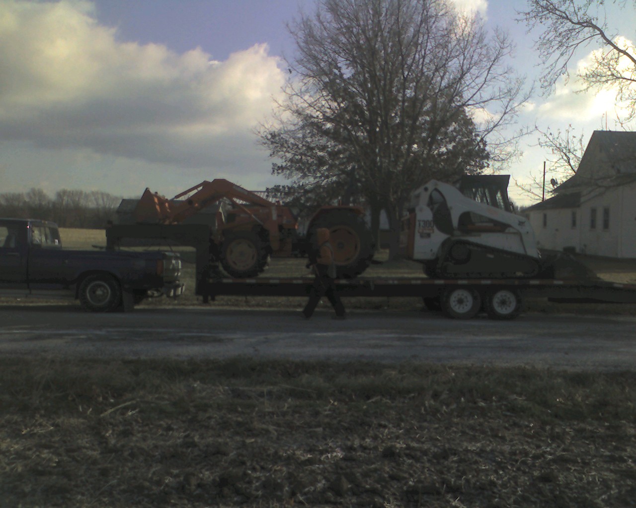

I went from a tri-axle pintle to a double axle gooseneck. The tri-axle would scrub the tires pretty bad but my trailer had the axles spaced far apart. Went from this
To this:

Same story here I had a tri axle gooseneck & handled like crap and had to have a pit crew with me any time I went some where. I built a 30' with 2 8k dexter's and 14ply tires rated @ 4,000+ each with the heavier rims, it handles better and I haul more on this trailer than the other because it handles and stops better. The trailer is a little over built as it wieghts like 7,000lbs empty and it a little tounge heavy which helps the handling big loads.
I would never go back to a tri axle and if I went with dually I would go with 12k disc brake dexters as they will stop you on a dime.
