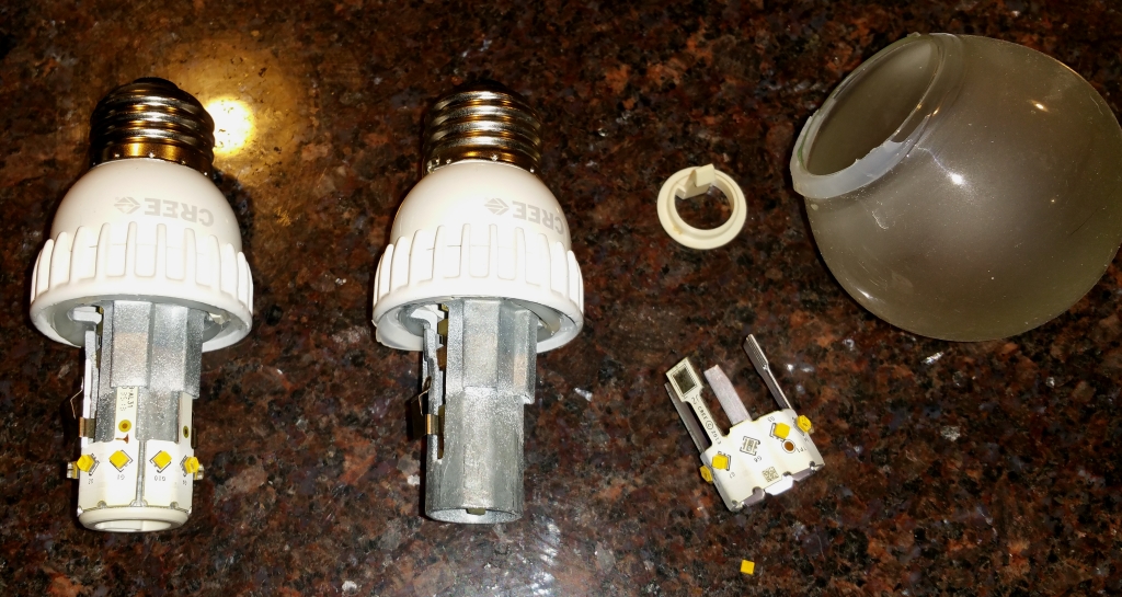

Many led bulbs, especially older ones, are clusters of led's.
Over time, as a few burn out, the bulb would put out noticeably less light.
Mine were cluster of about 8 LEDs but none of them quit working, they just got dim.

The LED aren't what normally dies. There has to be a converter that steps down the voltage and then turns it into a steady DC voltage. All of that has to be tucked into the base of the bulb. Any heat that is generated needs to be radiated away. I'm finding the Cree 60w bulbs I bought last year are failing due to, what I can only guess, poor solder joints. The LEDs are much dimmer but some of them will emit the correct amount of light again if I screw the bulb in a little tighter. I've cleaned up the base of the bulb to see if that's where the problem is but it didn't make a difference. I'll take one apart to figure out what's failing. If the bulbs weren't discounted due to state law I doubt I would buy them.
