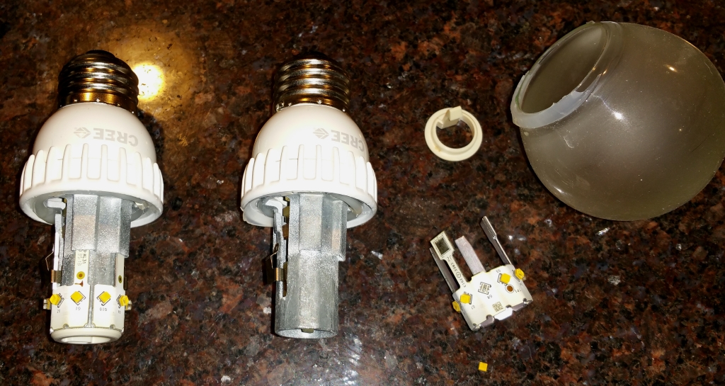

My Cree LED bulbs were in ceiling fixtures over a breakfast bar. Some were hanging down while others were mounted flush. My step father has one outside that only works when the temp is about 40f. I think Cree fixed the problem with the bulbs. The new ones are vented so maybe it's an issue with heat damaging something in the base and because they are hanging the heat rises towards the base, don't know.
I took two apart, one that worked and one that would just flicker. The globe is glass with something that feels like a rubber coating on it. The globe was glued to the base with silicone caulk. Was very easy to remove. Once off the LEDs are visible. They are tiny yellow squares in the pictures. There's a white clip that easily removes and then the LED assembly just slides off. I swapped LED assemblies between the two and that's what's bad. One of the LEDs (if you look closely at the LED assembly that's not on the base you can see it just below it) came right off as soon as I touched it while the others were stuck on and didn't come off. Maybe that was the problem and the newer bulbs being vented help remove the heat.

All of the ones I have put in are open... several bulb up and the rest horizontal as they are in 1950's ceiling lights...
No can lights in Mom's house.
The only one that is bulb down is over the table where she reads the morning paper... it is a CREE and similar to the flood lamp style... on a lot and the fixture is large and well vented...
Interesting about the one that fell apart.
