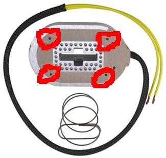

I can't make a blanket statement that all magnets have a visible wear limit because there are a lot of magnet brands out there.
However most quality magnets do have some type of wear indicator, because of all the variables I can't tell you what to look for on your particular magnets, some have a brake pad looking material covering the coil others have what looks to be a shiny black "potting material", look for shallow holes drilled or dimples pressed in the face , or a step molded in near the center hole, whatever the indicator is on a brand new magnet it should be somewhere between 3/32 and 3/16 inch with most of them being about 1/8".
If you check out this pic , the 4 holes closest to the corners will be about the depth I stated above, if any of those 4 are close to the bottom the magnet should be replaced along with it's partner at the other end of the same axle.
attachment.php
Ray

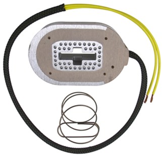

Let me make it a little clearer, with all the holes in the center boss it may be unclear which holes I meant.
attachment.php
If you pull your hubs for packing once a year that should be often enough to look at these, unless you do a lot of mileage on a camper or such.
Ray
