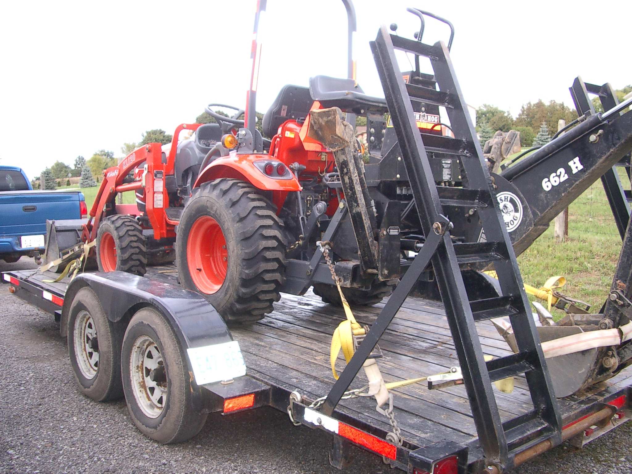

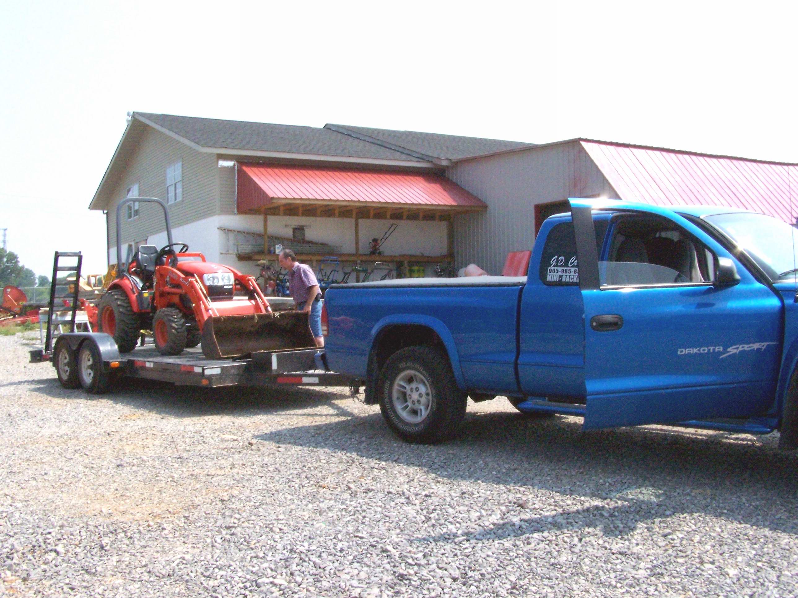

Mr Brown that setup should really work for you, I tow a 7000lb 16 ft trailer with brakes at all wheels with a Dodge Dakota v8 with trailer package and haul my ck20 loader and backhoe all the time with absolutely no problems, drew the Kioti home to Ontario from Tenn. this past summer . Have drawn cars at various times on the trailer and a large playhouse just had to load it on some 6x6's to clear the fender's then tie it done well. Now that I have the ck I could USE but don't need a little longer trailer and my next one will be a tilt but a 16 footer will suffice for your bx with hoe attached no problem as I had lots of room on the 16 ft for my B6200 with hoe and loader. If you want a small dump on the truck your are likely better to go for at least a 3/4 ton, but be aware as you raise your overall weight depending on the rig you end up with, you may get closer to regulations concerning licencing, annual inspections ,and daily inspections. Gary
