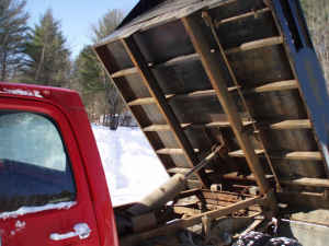

The dump bed conversion is a good question, one I've thought about a lot.
Option one, purchase a beater dump and swap out the body, probably the easiest option.
Option two, I don't think it would be overly difficult to make it dump. First, I'd hinge, with pins the mounting point at the back of the truck.
Second, I'd need to rig up a piston and linkage to push up to dump, I bet I could copy one from a photo. Trick would be how to power the piston, my first thought would be off of my plow set up. Or I could run 12V hydraulic motor like 12v dumps do.
Would be a fun project and I bet there are guys on this site who've done it.
I would take the easy way out and find a truck with a blown up motor or the like and pull a dump body off and weld / bolt onto my chasis.
If you can weld, the dump body does not have to be in perfect shape to fix up and use, I understand steel is getting cheaper every day.
This is a project I'd really like to take on this summer if I can get the pieces to come together.

   / TRUCK AND TRAILER TEAM. #104
As for unloading stone or the like from the old GMC, shovel and back, shovel and back.
Joel
They have the kits in "Northern Tool" with a load capacity of 4000lbs.
I think they are around $1,300

Just found this picture of a good example of a dump piston mounted directly to dump body, no linkage, looks simple enough.
Joel
