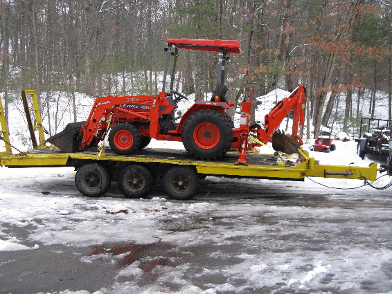

Here is a picture of the trailer loaded with Kioti.
And here is a picture of the GMC.

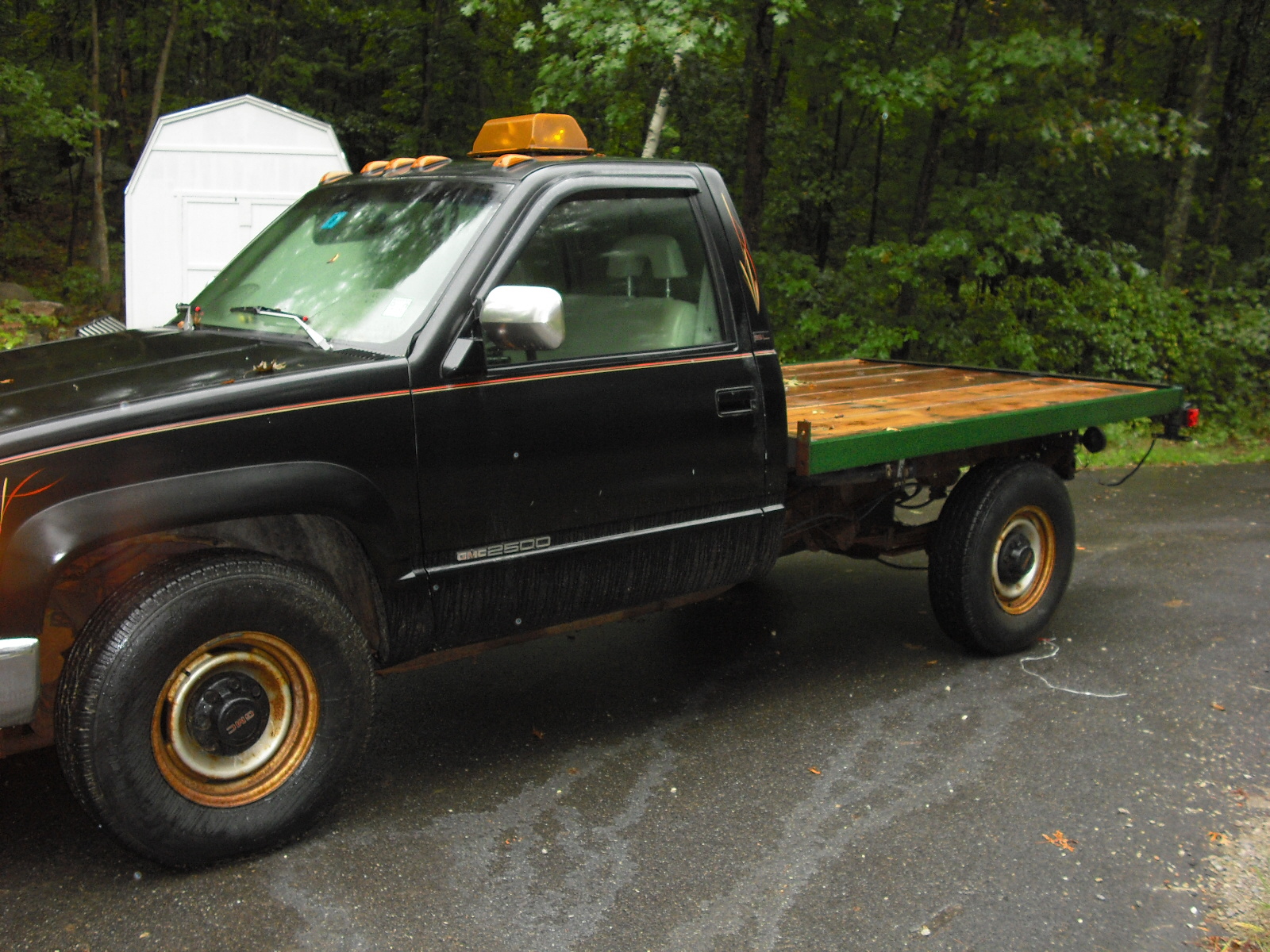

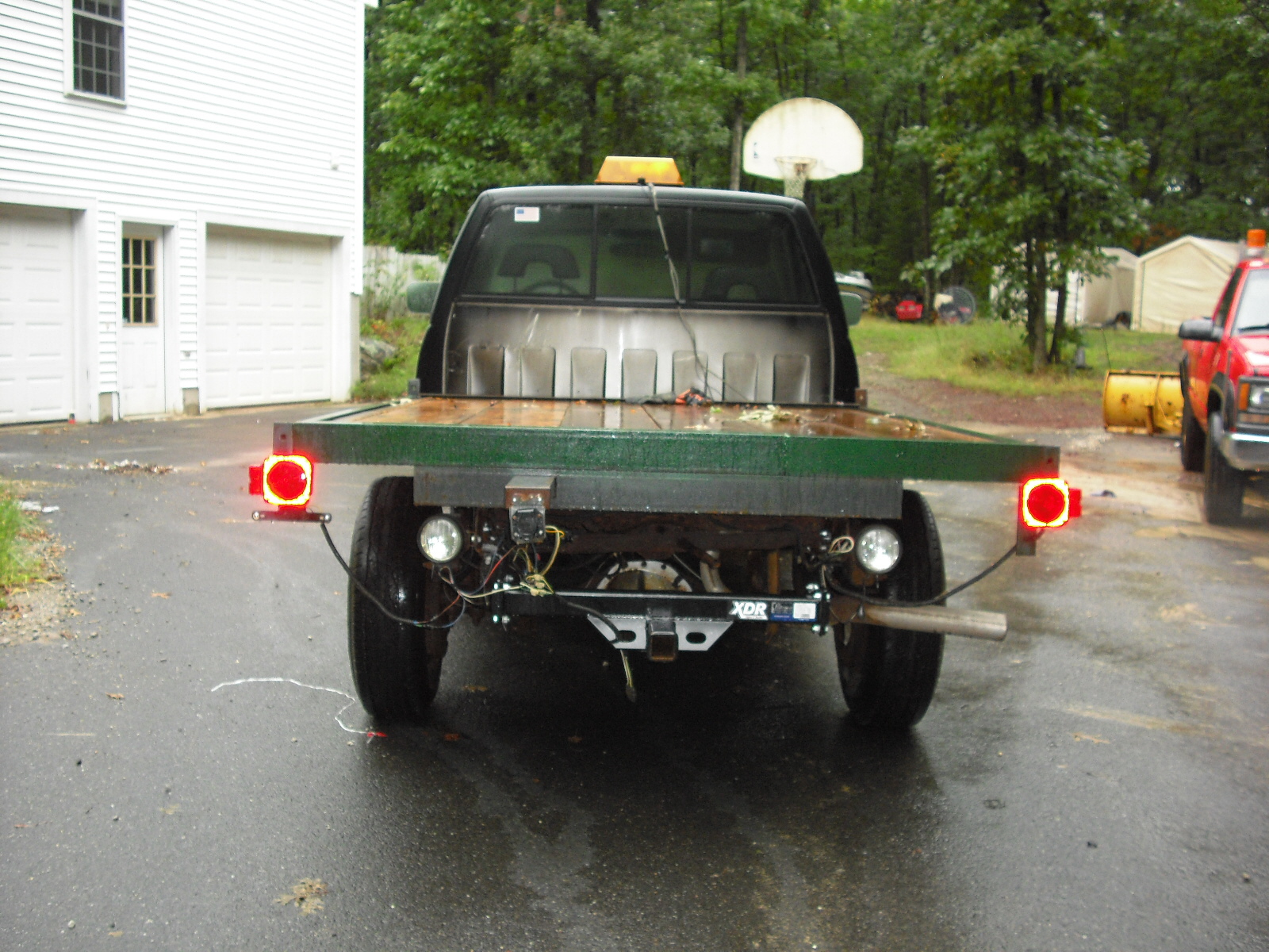

here is the f250
http://www.tractorbynet.com/forums/...94-got-new-kioti-hauler-last.html#post1523707
buying a rusty bed truck is usally short money, people are intimidated by the rust on the bed, but if the frame, gas tank mounts, spring hangers and the like are solid, then no worries, replace with flat bed and you are good.
I think a flatbed with stake sides (super easy to weld up with angle iron, one size bigger for the pockets and the smaller size for the stakes and rails) is easier to load and unload, sweep snow and off, etc.
Not to mention, pull the wood off of the flat bed and you can get to everything (brake lines, fuel tank and lines, etc.) much easier than with bed on.
I paid less than 2000 for the GMC and less than 2000 for the ford, both with plow set ups.
I put about 1500 into the GMC over the couple of years I owned it and about the same for the ford so far (new tires, new upper and lower ball joints, front axle universal joints). With the number of miles I put on my big truck (daily driver is a 2x4 2002 ford ranger) which are very little (2-5 thousand at most per year) I can not justify paying much more than I do for them. I sold my GMC for about 2000 (the frame had started to rust bad and all the fuel lines were going bad, particulalry with the frame rot I was too nervous to haul with it anymore). So once you get the first one, moving from one to the next is not a total loss and does not cost a whole lot to go onto the next. Where I live, anything that runs with a plow is worth at least something.
Another nice thing about the older trucks is the availability of parts, you can find complete parts trucks, in some cases running for 500 or so.
Joel

1*picture of the GMC.
2*picture of the trailer
1*I like the truck if only the bed would dump.
How hard would it be to convert it to dump?
2*Nice trailer but I only need a 2 axle.
I think a 16 or 18 foot tilt bed deck over or between the wheels bed trailer would be about rite for my needs.
How hard would it be to convert a manual tilt to a
hydraulic tilt?
Thanks for the post & pictures: It's been very helpful.
