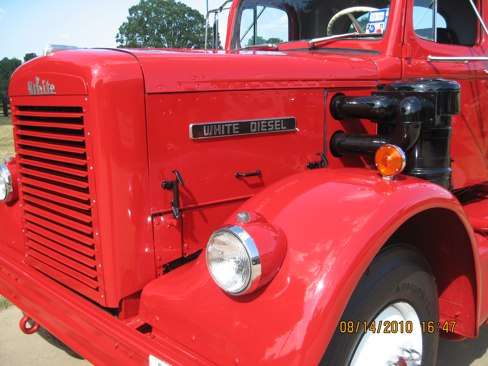

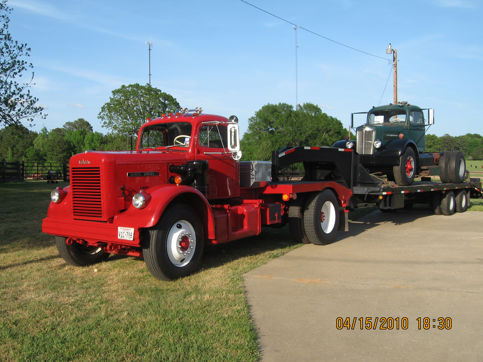

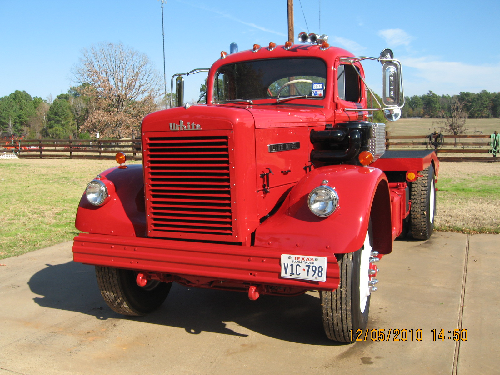

If you're going to pull a heavy load, do it the White way. As most everyone has said, you need to look beyond a pickup. A Ford F-450 pickup is rated at 33,000# GVWR but it won't be enough truck for your weights. You're in the International 4900, Ford F-650, Chevrolet 6500 territory. Lots of used beverage trucks equipped with air brakes and fifth wheels. If you bought a truck with air brakes you can use an air/electric brake controller for use with trailers with electric brakes.
