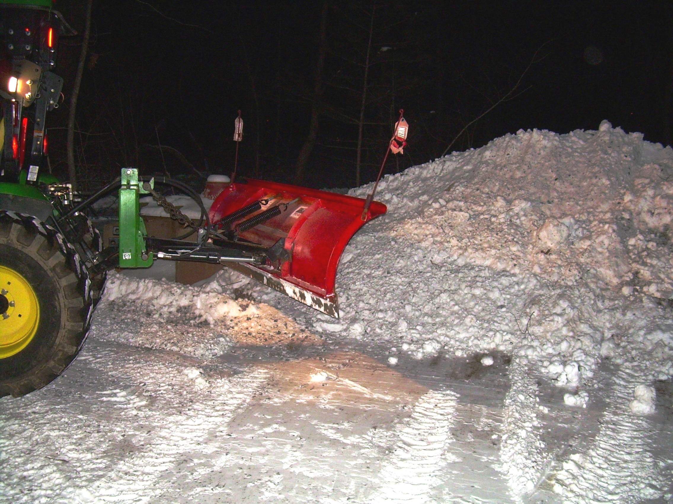

I have been looking at doing a similar thing. I have a 7' fisher minute mount on a pickup. I would like to do a quick attach plate with minute mount hooks and run wireing so that I can use the plow on either the truck or the tractor. I like the truck when the wind and snow is blowing and its 3:00 AM. I like the tractor when I am pushing the banks back and stacking it.

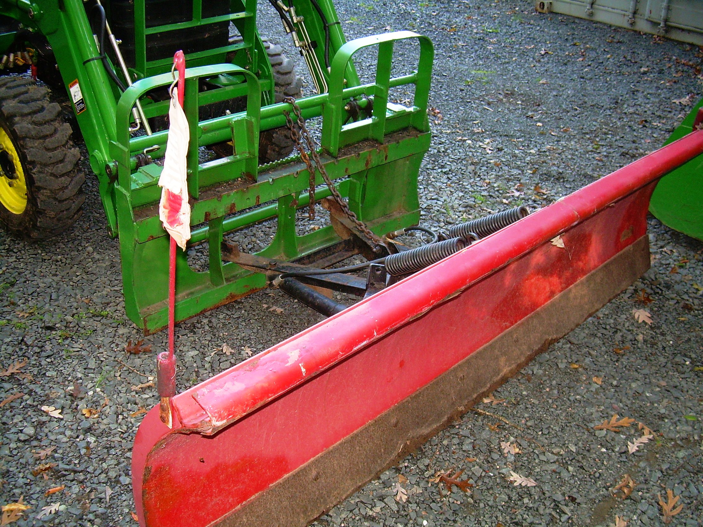

I cut a 7.5' down to 6.5' that I rigged to my 3pt, works great having a power angle plow and a loader on at the same time. I might still mount this plow to my fork carrier frame to try it out front, but I will mount it as far back as possible.

I currently have a Challenger 265B with a Q/A FEL. My father and I built a adapter "plate" to mount to the quick attach system of the 255 which offered the use of forks we made and a truck plow. We cut the parts off which allowed for the quick attach to the 255 and welded a skids teer Q/A plate to the rear of the unit. Now it works on the 265B.
The plow is an old Fisher plow about 8' from a pickup truck. I have hydraulics running to the FEL to control the angle (I also use these for the Milonzi grapple). The adapater plate is generally shaped as a triangle. The frame material is 2" receiver tube. There are two forward facing 2" receiver tubes which allow for hitch type implements such as the forks or a trailer ball. On the bottom cross member we have two 1/2" steel plates welded in place which surround the back of the plow and a pin is used to hold it in place. The top 2" receiver tube has a hook welded to it and this is where the chain of the plow is held in place. I have a few degrees of motion available with the plow and the normal movement by the FEL. When I have heavy snow I keep the plow straight. But during clean up I can angle the blade and it works great. I don't see much side to side motion of the FEL. I can try to get some pictures of of the unit mounted. I am in the process of up grading the tractor so unless it snows I won't be mounting the plow before I trade the tractor. I will continue to use this plow on the next tractor and will definitely get pictures the next time I use it.

I wanted mine as compact as I could get it as well. Having it to long meant harder to turn around as well for me. I put it as far back as I could and still be able to get the full angle on each side. It just happened to end up right on the place where the chain used to connect to the plow so I welded it right to the skid steer plate.
The system turned out so good I'd never put the plow back on the truck. With the blower on the back it's the perfect balance. With the tractor being a HST model she's faster than the truck. I don't have the tires filled and the other day I was out plowing and didn't even have the tractor in 4X4. I'm more than happy with the set up. I'm putting together a little video of some plowing I just did tonight. I'll post on here in about 30 minutes.
