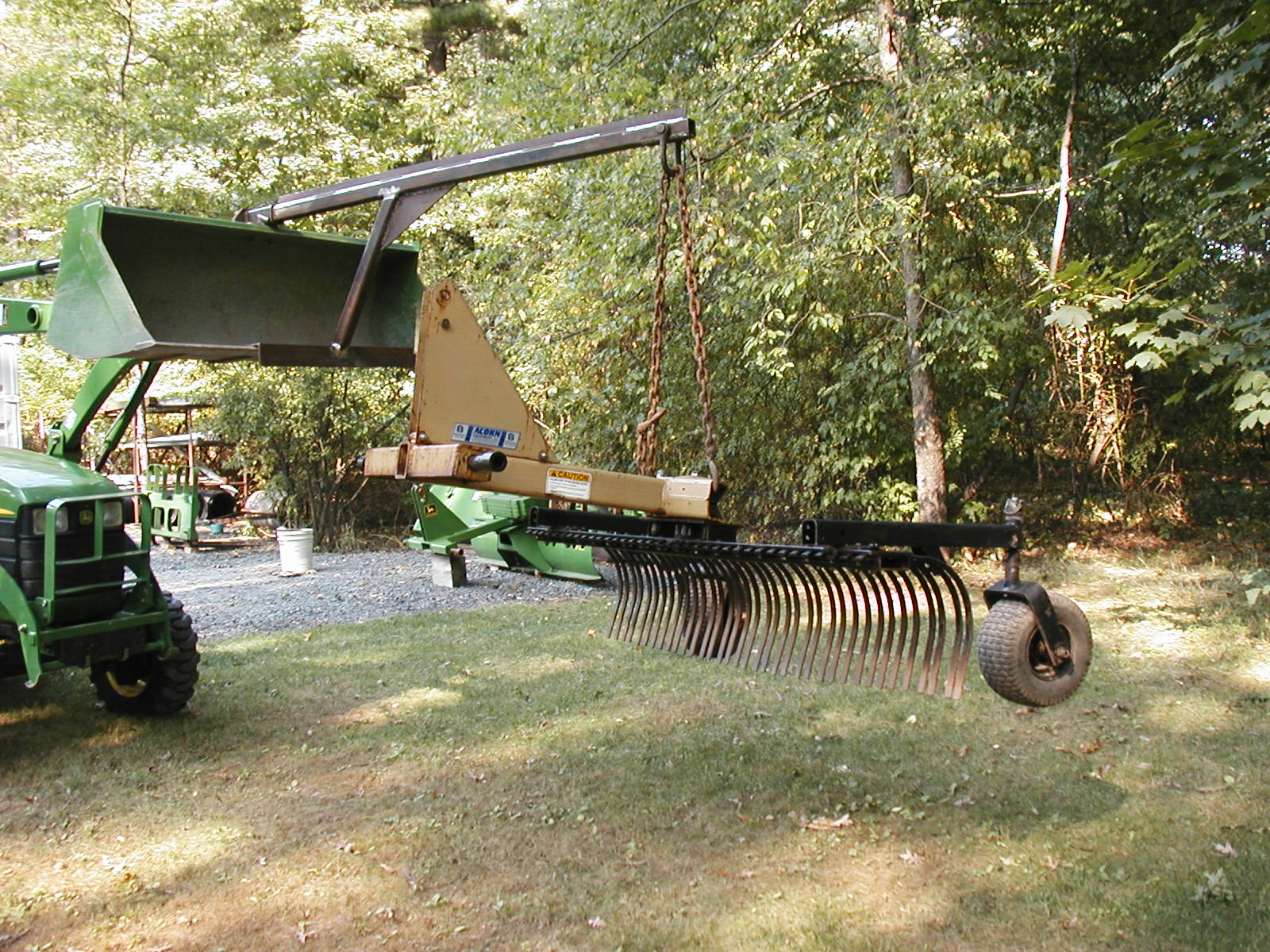

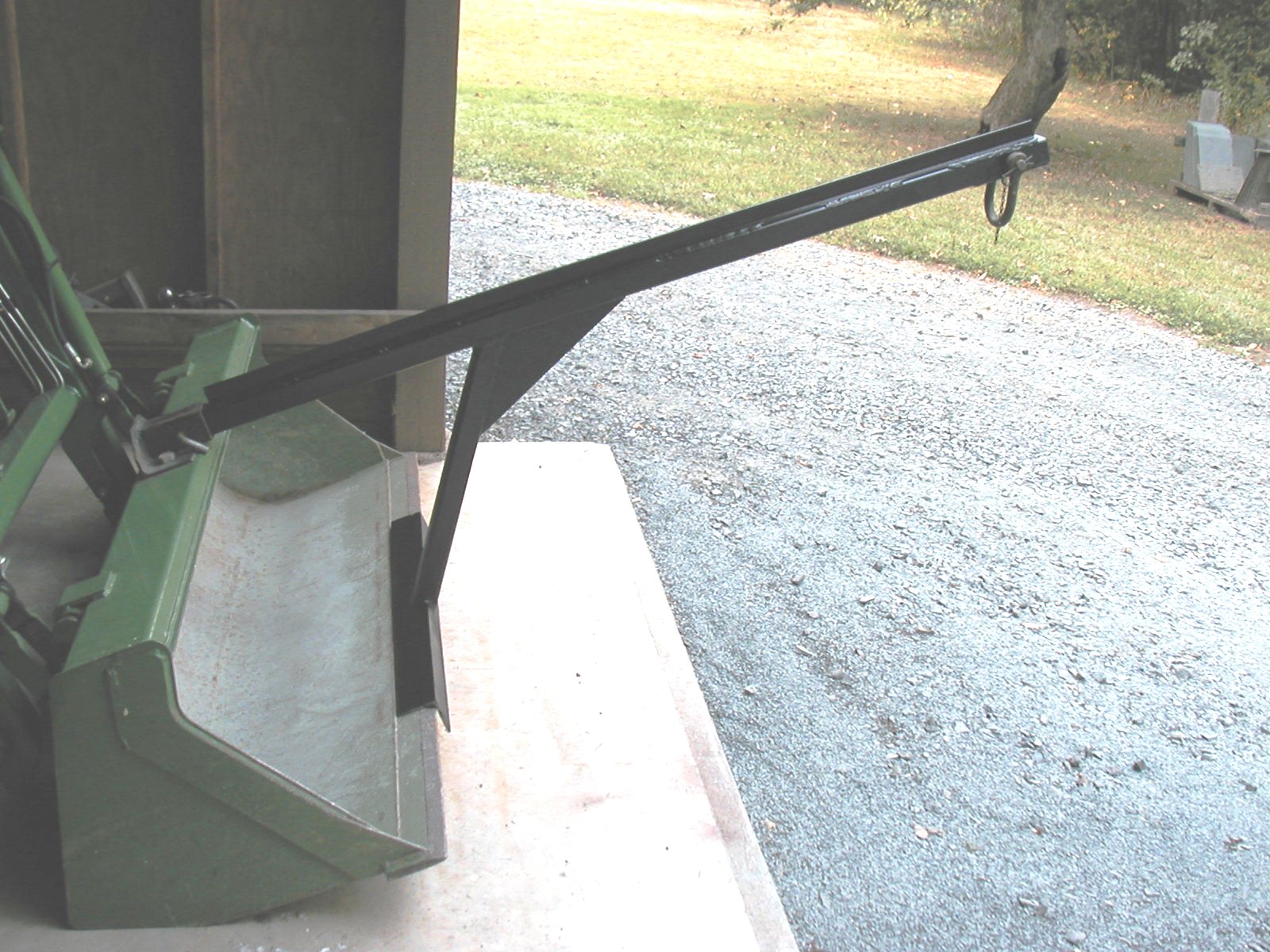

Now with that receiver and your plow tabs you can easily make a boom pole out of 2"x2" stock, inserted into the receiver and "A" shaped bracing down to the plow tabs. could even utilize the hook an run a chain over the top of the pole so many feet out, for added support. You could probably make a 6, 8, maybe 10 foot pole with a set up like that.
You could come up with all kinds of mods for that plate now that you have 3 connection points.
Just an idea,
here's a picture of mine utilizing the receiver and bucket edge, yours would be better with the double "A" bracing and a dedicated plate.
As far as the plow cylinders, I did drain mine and was surprised how little was in there, doubt it could do any harm but easy to do so not worth risking it.
Good luck, JB.

Thanks. Yes, the boom pole is a great idea. There's a pole barn in my future, so a pole will be a necessity.
Nice rake! I've been looking for a good used landpride or woods 7 or 8' like that!
