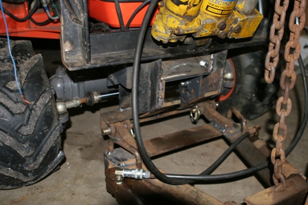

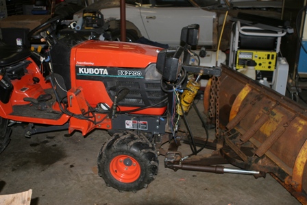

I wanted to add that a Kubota BX series can handle a truck plow. I just made a conversion. Bought a used Mejer 7.5 foot plow for $500 and modified the pick up points to fit the tractor. I thought I would have to make it shorter but the 7.5 foot is no problem. I have a BX2200. Works great. Picks up the plow with no problem and pushes the snow. I have a rear plow for weight and back-up. We just got several inches and I plowed the driveway in no time. Made it so I can take it off with the standard pins. The hitch is bolted on the front and bottom. 6 bolts total. I plan to paint it all in the spring Kubota orange.
