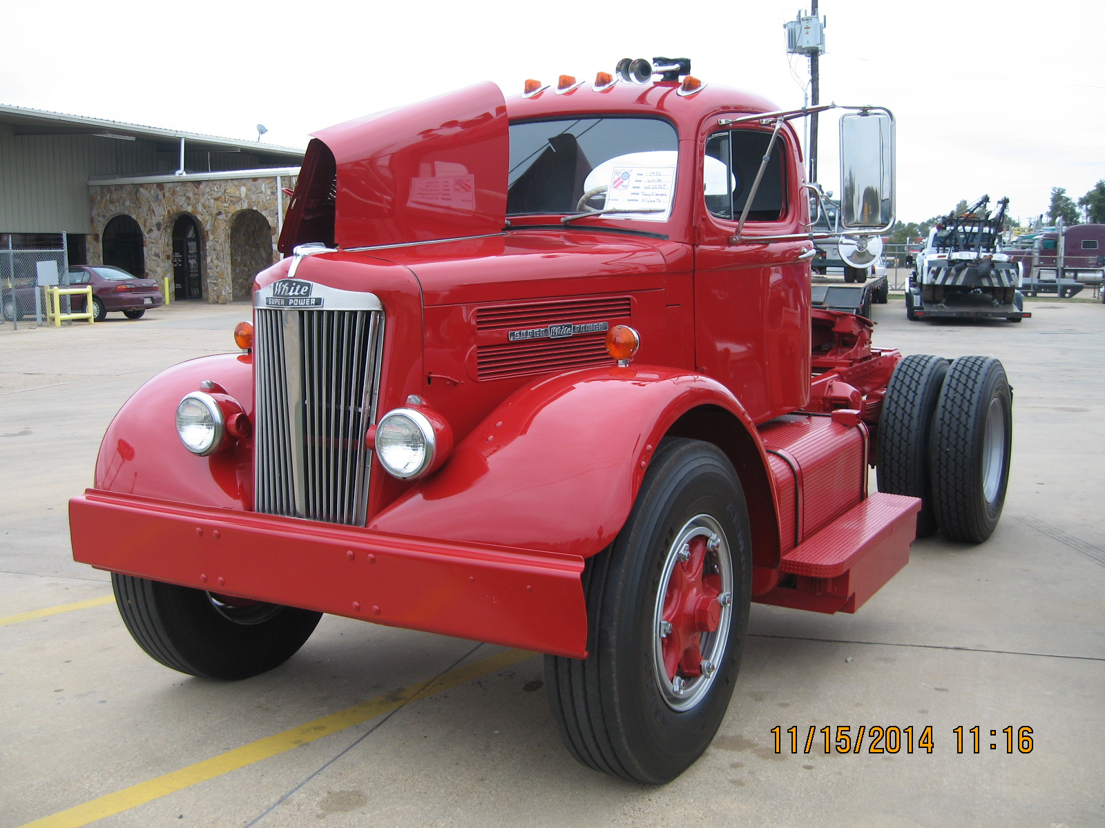

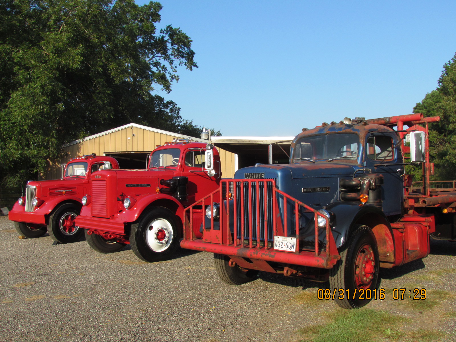

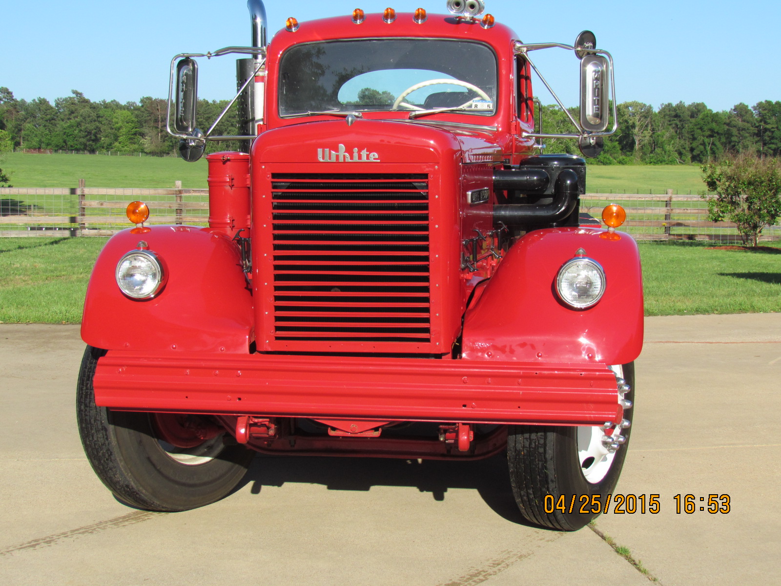

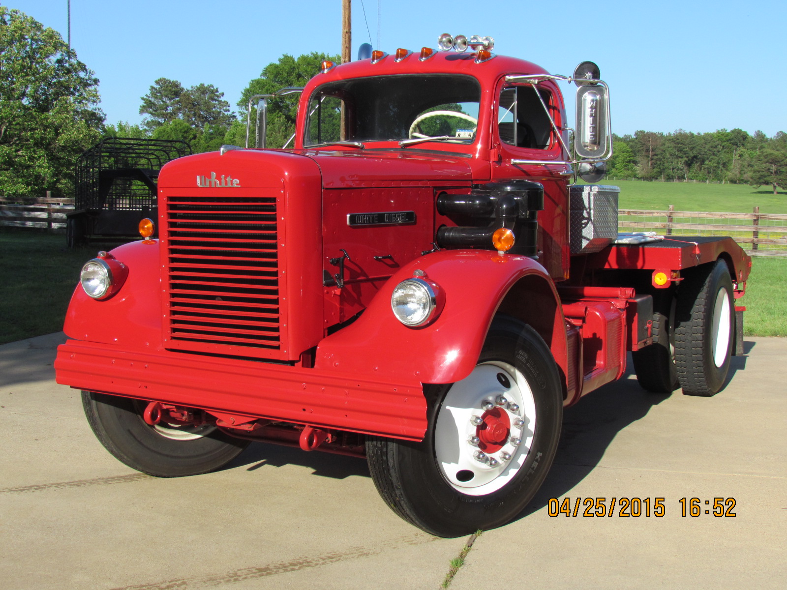

Thanks for the compliments Tug! I have to give most of the credit to the bodyshop. I don't have the equipment to do the job they did.
The '57 is a WC 22 PLT. It originally was a tractor like the '59 4400 TD but the fifth wheel has been removed. I'll probably install a flatbed on it in the future.
The '59 4400 TD is the same size as the WC 28 but a newer, updated model.
White introduced the WA models in the early '40's. The cabs were wood framed with steel skin. The WB models came out in the late '40's and were framed with wood like the WA models. The WB's can be distinguished from the WA from the raised cover over the cowl vent.
The WC models came out in the early '50's. They were all steel cabs. The easy way to tell the WC models is that they have vent windows in the doors. The WC cab was used on White trucks until about '66. These narrow cabs were also called a Coupe Cab. White also used a wider cab on some models that was designed by Autocar.

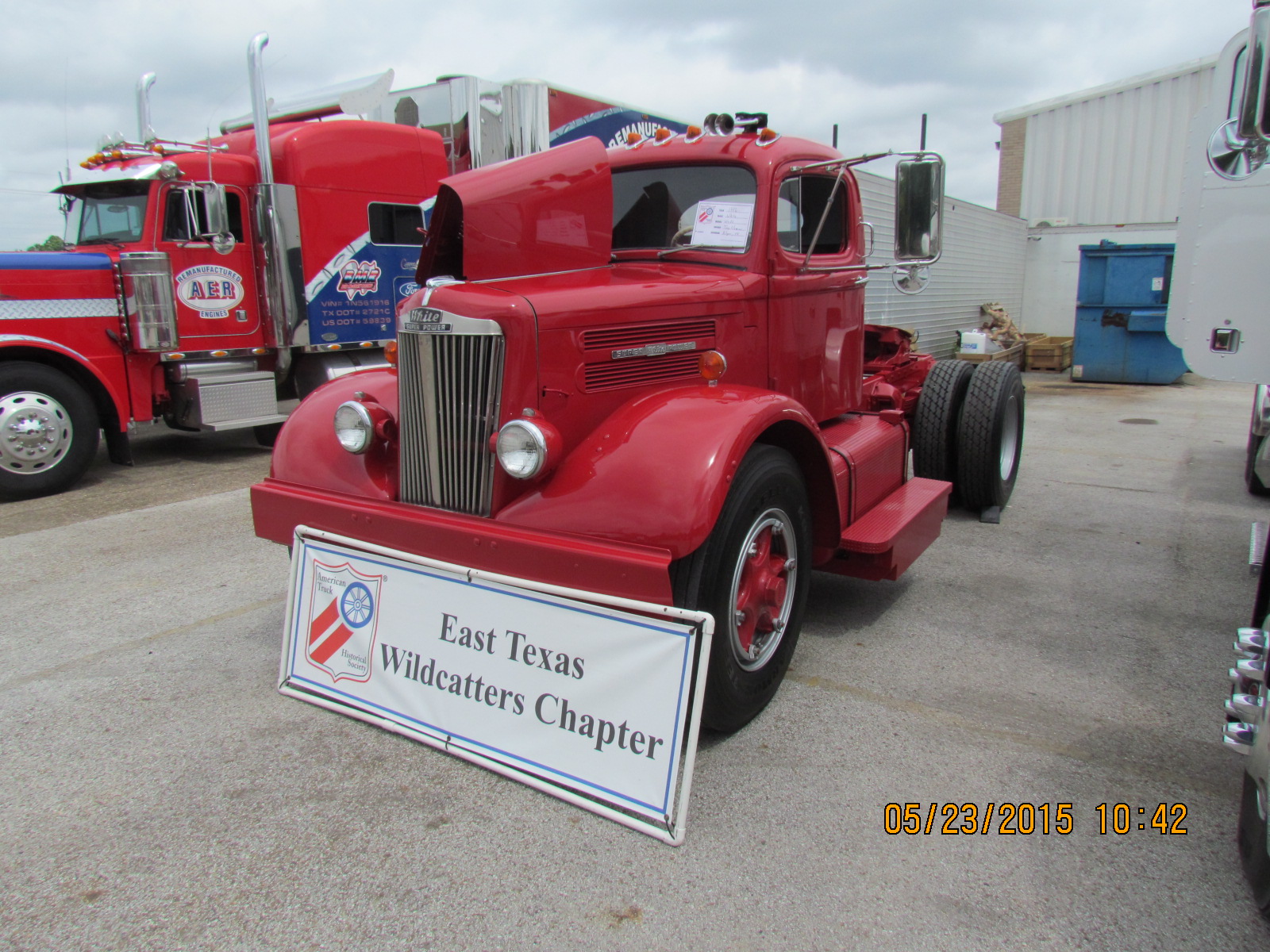

I've taken both trucks to several antique tractor shows and I'm always surprised how much interest people have in them. All you have to do is crank one up and it draws people like a magnet.
