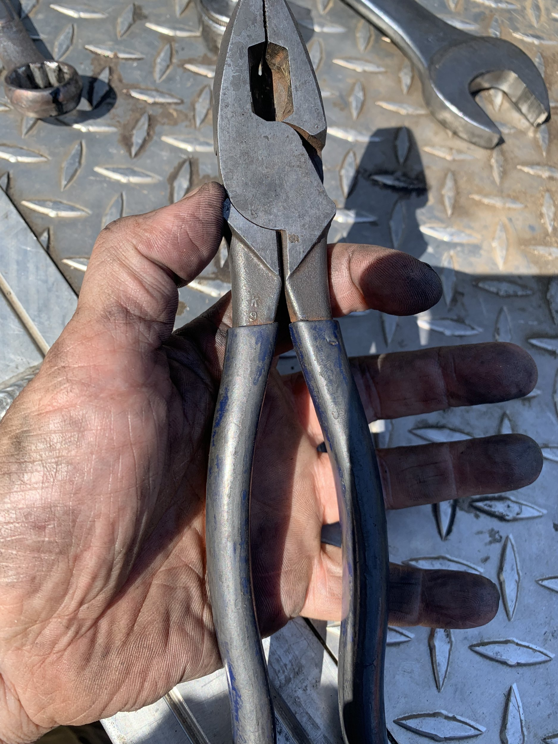

This question is for anyone with a truck & mobile toolbox in a truck with sliding drawers. Like your typical craftsman black painted toolbox with sliding drawers your wrenches & sockets.
I have a Craftsman cheapo 3 drawer with many hand tools floating around inside used daily for field & equipment repairs. As the truck moves, the tools get jostled & slide around. After a week or so, some my wrenches & sockets are covered in what looks like black grease, despite cleaning all my tools pretty well before they go back in. What looks like black “grease” is just the black paint coming off the insides of the drawers and getting on my tools. I’d like to be perfectly organized, but the stress and repetitive nature of my work does not allow tools to be organized perfectly-not even close. Got to get the repair done and get back to work, but cant stand this paint mess.
I have tried mats on the bottom and they just wrinkle into a mess from stop & go. Its like I need a thin rigid liner for the bottoms of the drawers. Anyone find something thin that they like that can be cut & sized to fit to keep the drawer paint off my tools?
I end up with this all over my tools and hands and its a mess.

My aluminum last box I had the interior sprayed with Rhino liner. Cost me about $50. It was worth it. It basically eliminated the black dust.

When I was contracting I had a spray on lining similiar to the Rhino lining, it worked the best of anything I tried for drawer slides with tools.
I eventually went to tool buckets and tool bags for each specialty trade. That kept me from hunting for tools for specific tasks and saved a fair amount of time.

I used to cut up thin carpeting to line my work van shelving and tool boxes to eliminate that problem, works good and free.

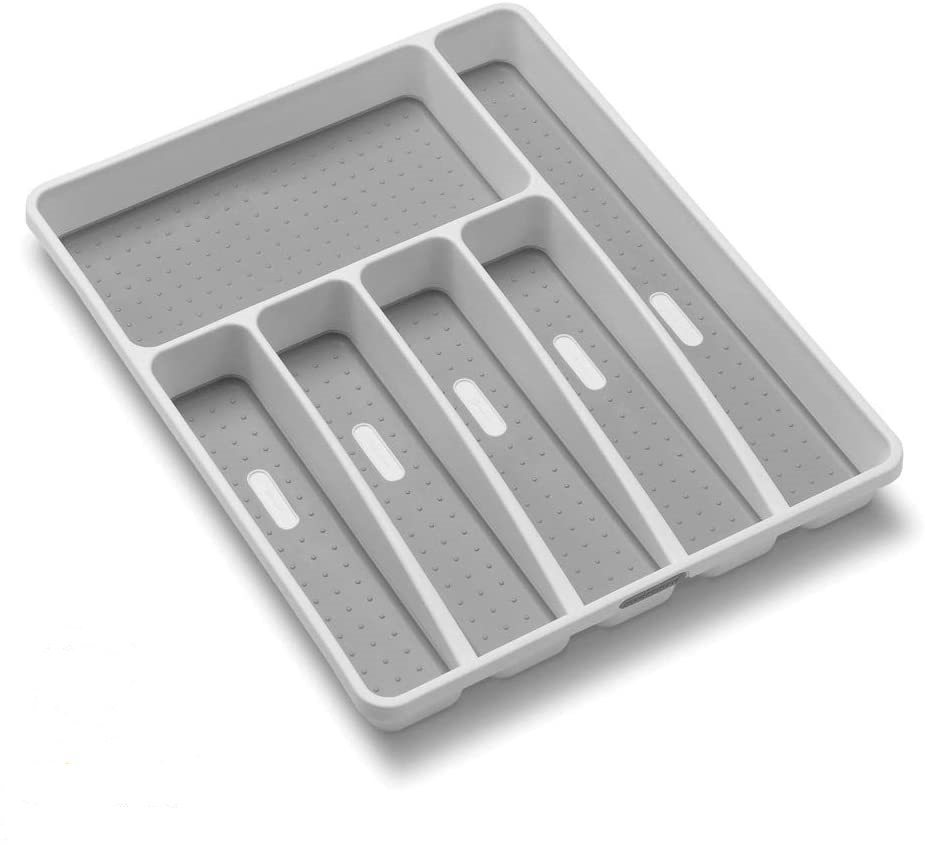

I use plastic silverware holders or wood kitchen drawer organizers in my tool box drawers:
