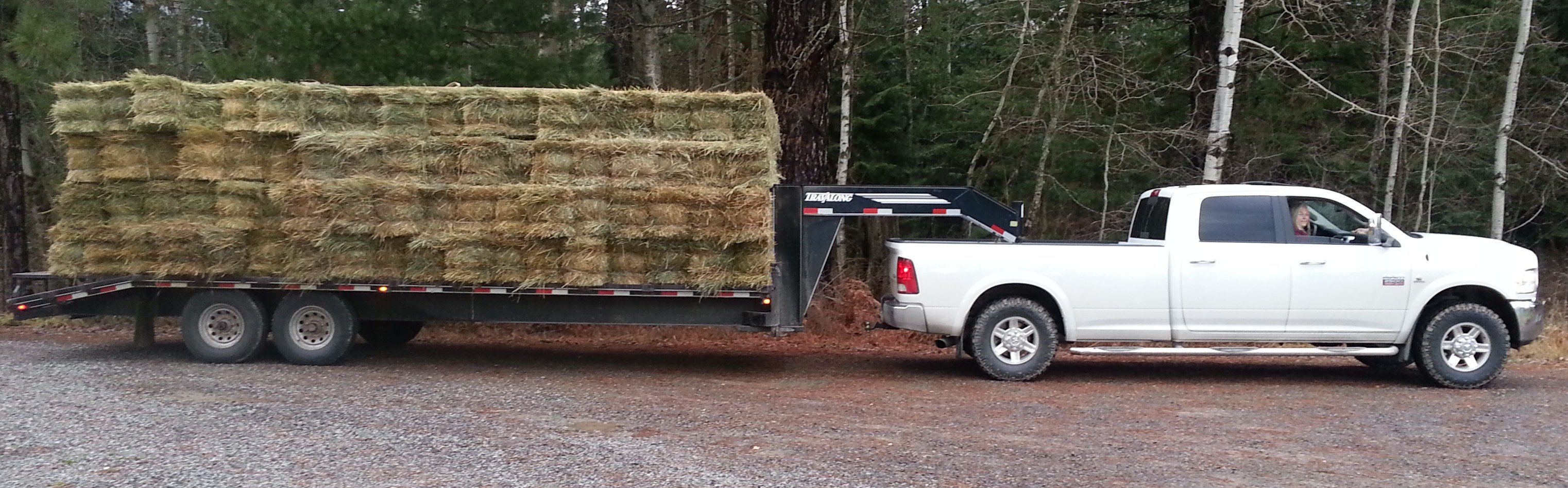

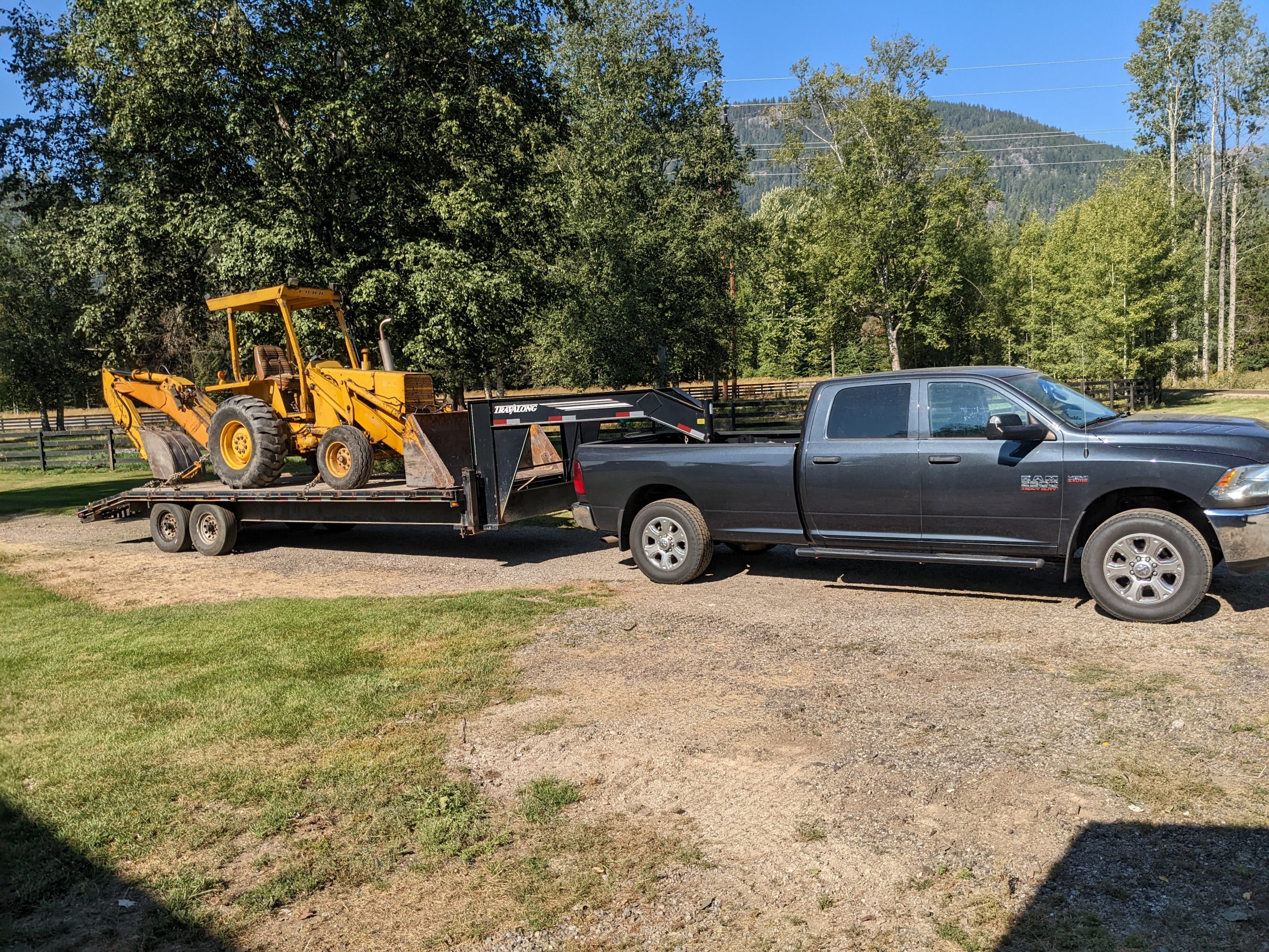

We hauled my 550 with a 2015 2500 SRW Hemi Ram.
Have a 3500 with Cummins but at the time was only set up for my 10k fifth wheel tilt utility trailer which was to narrow at 83 inches backhoe front wheels are 90"+ and not rated for over a 10K load. So not up to the backhoe job.
I thought it towed it really, really well. The gooseneck trailer has G rated tires. Thinking we were right at the 26K gross rating and registration.
We had a few hills on the drive but no real long high percentage grades. The gas truck and trailer has been used for years hauling hay every year as well.
Hay hauled every year on this trailer.
Earlier 2012 White 2500 RAM diesel (which developed transmission shifting issues forced a buy-back over the issue.)
The 2015 is also an auto and the whole truck has been solid, no problems.
Same well used trailer also hauls a T250 Bobcat.
Hay is hauled about 90 miles one way, but multiple trips.
