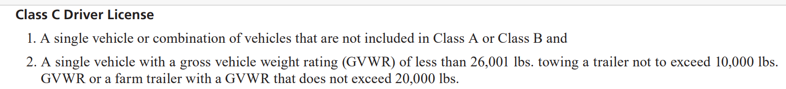

In Texas and most of the United States, the above underlined statement is not correct. I believe California and New York have such a requirement, but it is not a federal requirement and most states follow the Federal guidelines. A Medical card is likely required for commercial use, but if your GCWR is 26,000 pounds or less you do not need a CDL (with exceptions for haz-mat or >15 passengers).

I never heard of a CDL Agricultural Exemption before!!!! Thank you for bringing it up.
I did a search and found this https://www.dps.texas.gov/InternetForms/Forms/CVE-13.pdf
On page 5, it says this
"What is a Covered Farm Vehicle? (FMCSR 390.5)
(a) Means a straight truck or articulated vehicle:
(1) Registered in a State with a license plate or other designation issued by the State of registration that allows law enforcement officials to identify it as a farm vehicle; Note: The Texas Department of Public Safety has designated form CVE-30 as that identification. http://www.dps.texas.gov/internetforms/Forms/CVE-30.pdf
(2) Operated by the owner or operator of a farm or ranch, or an employee of family member of an owner or operator of a farm or ranch;
(3) Used to transport agricultural commodities, livestock, machinery or supplies to or from a farm or ranch; and
(4) Not used in for-hire motor carrier operations; however, for-hire motor carrier operations do not include the operation of a vehicle meeting the requirements of paragraphs (a)(1) through (3) of this definition by a tenant pursuant to a crop share farm lease agreement to transport the landlord’s portion of the crops under that agreement.
(b) Meeting the requirements of paragraphs (a)(1) through (4) of this definition:
(1) With a gross vehicle weight or gross vehicle weight rating, whichever is greater, of 26,001 pounds or less may utilize the exemptions in 390.39 anywhere in the United States; or
(2) With a gross vehicle weight or gross vehicle weight rating, whichever is greater, of more than 26,001 pounds may utilize the exemptions in 390.39 anywhere in the State of registration or across State lines within 150 air miles of the farm or ranch with respect to which the vehicle is being operated."
Then on page 6 there's this
"**CDL Exceptions
(a) Farm vehicle drivers are exempt from CDL requirements if:
(1) Used to transport their own agricultural products, farm machinery, or farm supplies to or from their farm;
(2) Used within 150 miles of the person’s farm."

Eddie,
This from the Texas DL Handbook. I am looking at a new Big Tex 22GN. I will have Big Tex show 20K on the VIN plate and title instead of 22K.
