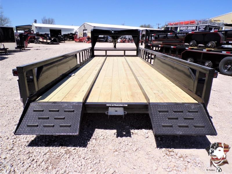

I have never used a deckover trailer, but I have to admit that I'm not excited about going up and down those ramps. My first thought was that I'd get used to it. My other concern is hauling hay with them. I'm currently using a 16 foot bumper pull trailer with rails on the sides, and I like how secure the round bales are in it. Strapping a dozen round bales onto a deckover seems like a lot of work!!!
While wasting time on Facebook the other day, I saw this trailer that caught my eye. I'm not excited about 3 axles, but for just going 62 miles each way with very few turns, I think I can live with 3 axles. I like how low it is a lot!!! At 96 inches wide, I'm wondering if I can put two round bales between the rails? It's too short to haul my tractor and batwing at the same time, but I think that making two trips would be worth the time over buying a massive deckover that could handle them. Price is also a huge bonus. I saw them going for under $10,000 brand new on another thread from another company with the same trailer. I never heard of Tiger Trailers before, and I haven't seen one in person, but I think that it's worth looking at when I'm ready to buy.

A backhoe typically won’t fit between the fenders on a equipment trailer. You don’t have a lot of choice besides a deckover.
They are tight, but alot of the midsized hoes, like ford 555, case 580, deere 310, etc are right around 81-82" wide. Dont know about the newer ones.
Usually the choice was forced because most full-sized backhoes are too much for a 14k trailer. But 8k and 10k single axle trailers seem to becoming more and more popular.
Just know that you may either need to have longer ramps specifically made, or carry around blocking to be able to load and unload.
