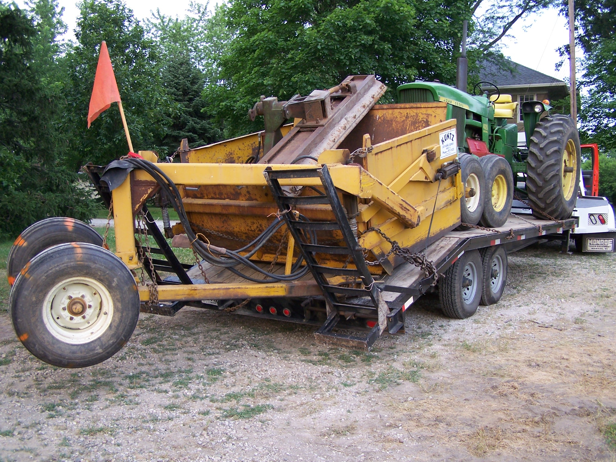

Moved 8 loads 550 mi. from IL to TN with 14K gooseneck trailer & 2003 GMC C4500 Duramax in 2007-08. Some loads (gvw) exceeded 40K, 2 loads with 20' china boxes packed full, 1 with Case 450 dozer/loader plus, longest was with '71 JD 4020 Diesel and Kuntz earthmover. No problems even coming over the mtns. on I-75. Thankful!

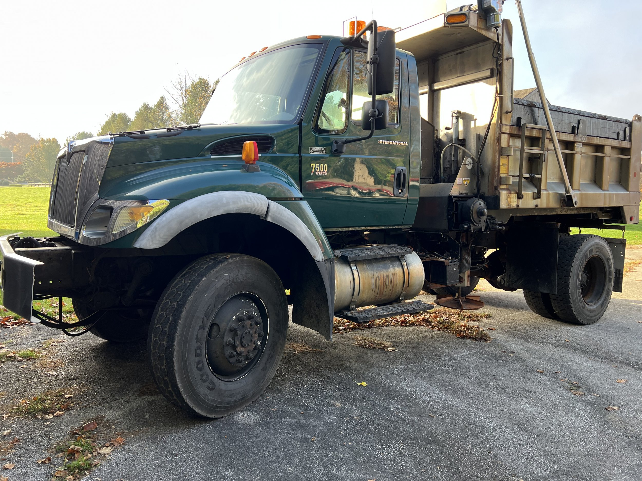

I just chased down and bought a “white rhino”. I am now restoring it from years of neglect. Still a lot cheaper than spending $150,000 on a new one.
Pre-emissions, high powered class 8 4x4 with an automatic. Rare as hen’s teeth.

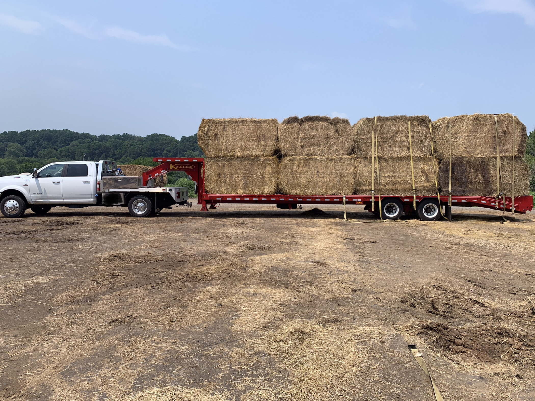

I just try not to be overweight on any single axle or exceed my registered weight limit.
This was about 47,000lbs, but no axle is exceeded. I would guess the rear truck axle is close, next would be the front axle on the trailer.
Since my trailer is 7x22 I do 3 rows of 5 3x3x8 bales. And will do 3 rows of 6 bales if it I am in a hurry. 18 bales is my limit. That puts the trailer at max. That is 3 tall since i don’t have the width.

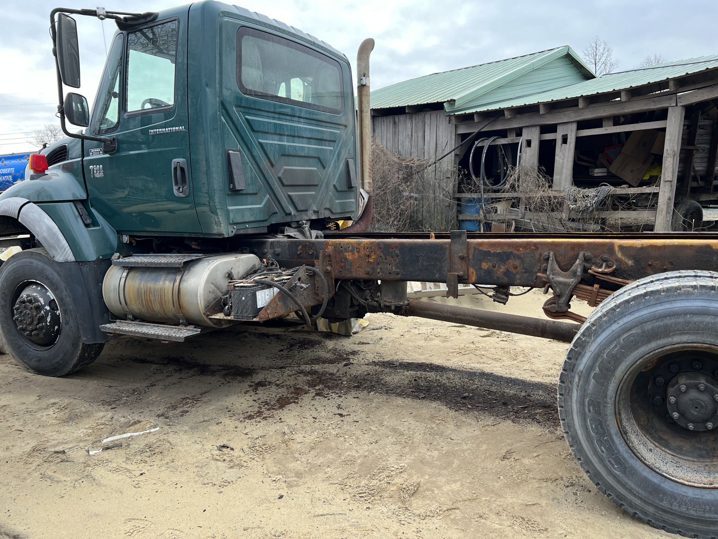

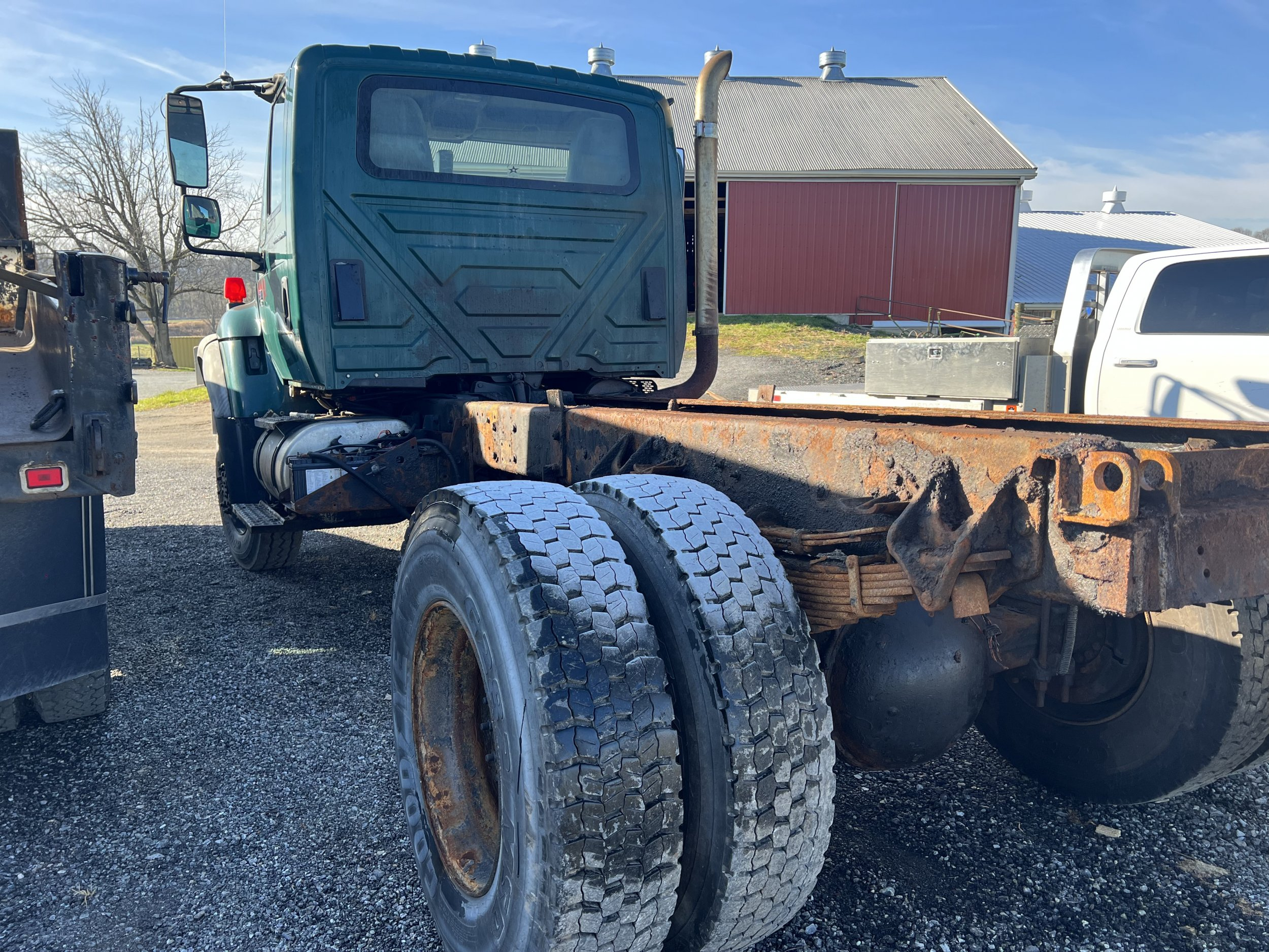

This is what it looked like when I first got it.
I removed the stainless steel bed and the entire engine driven central hydraulics system. We are now restoring it the frame from years of neglect, getting it PA inspected (new brakes, lines, etc.).
The truck is very unique in that it has a 41,780 GVWR. About as heavy as you can build a single axle. The rear axle is 30,000lbs alone. Front axle is 14,780.
I just pounded out all the rust jacking a few days ago and began sand blasting. Its a mess.
I have a long way to go, but my plan is to install a 12 or 13’ steel dump box on it and make it part of my land clearing & ditching operations and pull excavating equipment. I will also use it to haul mushroom soil to some of my fields.

Hay - so they had put a brand-new Cab on that truck, just before they sold it to you ?
JK..... but your pics well illustrate my recent post...... 5 year old cabs up here don't look that good !
Well Chased and Bought ! Why no love for the SS bed, or do you just want to sell it ?
All modern diesels have suffered, but even the International dealers up here don't want to touch a MaxxForce....
