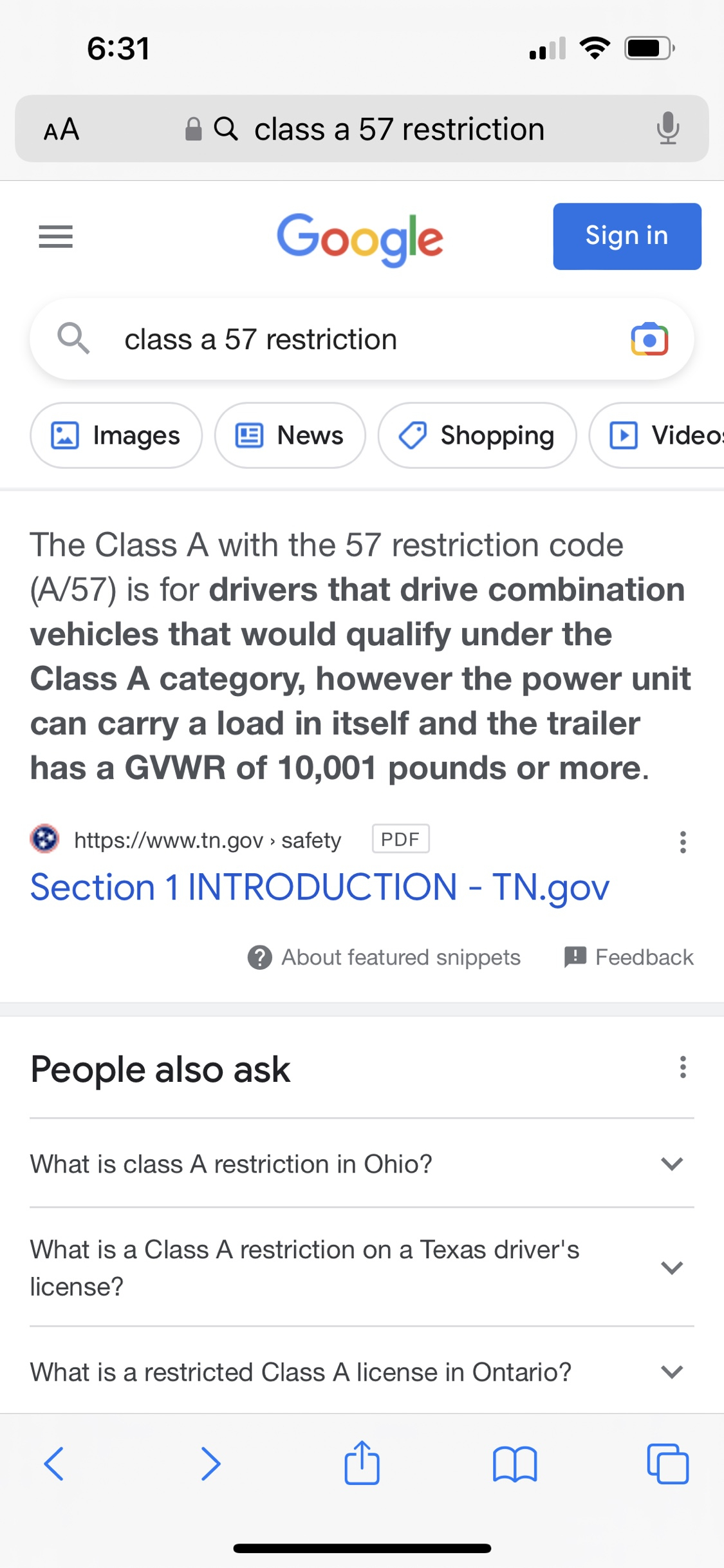

A 5th wheel restriction? Never heard of that
This is what I have. I’m surprised you didn’t get the same thing if you tested in a dump truck.
   / Truck & Trailer ideas to tow 14,000 and be under 26,000 pounds #112
My truck is 11,700 and my trailer is 18,000. 29,700 total rating…. Capacity 25,300.
Your combo is over 26K but the verifiable either by door sticker or other documents show the 25,300 so according to the IL CDL testing documents that would not meet the requirements for road testing for CDL but I guess could very by state.
