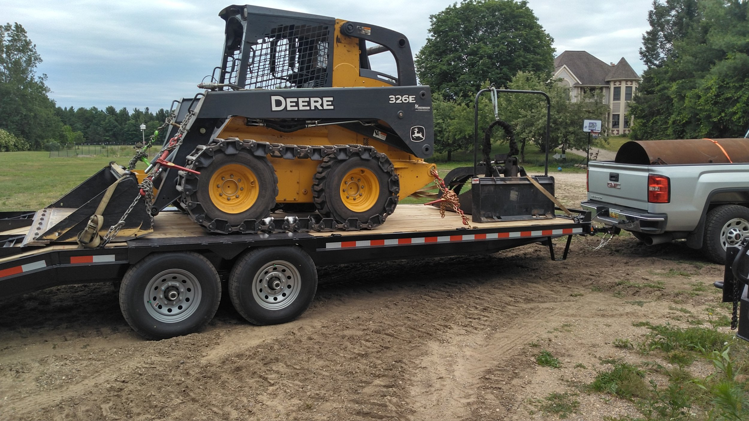

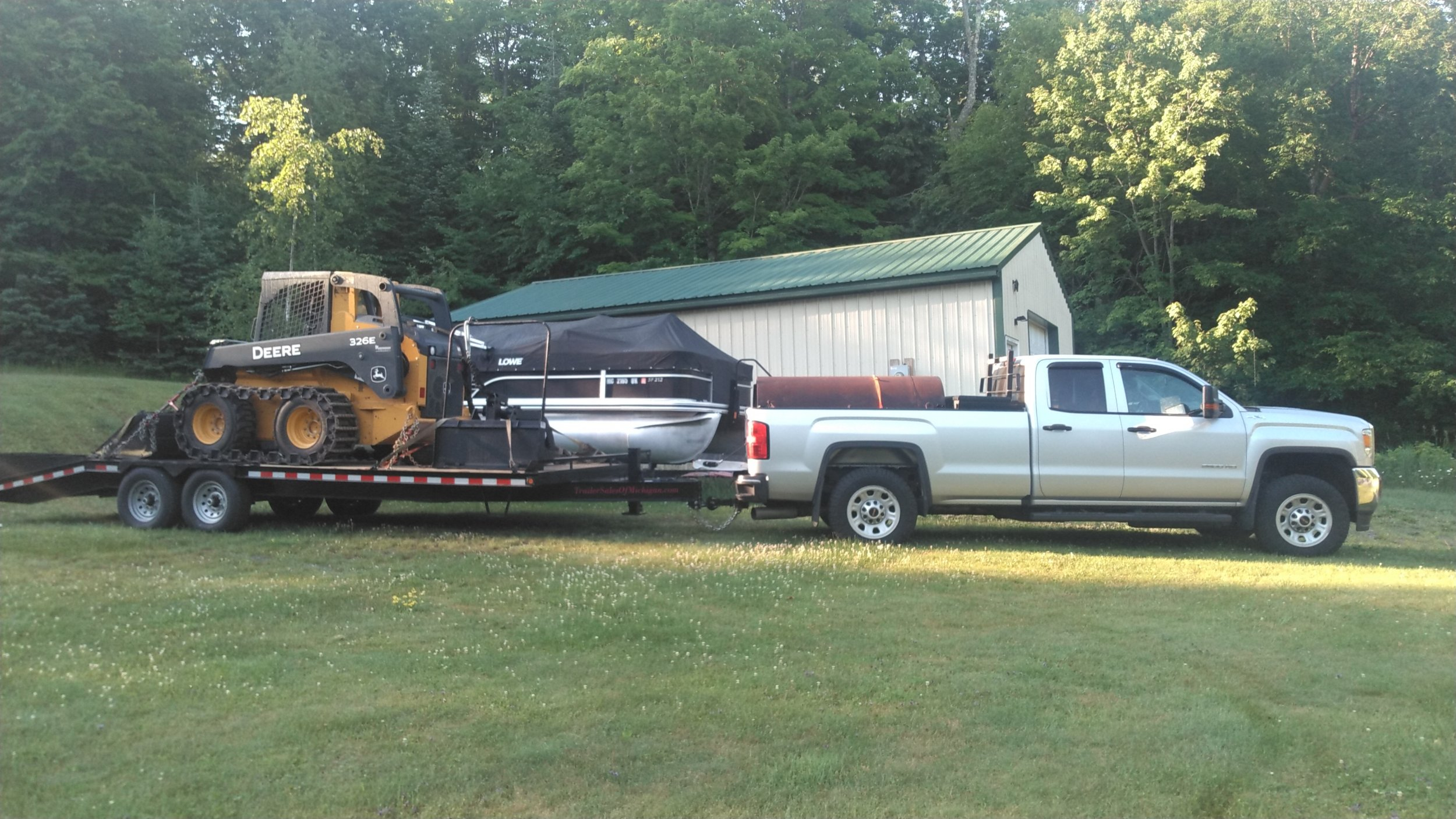

I'll probably get flack but bumper pull pintle hitch trailer rated for 17k gvwr around 5k empty, SS with steel tracks bucket 10k+, grapple stump bucket strapped on front deck of trailer 1-1.5k, old tank used for culvert + other stuff in bed 1.5k aprox. Chains, rigging + 4 binders 300+. 2016 3/4 ton Duramax with
air helpers, exhaust brake, etc, several one way 500 mile trips at 65 mph. Made it each and every time safely no break downs, no tix, no accidents. Defensive driving and common sense when towing your vehicles limits are invaluable Imho.
