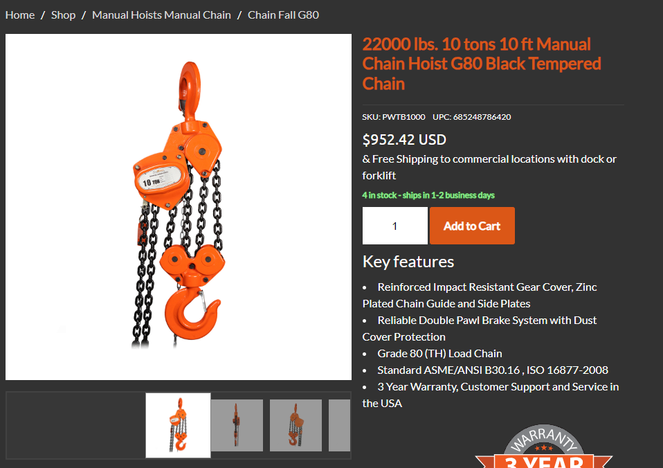

If you had ever tried to use a chain fall outdoors in the mud and grass and trash, especially trying to use it in a horizontal position, dang what a cluster **** situation that deteriorates to in a hurry.
   / Truck winches #85
It was just a joke. But i have used one to pull out a crape myrtle stump for a neighbor of my parents. Had one end on my truck in the road and the other on the stump. I pulled for a while not getting anywhere, took a short rest and saw that I had pulled my truck sideways over the curb and into the yard.... oops.

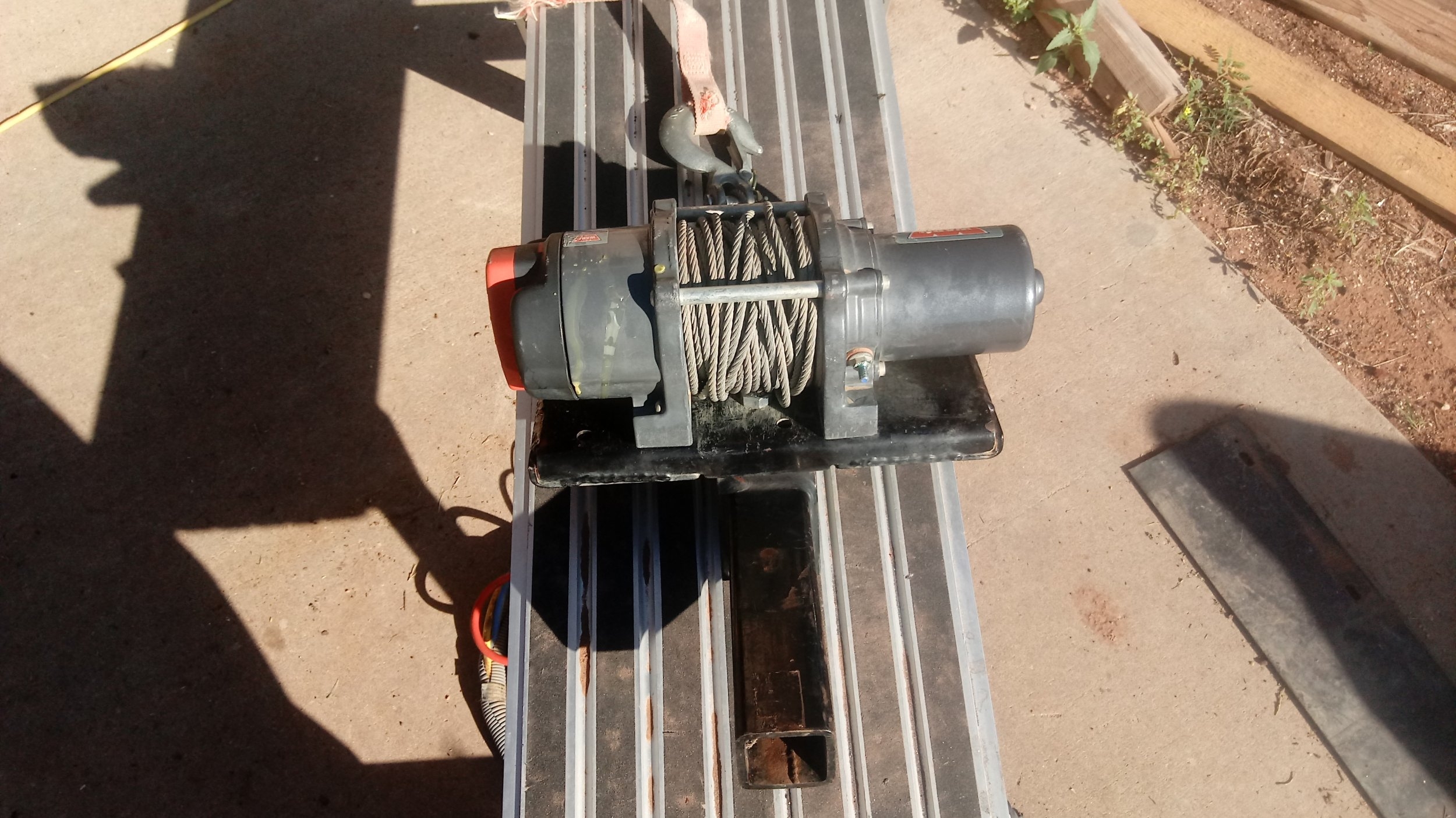

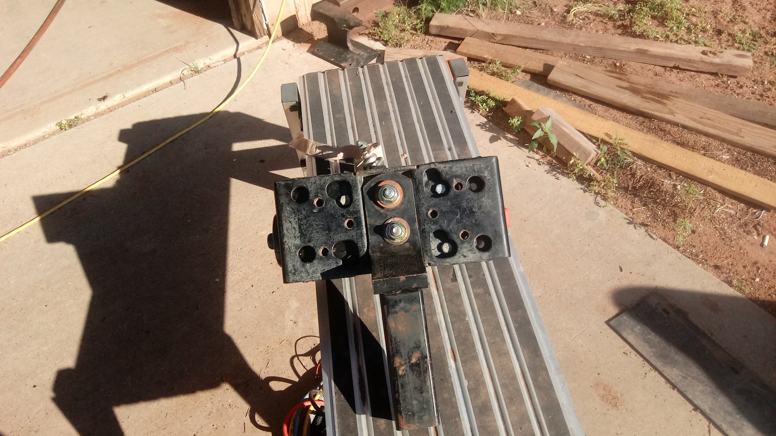

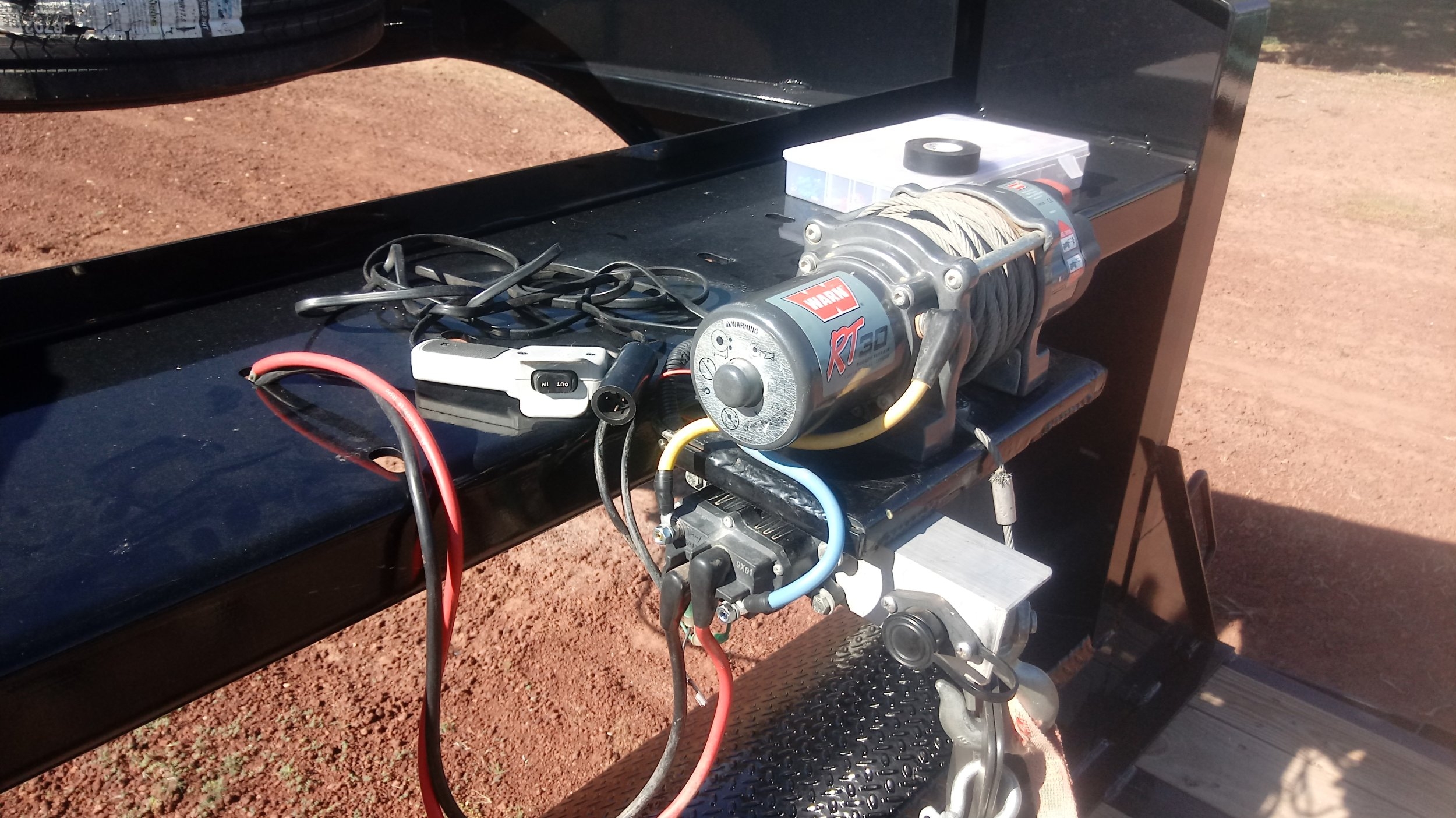

Excellent info, and I'm not arguing with any of it, except to say that I have never needed to pause to cool my electric winch. I suppose that's because it's exceedingly rare to ever even approach full capacity of the winch for any extended period of time, they're operating way below that the majority of the time.
I have my electric winch mounted to the front of a tandem-axle trailer, and use it for skidding logs onto the trailer. I usually try to get the trailer within 20 feet of the load, so I'm only pulling 20 feet + trailer length = 35 feet total, times 6 - 10 logs per trip. But sometimes obstacles dictate pulls of 100 feet or more, times 6 - 10 logs, and the winch has never been my limiting factor. Batteries are occasionally an issue, even with two big deep-cycles constantly charging from the truck, but never the winch!
