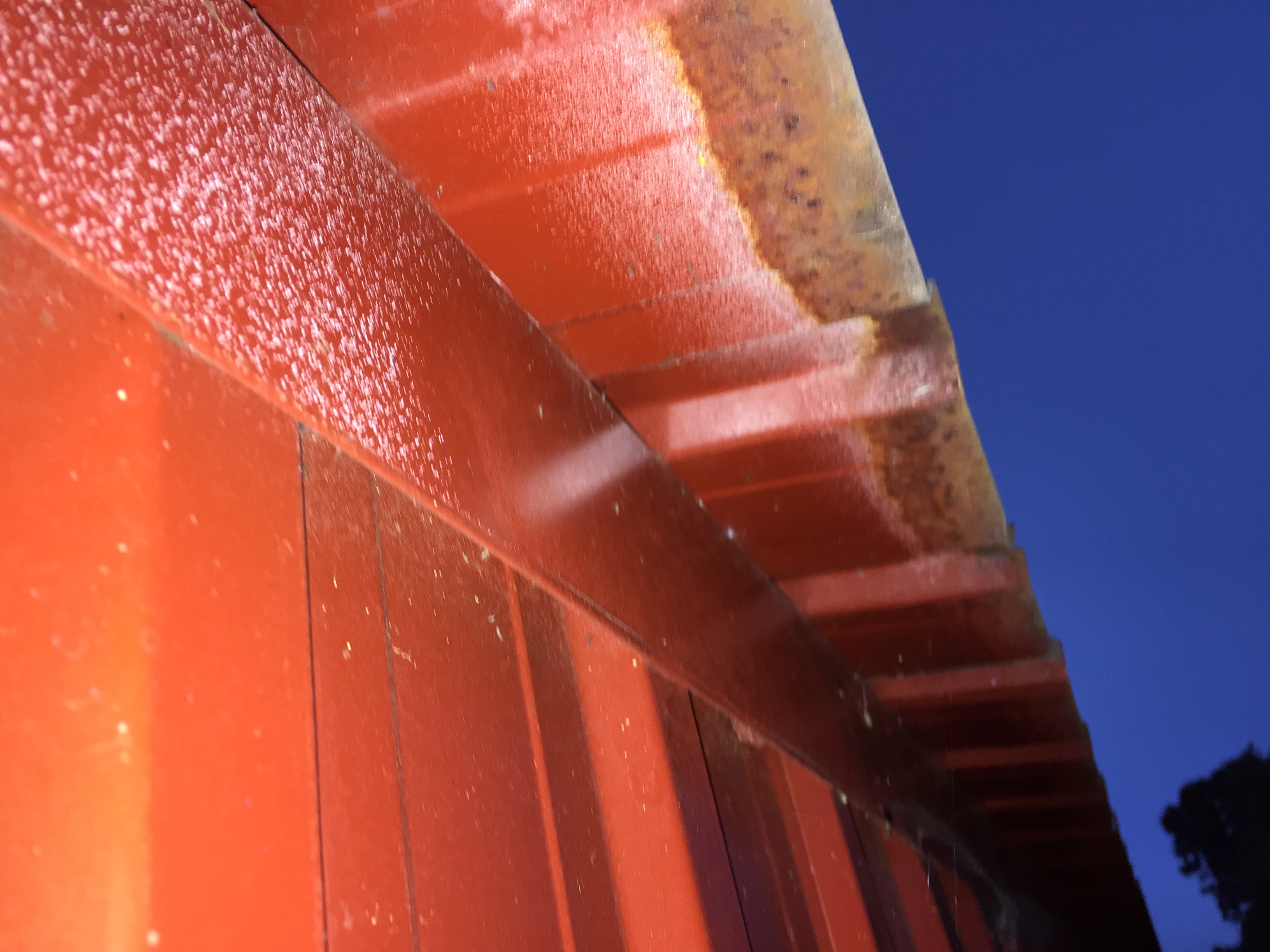

Let's say I vent from the eave, how do you keep insects, bats & small birds from making a home in the attic? I would assume there's a moulded screen that follows the contour of the metal ribs or Is there a trick to attaching screen to the underside of the roof?

ventilation - wire screen cut to oversize, press into place on top of good fresh silicon bead - that's what I would do for a shortcut. I am sure there is a product sold that does the job.
They do sell foam that matches the profile of the metal roofing that you install before you screw the roofing down to seal it.
I used this under my ridge vent on my metal roofing. Keeps the bugs and snow out. Lets air through.
GAF Cobra Exhaust Vent 1-1/2 in. x 2 ft. Mesh Roll Ridge Vent in Black-25 - The Home Depot

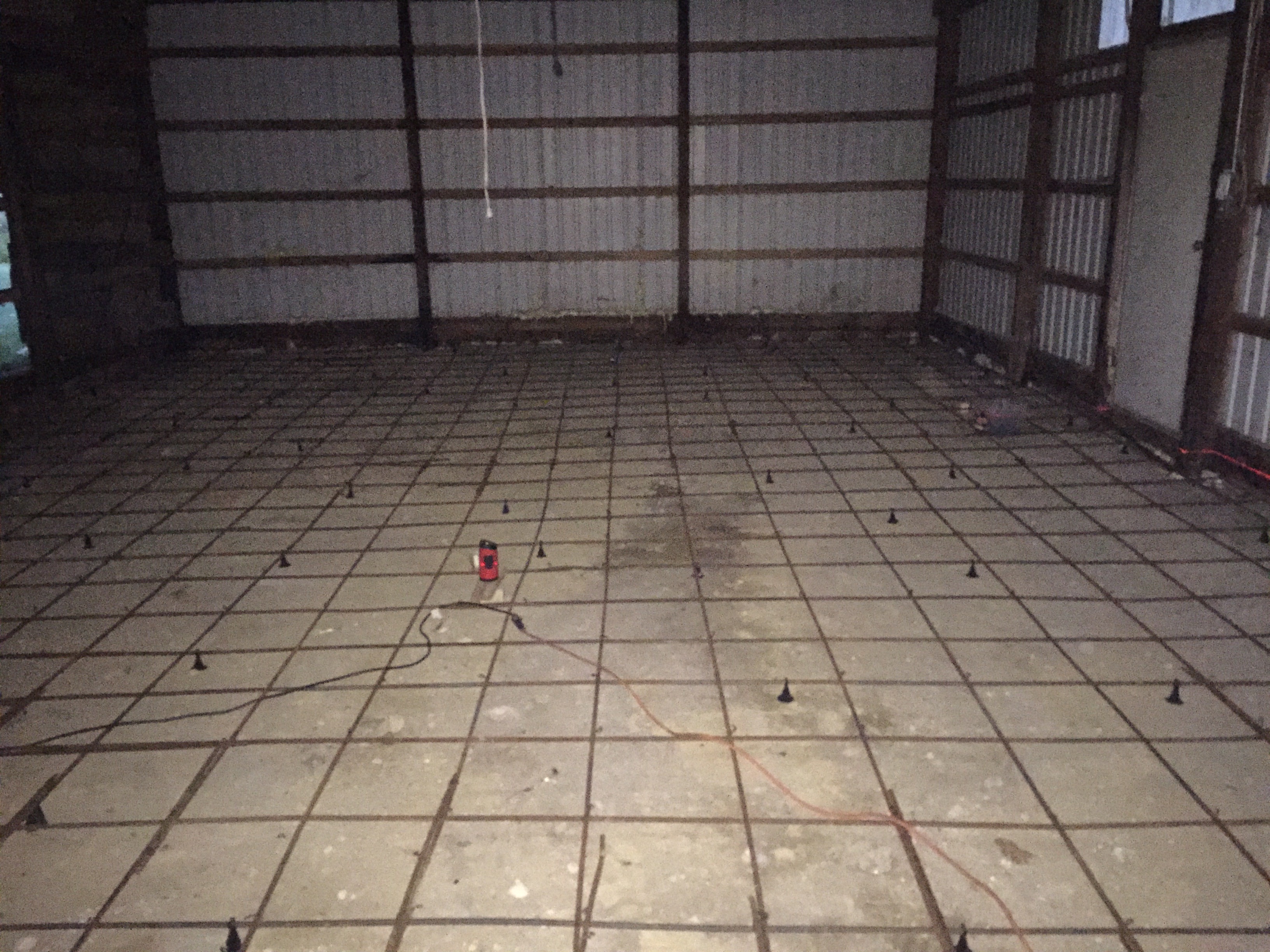

Yep, all you guys were right. I called a truss company yesterday and it's not possible to sheet and shingle this building so it's getting a new metal roof. I'd have to add more poles/trusses & increase the size of the truss carriers for shingled roof.
Next week is cement, I finished the rebar yesterday. I need 19 yards for the 6" floor. 1/2" re-bar in a 12"-14" tied grid with angle iron around the perimeter to screed from.
No measuring, I just threw the rebar down and got to work. I bought the rebar from a guy in Detroit for $500. A lot of the pieces were bent but I saved about $75 instead of buying it from Menards.
Here's a picture at the 6hr mark. I broke the rebar installation in to 3rd's. 2hrs of squatting is about all my back & knees can handle at a time. I'm keeping track of the hrs and the cost of fixing this barn up.
Rebar, angle iron, plastic stand-offs, wire ties & twist tool- $650
Cement - $2340
I'm at $3k for the 25'x40' so far.

Wow, nice work!! Are you planning to put in a 100 ton stamp press or something?? 6" with rebar should hold up to industrial abuse!! I'm planning to go 4" glass fiber reinforced, and don't expect it'll ever crack...

No 100ton press or anything like that but I've been collecting some machines for a little work shop. I have enough projects I wanna build to keep me busy for a lifetime. Why wouldn't you add the some steel, rebar is cheap? You never know what the future is going to bring. . :thumbsup:
I pour the floor Thursday.
