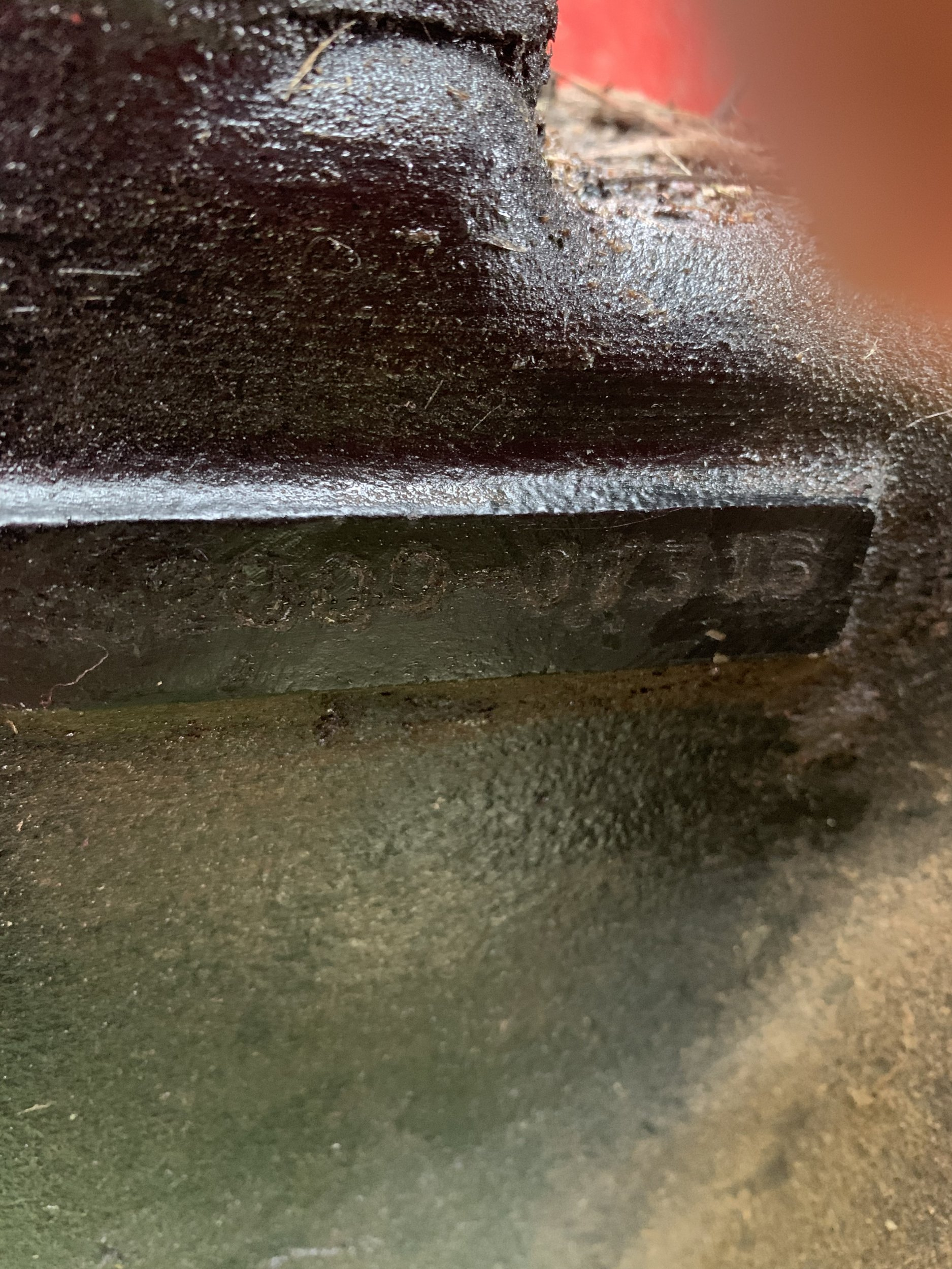

I found this stamp on side of body of tractor. Looks like it is 2000-07316. What model tractor do I have?
Yes it is 2wd and motor is a 2TR20. I am wanting to order a manual for it.

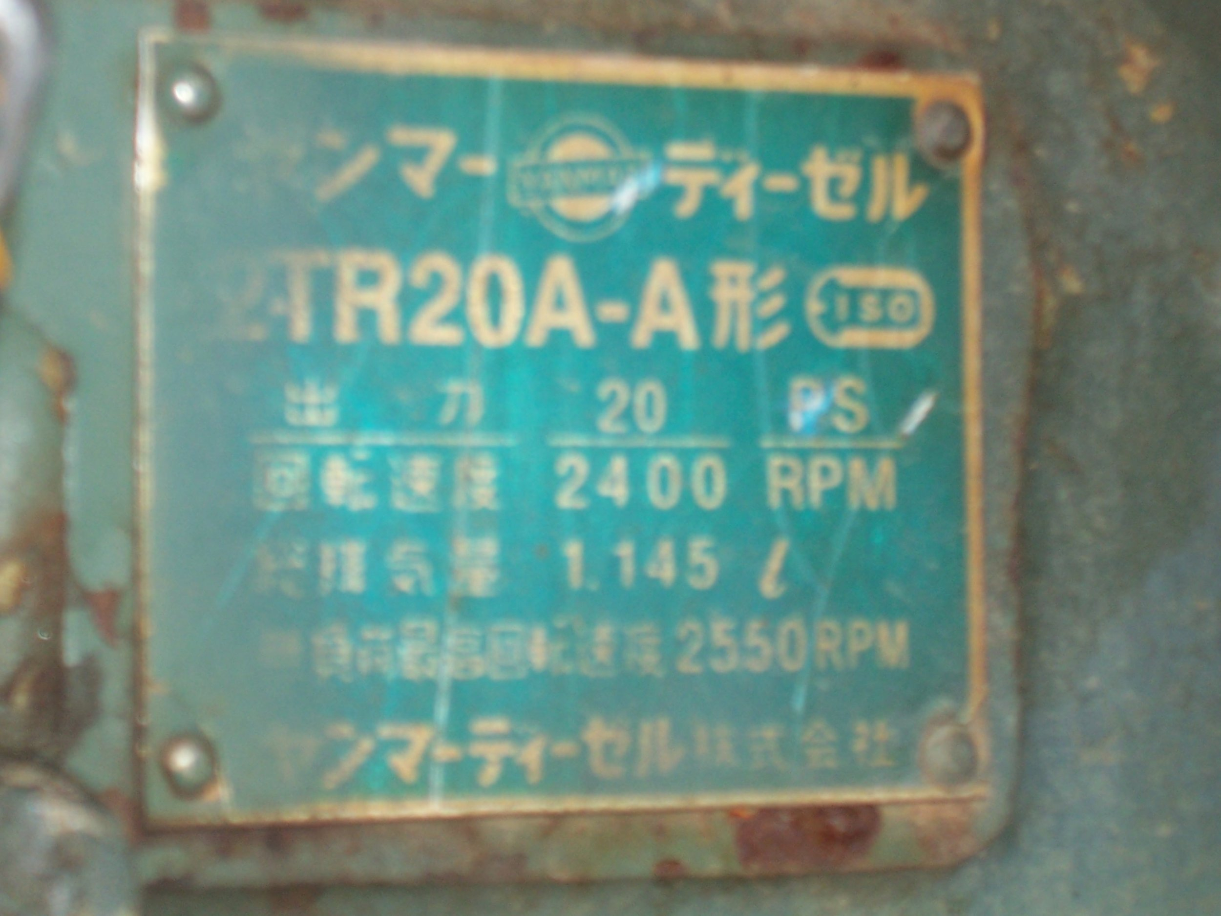

My YM2000 to the day have a answer for the A's in my Id.plate #'s.
My Eng. Id. 2TR20A-A and on my
Trans # YM2000A 15089
Have a ym2000 Manual and a 240/195 and neither has a reason for it. Or anyone for that matter

Carey, you need to go to this posting about your machine. Seriously. It is the A-A.
Even the A-A manual is there.
Their is a reason behind it all. There is a YM2000, a YM2000A, a YM2000A-A and just to mess you up there is a YM2000B !

Just show me one page that shows the meaning of the A and dash"-A" for my tractor. Of the Ser. Id.'s. 1 page out of how many manuels for a YM2000 or a YM240 can't be that hard. You can't down load a Pg. from that site?

From a manual not uploaded here. Its from the Yanmar Tractor Owners Group.
We often get people asking about the schematics and electrical, but have no idea what generation their YM1700 or YM2000 actual is.

Yanmar Factory modification. From A 20yr. UTDA Yanmar dealer. Not going to be listed which I knew that. Could just be a Customer modification. Actual Mod.?
