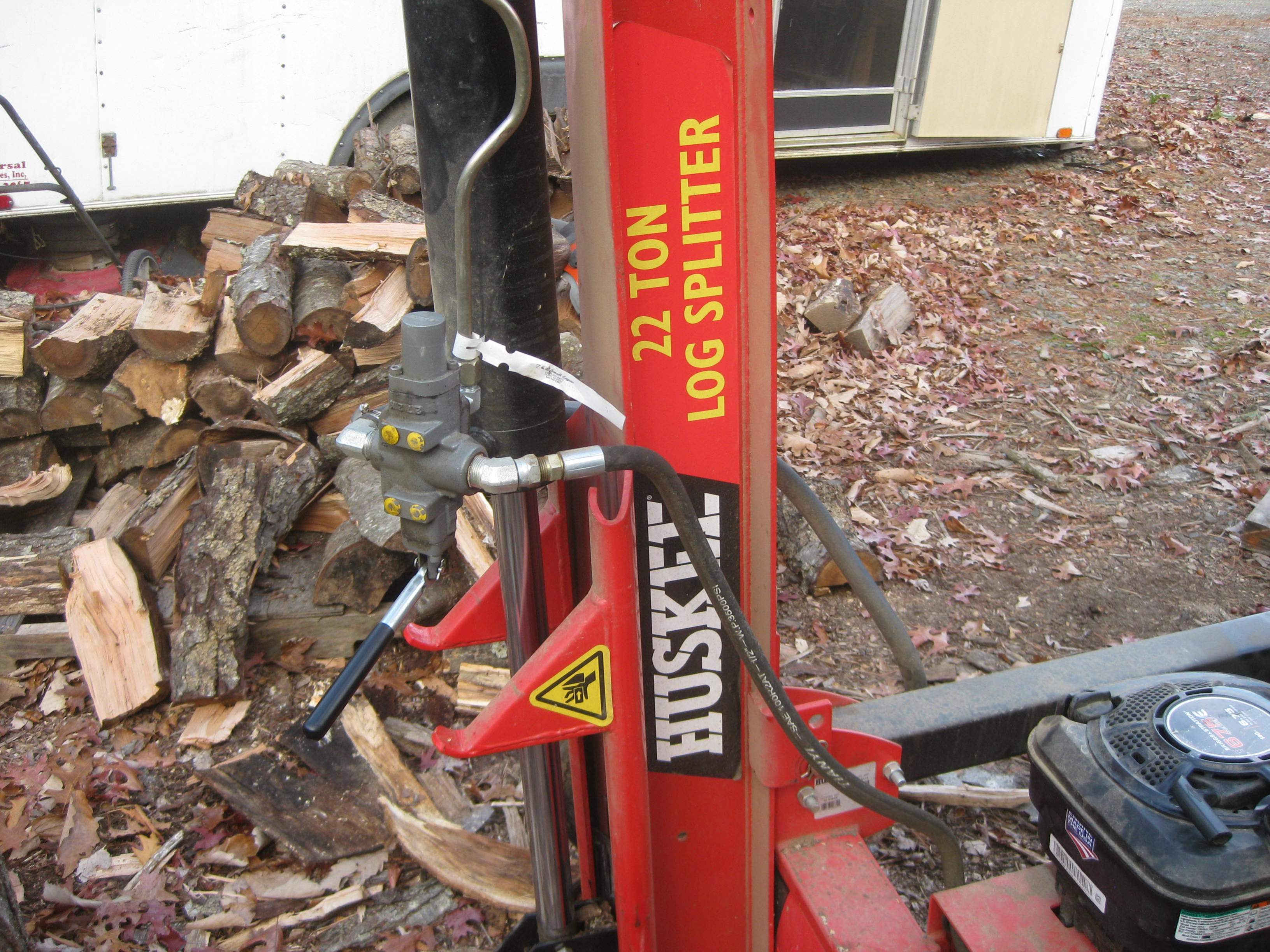

pulled my down position handle this afternoon and the wedge, wedged in a log.When I pushed the handle up nothing happened. The wedge is in the down position and will not respond to up or down handle motion, any suggestions ?

the splitter is free. it is stuck in the down position.
   / TSC 22 ton log splitter, problem #5

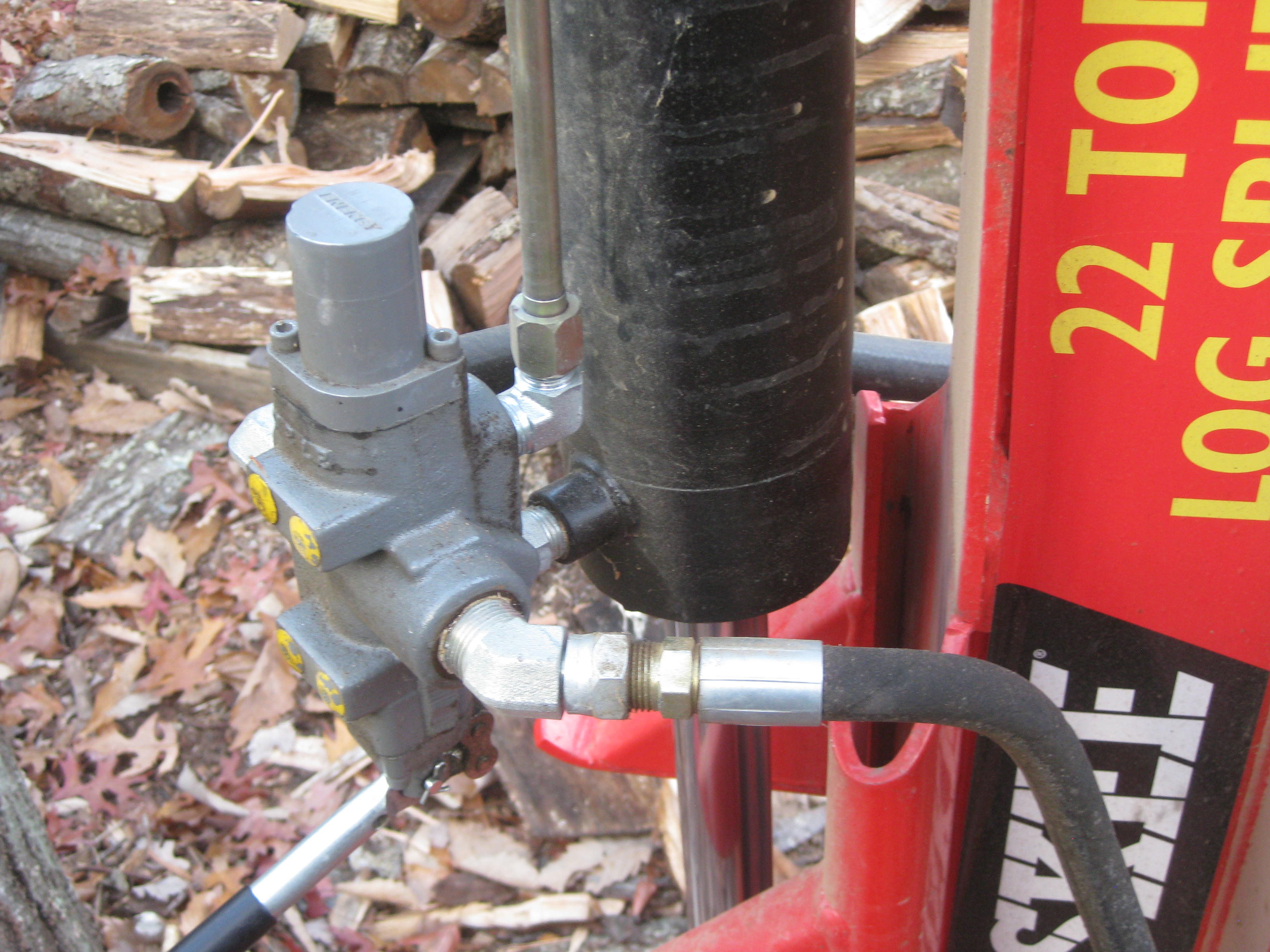

OK Try this. Its possible that your hydraulic valve is stuck. Try tapping - gently - on the valve with the handle of a screw driver. This might break it loose.

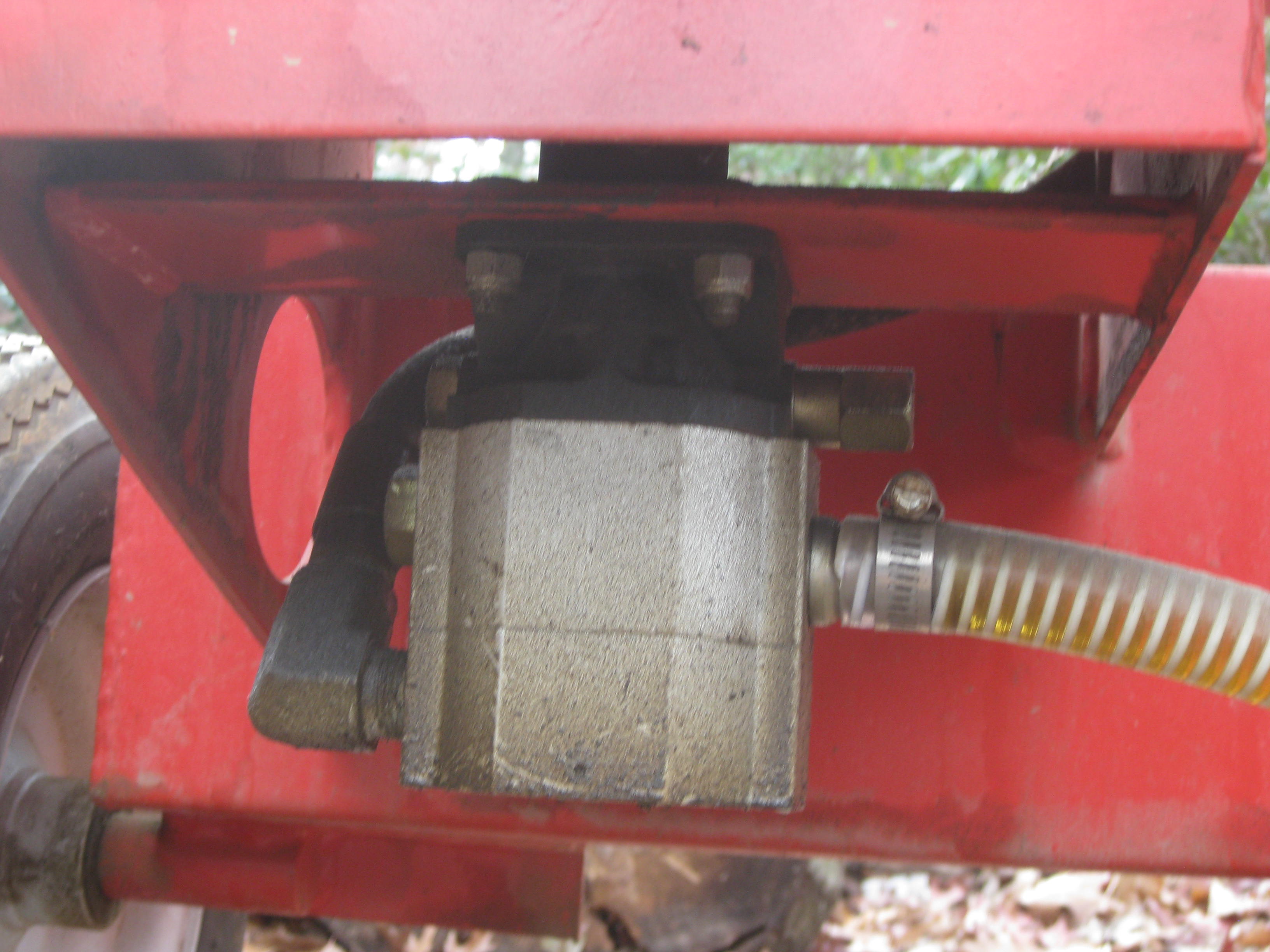

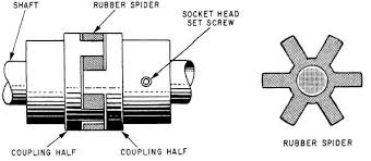

Check the coupling between the engine and pump. It's a common problem.
where is the coupling
   / TSC 22 ton log splitter, problem #8
Looks like a vertical shaft engine, so the coupling would be below the motor where the engine shaft is.
#9
is there a diagnostic test to do ?
   / TSC 22 ton log splitter, problem #10
Shooting in the dark here. :) There is probably a key or clamp on the motor shaft that connects it to the pump shaft. Look for any sign of slipping at that point. You may need to remove the pump from the motor shaft to see what's what. If that looks good, I would suspect the valve is stuck.
