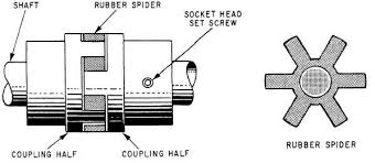

Nov 17, 2014 / TSC 22 ton log splitter, problem #21 K kenacp Bronze Member Joined Oct 20, 2007 Messages 71 Location New Orleans and Liberty Miss Tractor John Dere 770 Can't run a Lovejoy without the spider.......
Nov 18, 2014 / TSC 22 ton log splitter, problem #22 M mikehaugen Elite Member Joined Mar 9, 2009 Messages 2,628 Location Lee, IL Tractor John Deere 1070 kenacp said: Can't run a Lovejoy without the spider....... Click to expand... Well you CAN... just makes a heck of a racket and doesn't last long.

Nov 18, 2014 / TSC 22 ton log splitter, problem Thread Starter #23 OP L logan97 Gold Member Joined Dec 19, 2009 Messages 341 Location Blue Ridge Mnts, Va Tractor Kubota B7800 4/wd wrangler6831 said: Here is what you should have to be a complete lovejoy coupling.View attachment 398338 Click to expand... I posted a picture of the one I took off ( above) and it does not look like this, there was no spider. I am going to call the gentleman @ TSC in the morning to make sure we get the correct part. Thanks for the heads up.
