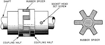

Thanks Dave. The "love-joy" is broken,piece that connects the motor shaft to the hydro box. TSC is going to try to order the part for me.If this is how you shoot in the Dark, you must rely be good in the Daylight. :)

Check the coupling between the engine and pump. It's a common problem.

You'll have to thank triptester for the diagnosis. I just helped you find the right spot to look in for his excellent call. :D

No rubber/neoprene shock absorber between the two halves of the lovejoy? It would be round--with three wedge-shaped "ears" that fit between the metal parts that are sheared off.

I will have to look on the ground for that. It would of had to break in 2 pieces because of the shaft. Maybe that is why it broke. TSC has to order the part as the manufacture has changed it.

Lovejoy couplings are normally stock off the shelf items. The two haves one to match each shaft diameter and the rubber spider that goes between them. They come in different sizes I prefer the bigger size, I believe they are the L-100 series. Just make sure they fit inside the engine to pump adapter.

the one TSC thought would fit did not have any rubber either. Just the metal with 2 different shaft sizes.

Well ... That don't seem right. That's no different functionally than a piece of round stock with a different size hole at each end and two set screws. I don't have any log splitter experience so I just don't know.
