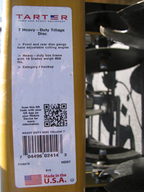

Old Pilgrim, I've had that TSC County Line 6' blade for my Kubota B2150 for about 10 years.
For quite a time Countyline implements were produced for TSC by King Kutter.
As of two years ago, Countyline implements have been produced for TSC by Tarter in Kentucky. The Countyline implements at my local TSC all bear prominent Tarter labels.
(At least in Florida.)
Interesting. I just checked the Tarter website, and their standard duty 6' blade looks identical to Old Pilgrim's, so I suspect you're right. And my 6-footer looks identical, as well, even though many years older.

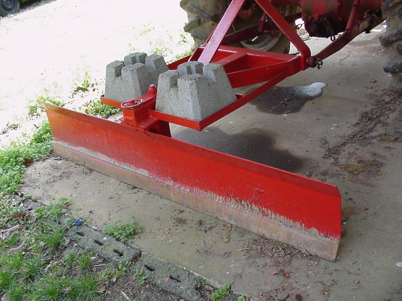

I got a Tractor Supply 6' grader blade about 1998 for our 8N Ford. Not sure who made it then, but do not think it was County Line. It worked OK for me, but a few years ago the swivel pin hole in the frame wore out badly and when I welded in new metal to beef it up, I added a tray on the rear to sit 2 concrete piers for weight. Not the best blade available, but cheap and rugged enough for a small tractor like my 8N. I turn it backwards to move fresh snow out of the driveway to prevent the blade from digging up my gravel. I move piles of leaves into the woods with the blade backward too. I've since got a box blade that handles most of the heavy work I need to do now.
