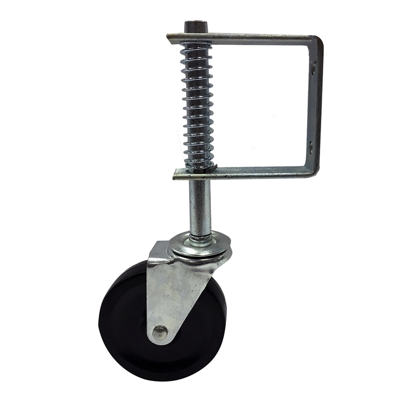

I'm puzzled by the wheels I see for tube gates. The spring, at least in the version I'm looking at, is captured by a u shaped bracket. But shouldn't the spring be anchored to the vertical axle (that is affixed to the wheel)? So that the wheel stays in contact with the uneven ground while the gate pivots. Else why have the spring at all?

The spring is anchored to the shaft with a cotter pin so the wheel can move up and down:

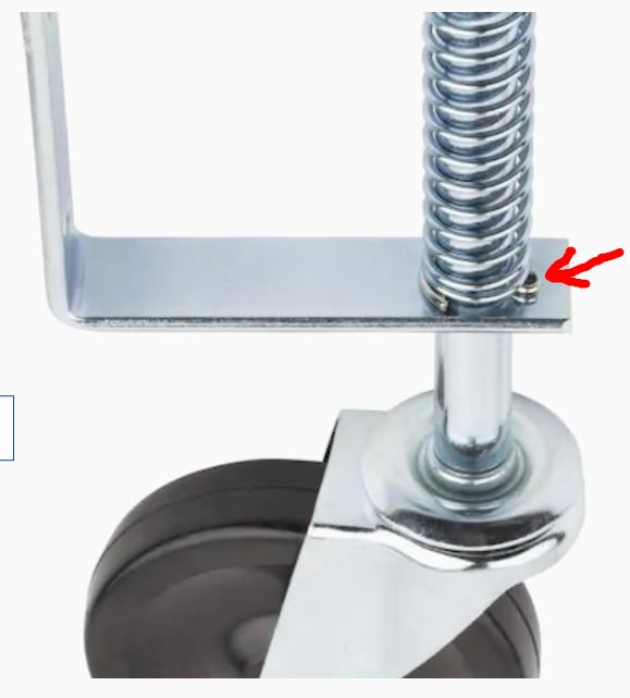

Xfaxman your picture makes sense to me. But the ones I've seen have that bottom pin _under_ the lower leg of the "U" trapping that leg against the spring. !!?
Makes more sense to me to mount the spring so that it keeps the wheel in contact with the ground rather than the "U".
View attachment 676461View attachment 676462
The wheel pictured is solid, and if it's like the ones I've used, it's about 4 inches in diameter. Not a good choice unless the ground is very hard and smooth. Much better are the gate castors with 8 inch pneumatic wheels, they handle rough ground with ease... and they work great.

Yes the 8" wheels are good. It's just that they're HUGE!
The Amazon delivery today was 2 of the 4" wheels and ... these are pinned as your picture. I don't know where the other weird wheel that is on the gate came from.
