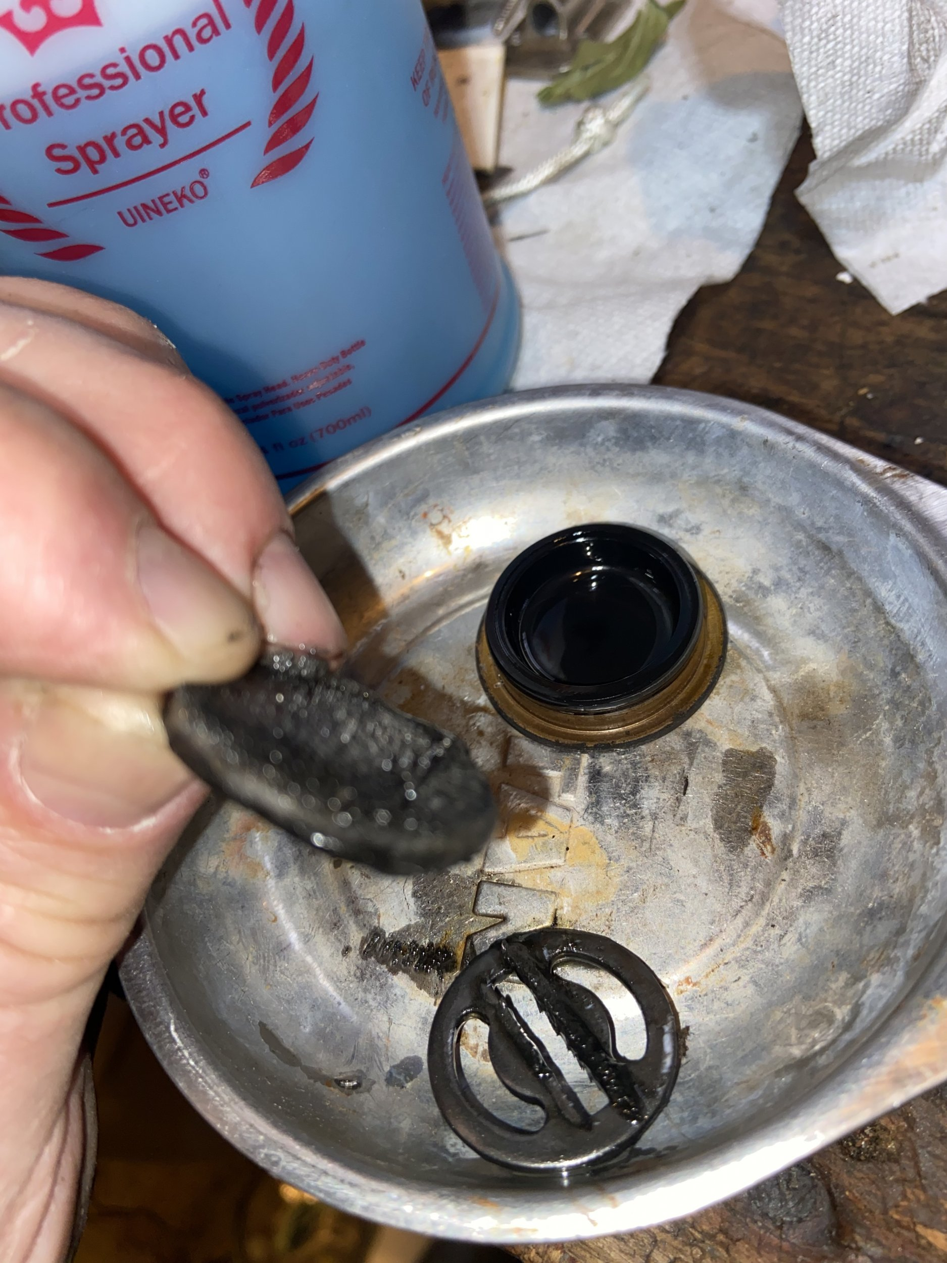

As many of us know, these Tuff Torq transmissions lose power over time. On my Husqvarna LGT 24K54, it lost virtually all power to climb the slightest of inclines after only 10-15 mins of use. I spent the $400+ and bought the rebuild kit from TT and ...rebuilt it, added new fluid and mmmmmmmmmmmmwah - she was like new again. (Never going to tow anything above 25lbs again!!!!). I now am having a somewhat similar issue with my JD LA175, though it only looses about half power after 20 minutes.
Big question is: Do I rebuild or just drain and refill with new TT fluid/oil? I removed that small cap in the rear of the tranny, higher up on the tranny, and when I stuck a 3" match stick down in there, it seemed quite low; barely hitting the 1/4" mark with about and inch and a half worth of the match stick stuck down in there. (Scientific, I know...). So I'm wondering whether to just take the tranny completely off the machine and just drain & refill --- or buy the rebuild kit and finish by refilling with new fluid/oil?
Any way to know if you just need fresh oil or a rebuild kit???

Normally the oil and filter is changed as the oil collects moisture and other contaminants over time that will promote wear to pumps and motors.
In the tractor I had with a hydrostatic transmission, I found the cause of lack of ground power over time was due to wear to the internal relief valves. Their role is to allow pressure by-pass if something were to say stall the transmission, to avoid mechanical failure, but they themselves are mechanical and the internal springs become weaker over time causing them to engage or by-pass at lower pressures, creating transmission stall under lower loads.
I let my dealer do this repair.

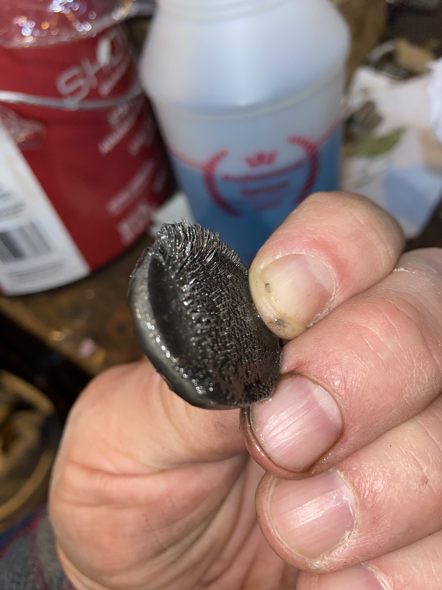

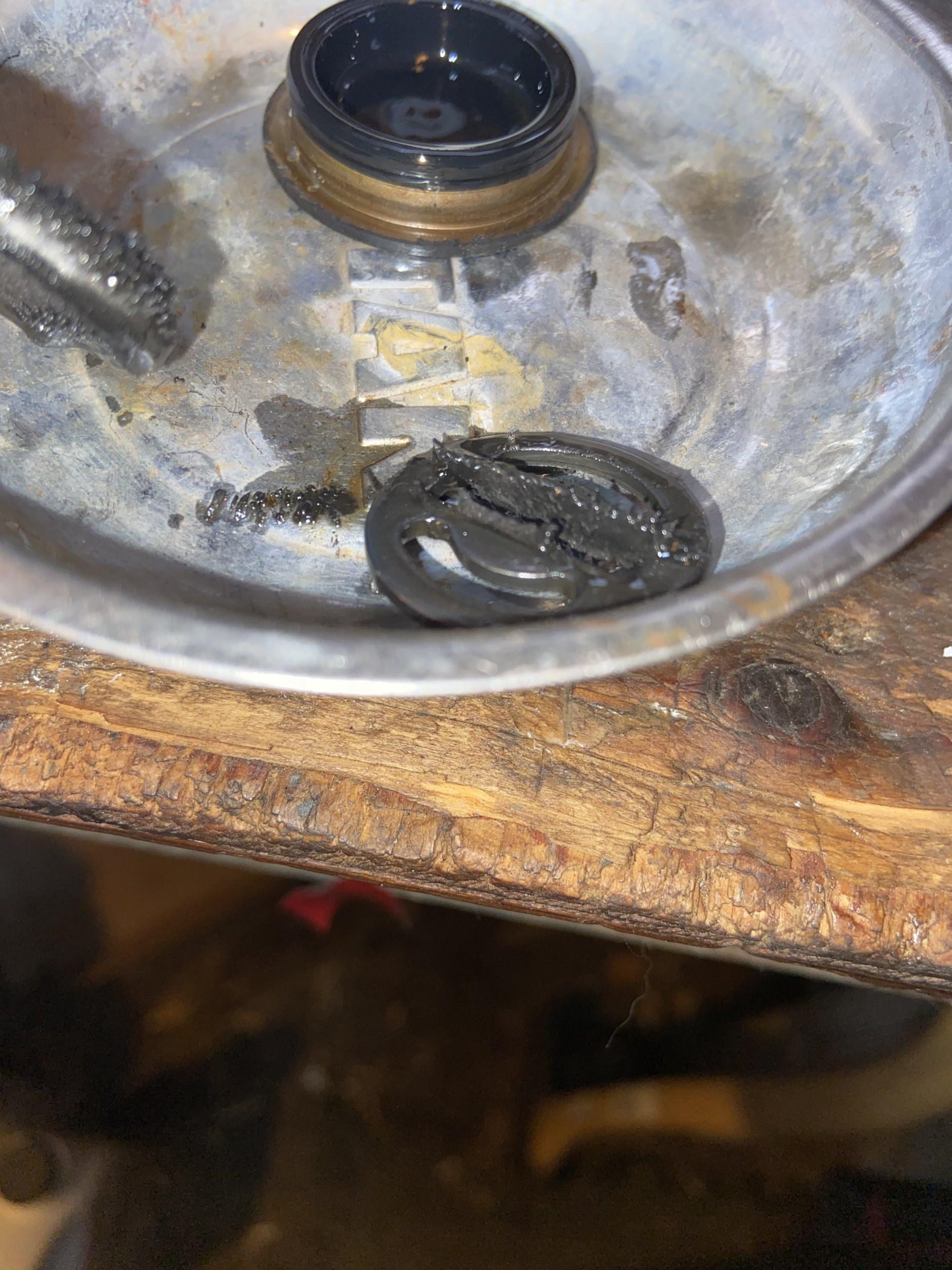

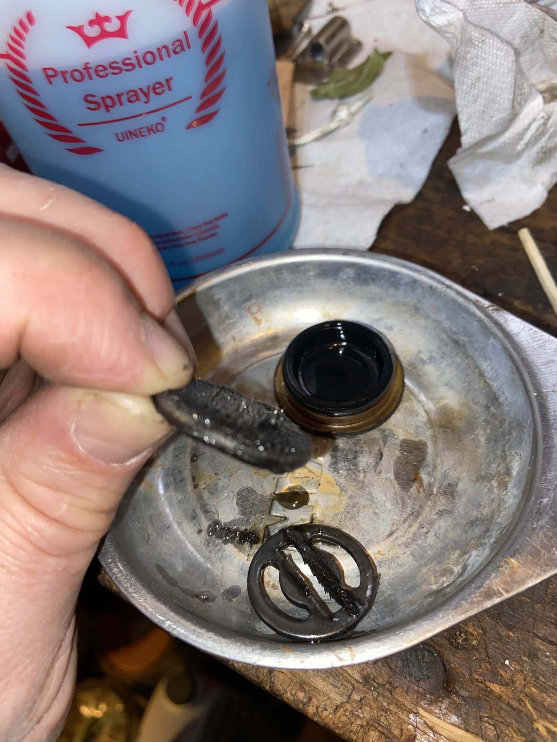

Thank you. I think this sheds lights on the $64k question: whether to rebuild or not to rebuild (just flush oil and refill). Trying the latter but prepared for the former. Given the filings, I’m fully expecting rebuild. But as commented previously, I’ll have a newly rebuilt Tranny after that.

Yep. That's a bad one.

Hah. I figured. I drained and changed oil. May load it back up and try it ….or order full repair and wait and just rebuild. Thanks Tom
   / Tuff Torq K46 - rebuild or just drain/refill oil? #37
When I find them just kinda coated, I'll evacuate what I can, which is typically around 3/4 of a quart or so and refill with the heavy oil to help someone out during regular PM to buy them more time. It isn't much, but it's quick and easy on some. For many areas, it isn't cost effective for a shop to rebuild one. Yours definitely has lots of ferrous evidence. These have their haters, but are still way better than the plastic ones.

I have not done this but I have read a lot lately and watched some video. I like the idea of opening up the Case and inspecting what you can before making a decision on how to proceed. If it does not look too bad then maybe an oil change maybe worth a shot. If you see a lot of metal filings on the magnets and filter then I would not bother. Rebuild it or replace it.
