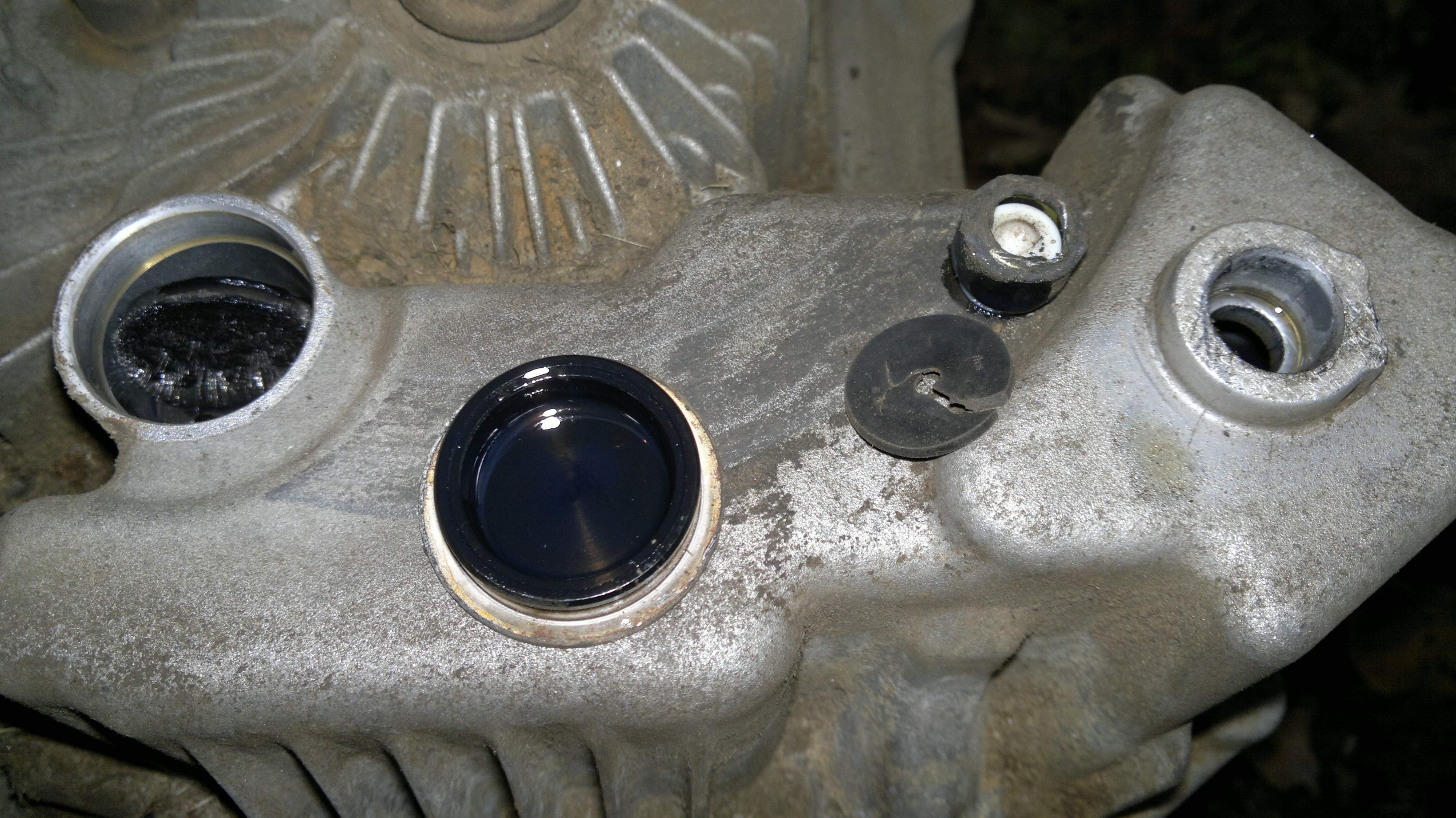

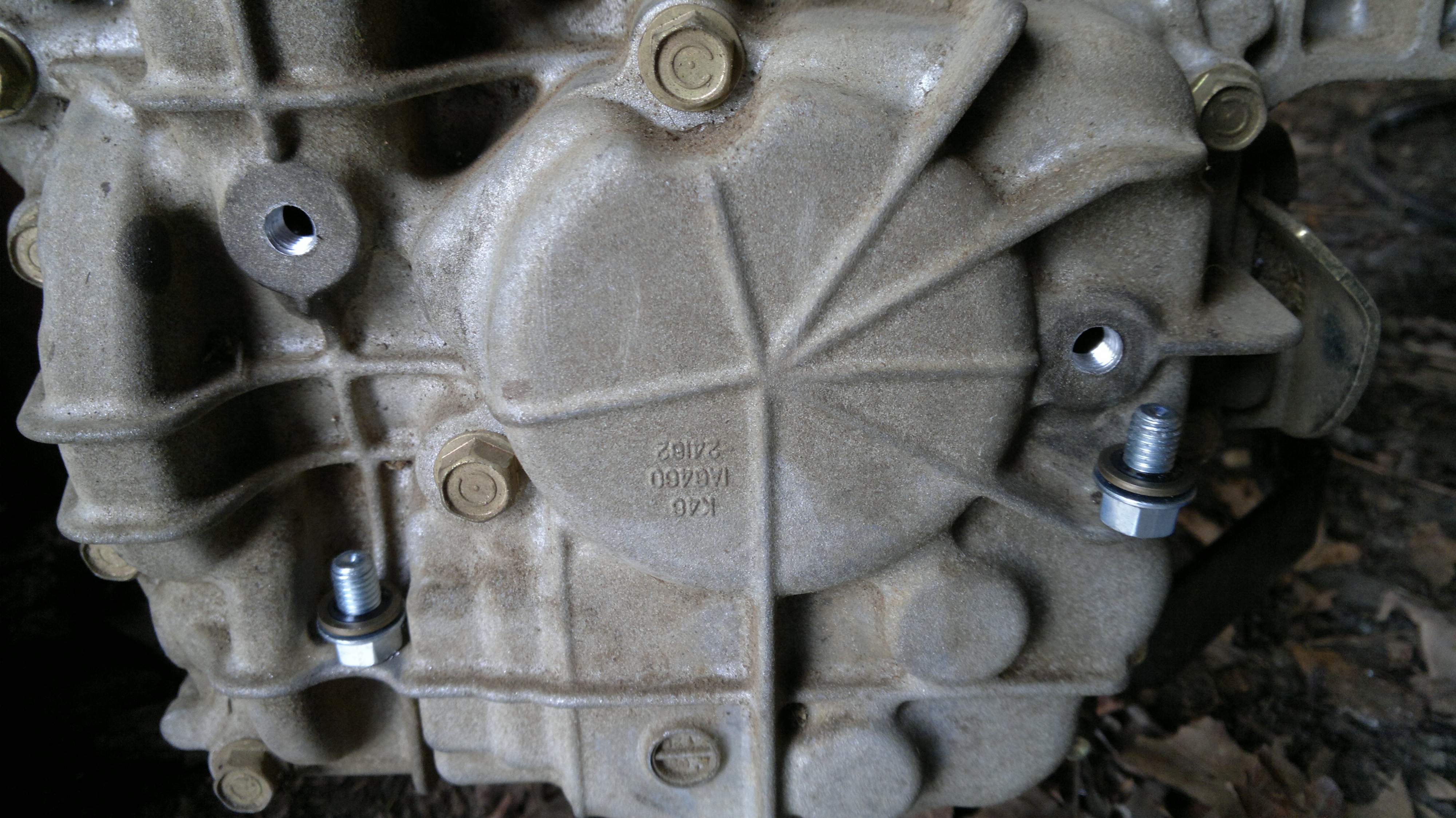

After months of self-debate, I finally decided to try the Change The Oil Only diet and avoid the pump/motor surgery as much as possible on my L130. I ordered just these parts, and bought Castrol Edge 5W50 oil from the local AutoZone:
  1. 187Q0399940 DRAIN BOLT KIT 2 0.87 1.74
  2. 1A646083050 FAN WHITE 1 7.51 7.51
  3. 168T2024250 VENT VALVE 1 6.18 6.18
  4. 168T2036300 SEALING CAP 30 1 2.42 2.42
  5. 168T2025220 FILTER 105 1 10.21 10.21
I was pretty disappointed at the $16.05 UPS Ground charge for such a small order, since it would have fit inside a $10 USPS Priority Mail Medium Flat Rate Box, although I would have much preferred "free" Amazon Prime shipping.

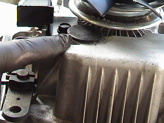

I got the vent valve and sealing cap on the advice of a previous post. I broke the vent valve while removing it, so I'm very grateful! The sealing cap stayed intact, but I replaced it anyways since the rubber had already developed an outside surface crack. The magnet had a nice collection of metal bits, but didn't strike me as overly concerning for an old machine with 374 hours.
I didn't use the filter as I decided to drill and tap the bottom case in situ and didn't feel like cracking the case and sealing it up again. And this would be a good exercise to see how little work I can get away with. Thankfully I already had an M8x1.25 tap in my toolbox so that saved me at least $6.
View attachment 286686View attachment 286689

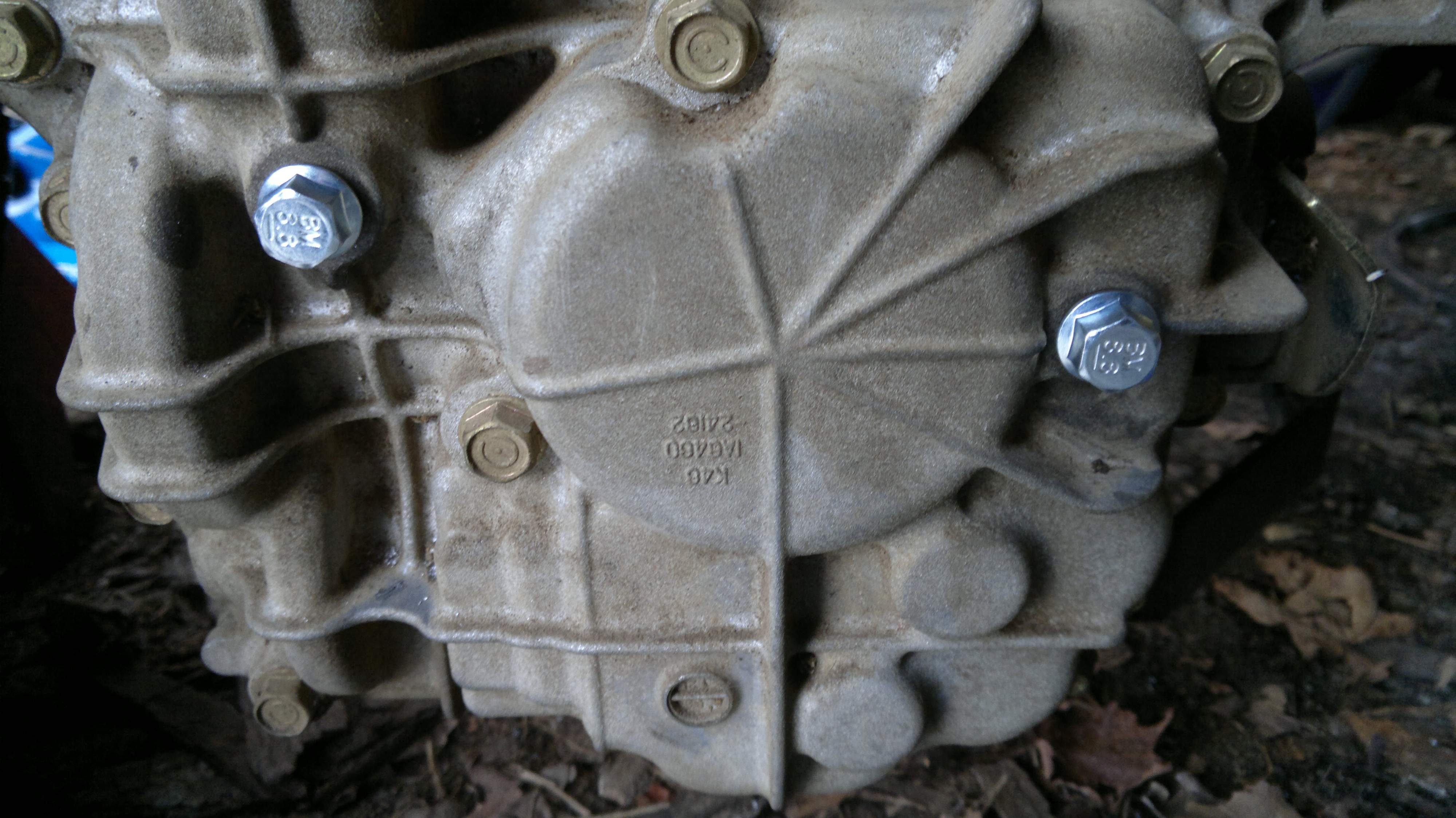

Overall it took me about 3 hours to remove the transaxle, drain the oil, add the two new drain holes, fill with new oil, replace the damaged fan, and reinstall the transaxle. A snap ring tool was needed to remove the fan. Although I had to replace my fan anyways, it really needs to come out to gain access to the sealing cap.
When I first drove it, it was slow moving, but gradually regained its speed after a few minutes of driving back and forth. I won't really know how effective the oil change will be until we get hot weather again next summer, since I took off the mower and installed the snowthrower in preparation for whatever Sandy decides to bring to NH.

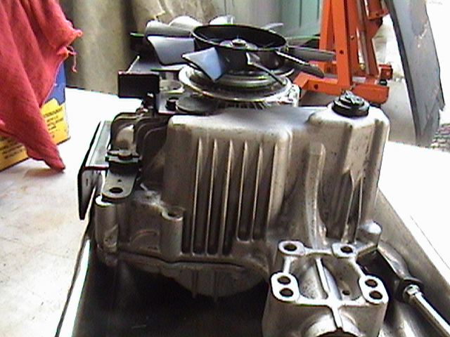

DSC00147.JPG DSC00148.JPG DSC00149.JPG DSC00151.JPG DSC00152.JPG DSC00153.JPG DSC00155.JPG

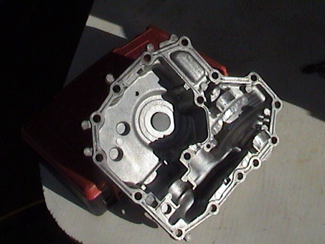

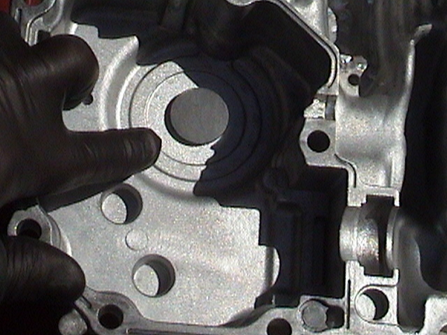

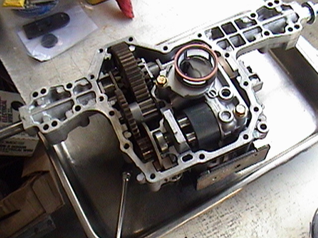

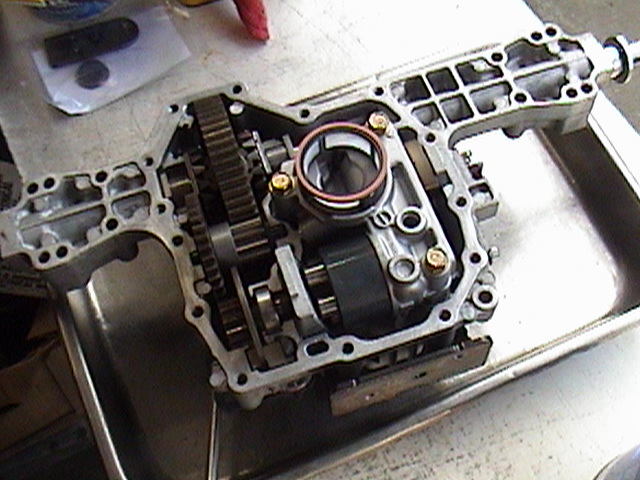

I used a Dremel Tool with a small wire wheel to clean the old gasket material off the mating surfaces. It helped to get the material out of the little groove that is in the middle of portions of the surfaces.
I then used acetone to get the surfaces really clean.

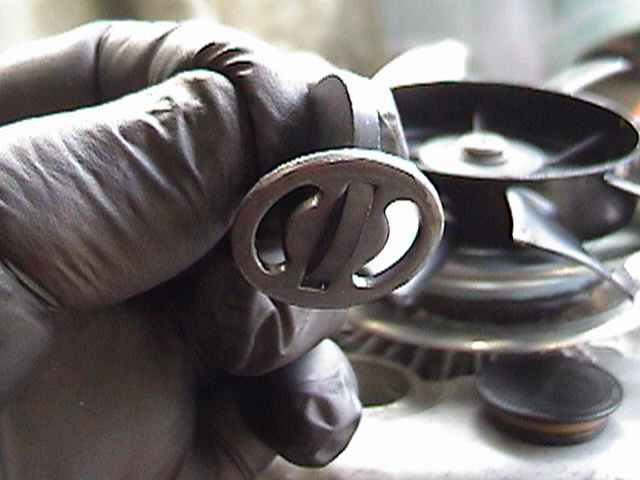

I had a loose round magnet that I couldn't figure out wear it went. Called TuffTorq but no one was there except for the operator. She sent me an email attachment supposedly showing where the magnet went, but it didn't have anything but a little black arrow that didn't show anything. I looked at the parts blow up for my K46BT tranny at:https://www.tufftorqservices.com/COM_Net2/servlet/WebDispatcher?mode=comnet

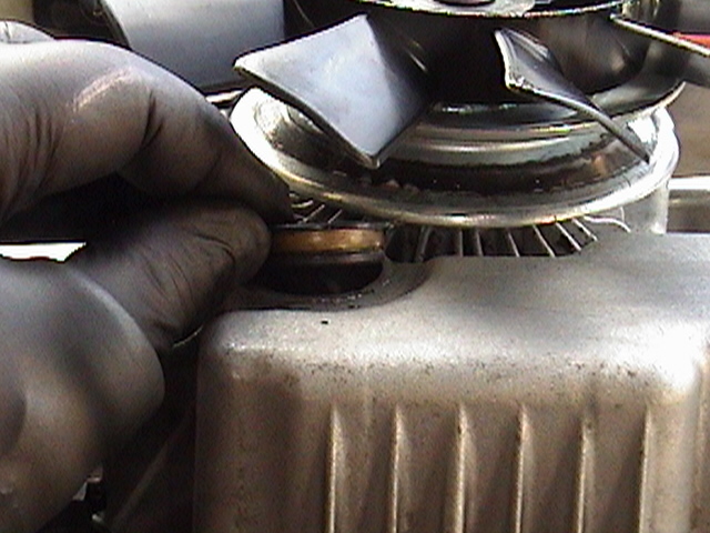

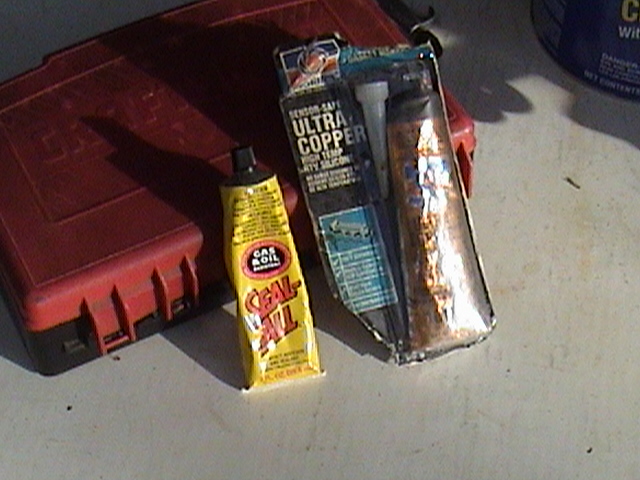

It appeared that the magnet labeled part 8 which fits into the magnet holder labeled part 9 was under the Seal Cap 30 labeled part 15. Didn't see any other magnets in the blow up, but I had one that fell out when I dropped the lower pan. I decided to use the Seal All glue in the yellow tube that is supposed to be impervious to oil and gas and glued it into the circle of the lower pan which will be under the filter and on the bottom of the tranny when it's installed. Hopefully the glue will hold. If it comes loose, the magnet could get sucked into the gears and cause big problems. The TuffTorq operator Kay said they had heard of people epoxying the magnet, but I wasn't sure that epoxy would hold up in the heat and oil.
I went to check for another magnet holder among the parts that I had sitting on the foot pads of my lawn tractor and found the two brake pads. Glad I found them before I sealed the tranny pan on. Had a little trouble figuring out how they went in as the parts blowup isn't clear, but I looked at LOGG's pictures and saw that they go on either side of the brake disk. My pictures above show the magnet glued into the lower pan, the seal cap being removed and the magnet and magnet holder pulled out. I showed the Seal All glue so you can find it at your local stores. It worked good to seal up a plastic fuel tank on a child's ATV that cracked along a seam. Epoxy didn't work at all. only dripped through the crack and never hardened, probably because it was pretty old or I didn't put in enough hardner. Also showed the Ultra Copper gasket goo I will use per a previous poster's recommendation. The glue is drying tonight and I will probably put the tranny pan on tomorrow (my 68th birthday, what else should you do but get something done on your birthday at this age? I can't sit around eating cake all day...but drinking wine wouldn't be so bad...maybe I'll wait until the weekend when it's raining again!)
I might should a video pointing out the various things I found broken and how I cleaned up what I thought were some areas that needed a little polishing and cleaning before re-assembly. I just hope I have the forward/backward part in right so I don't have to redo the job.

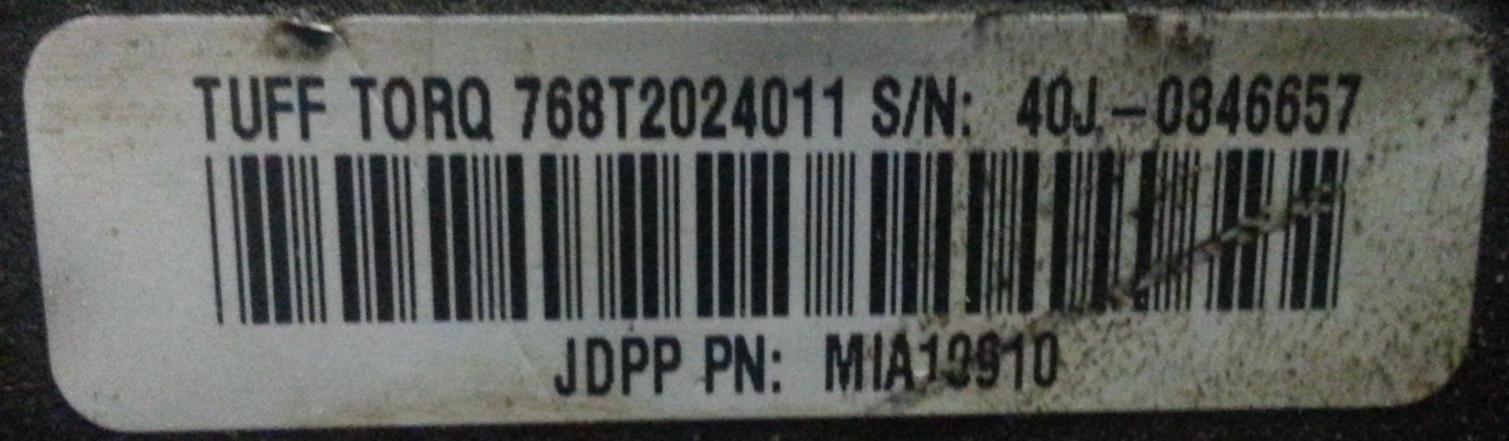

Hi All,
I managed to pick up a JD LA120 on the cheap because oil was poring out of the RH shaft....Turns out the shaft washer had warn straight through allowing the wheel spacer push into the shaft seal, ripping it open. The mower was just about moving when I picked it up and there was a small amount of oil still in there (about half a quart).
Anyway I have few questions for all you K46 specialists :thumbsup:.... before I investigate what's happened inside...
  • If a transaxle runs low on oil will it damage itself or just stop running?
  • Is there anything that I should closely inspect in there when I open up the case?
  • I have a T40J TRANSMISSION ..... But what's the "W/FILTER IDS"?
Many thanks for your help
Neo

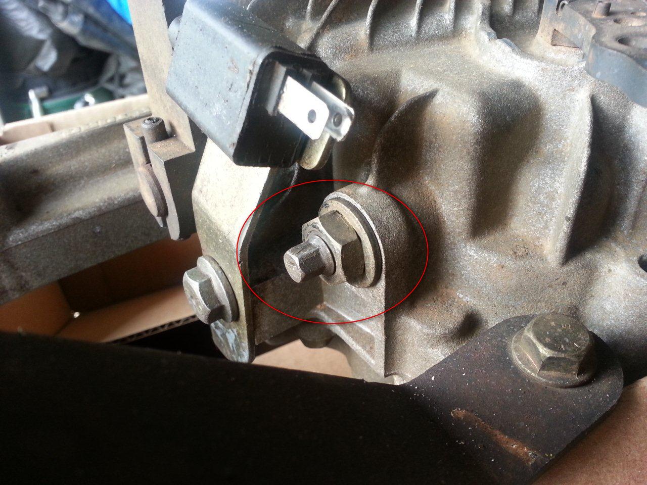

Also, does anyone know what this adjuster and locking not does?
I need to find a replacement wheel shaft seal too.... Would I be able to get this from a regular seals and bearing shop ... or is this really something special that only TT can supply?
Below is a picture of the LH seal that's still Ok.
All the best.
Neo
