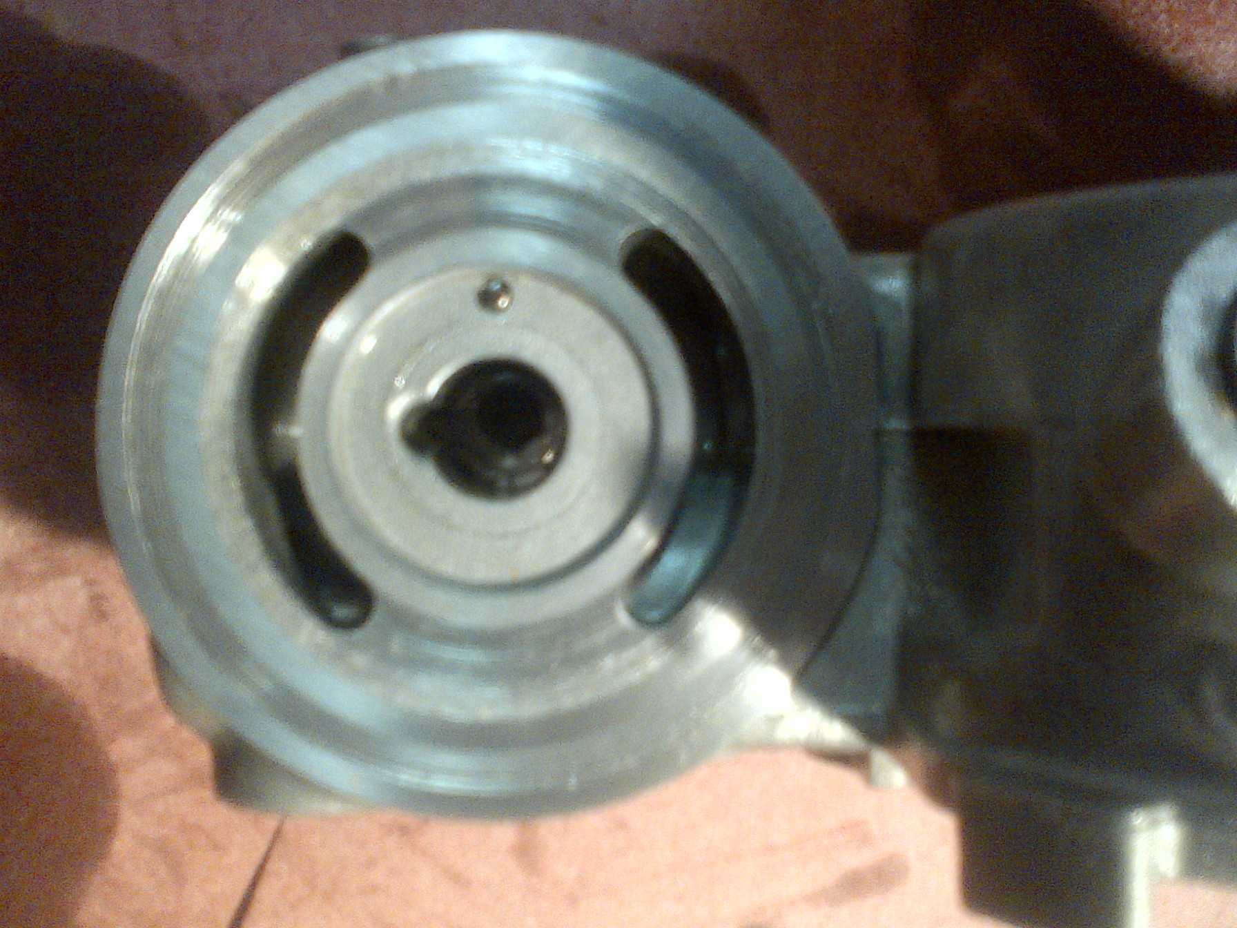

JoeBob, please correct me if I'm wrong and/or you disagree with any of this. I just successfully rebuilt my TT K62 using your "machining method", instead of having the parts 'machined', I carefully did the following:
1. I sanded the motor, pump and case assembly
2. I used a small piece of oak (any extremely flat surface) and used 3M sticky back sand paper (320 grit, 400 grit and finished with 600-grit)
3. each side/piece took me about 15-20 minutes of careful sanding in a circular motion
sorry in advance, I know these aren't great pictures, however... you should be able to understand the point.
CENTER CASE BEFORE: note the scoring or rings. (BAD)

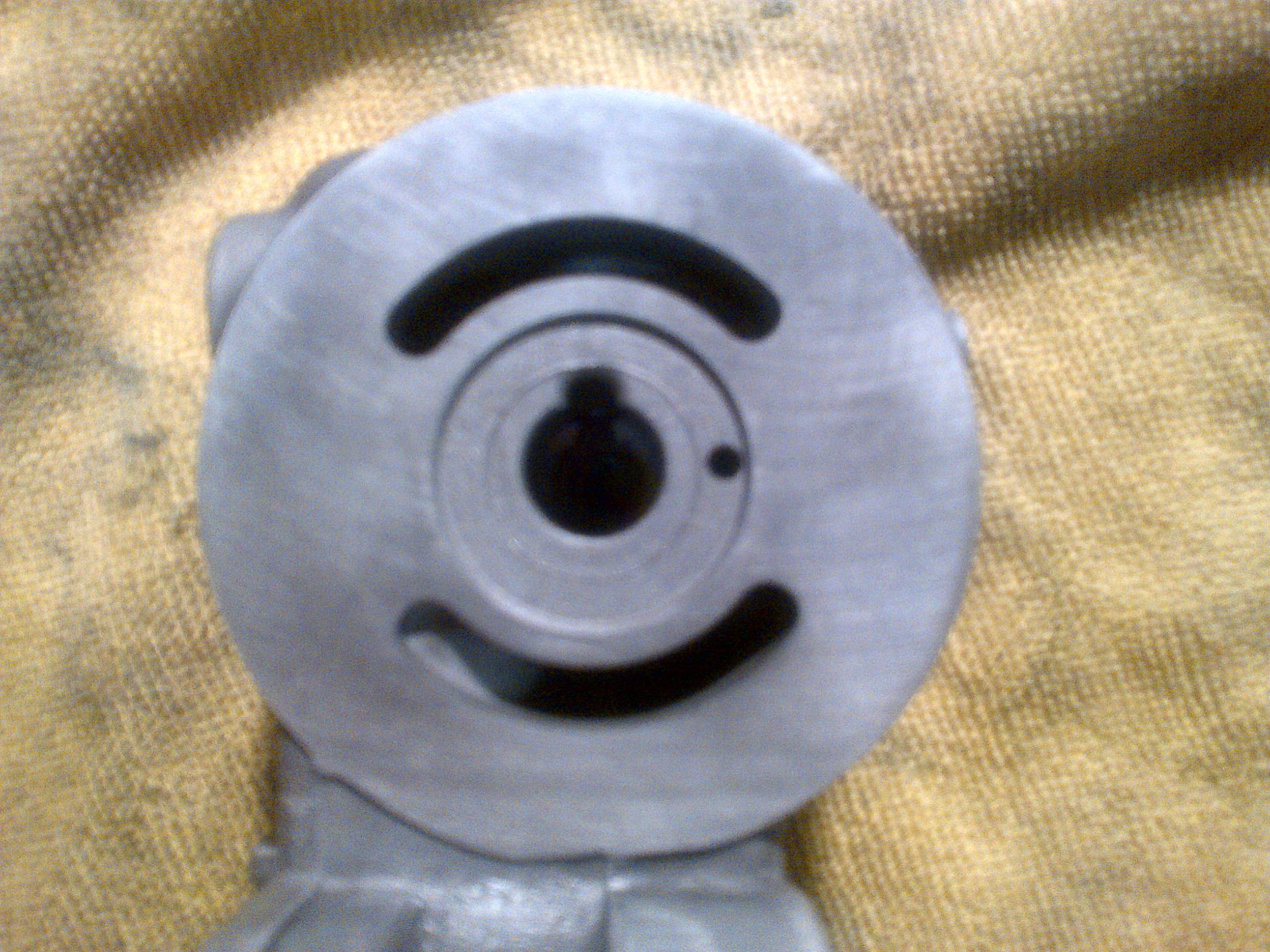

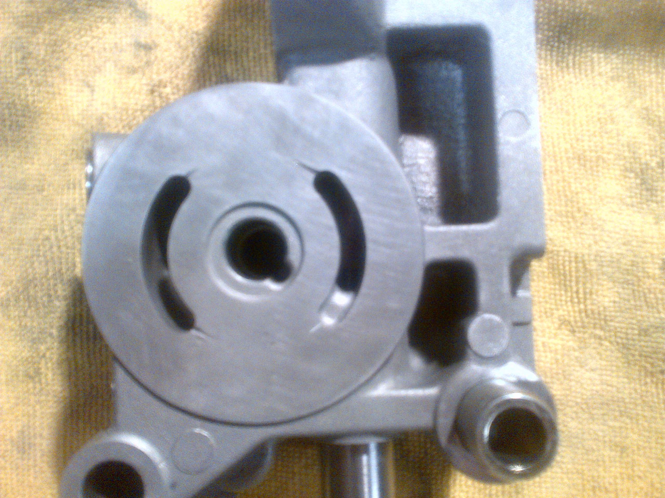

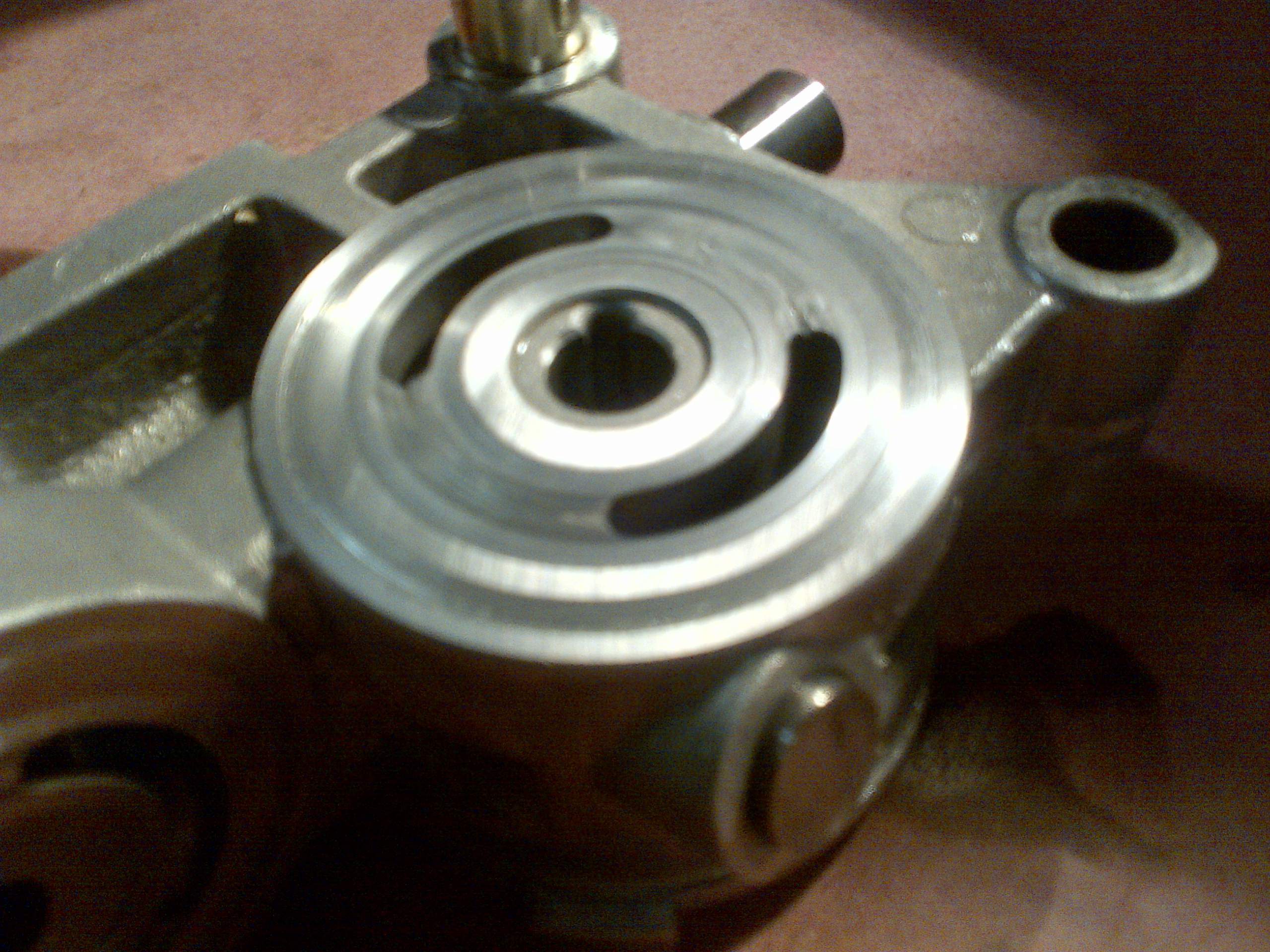

CENTER CASE AFTER:
View attachment 290367View attachment 290368

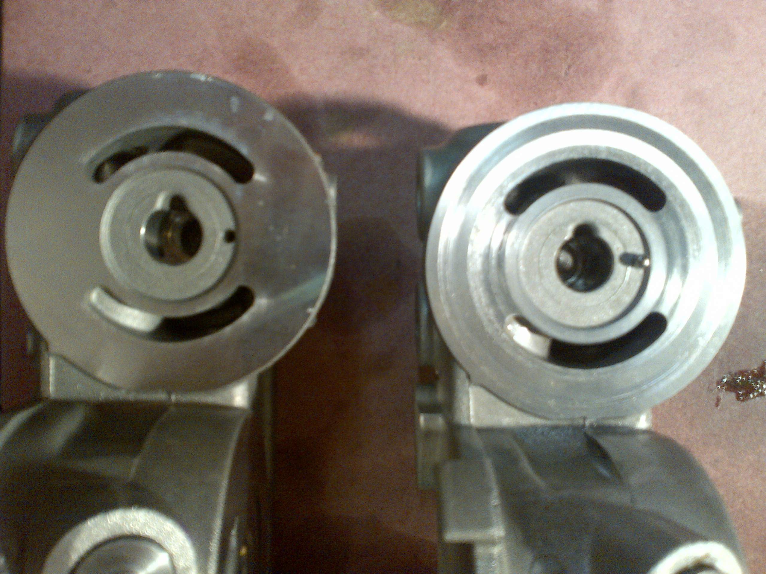

CENTER CASE new vs old: (I purchased a new center case assembly, but decided to try sanding my original center case assembly first - worked like a champ)

Thanks for posting. Wish you had a better camera.
