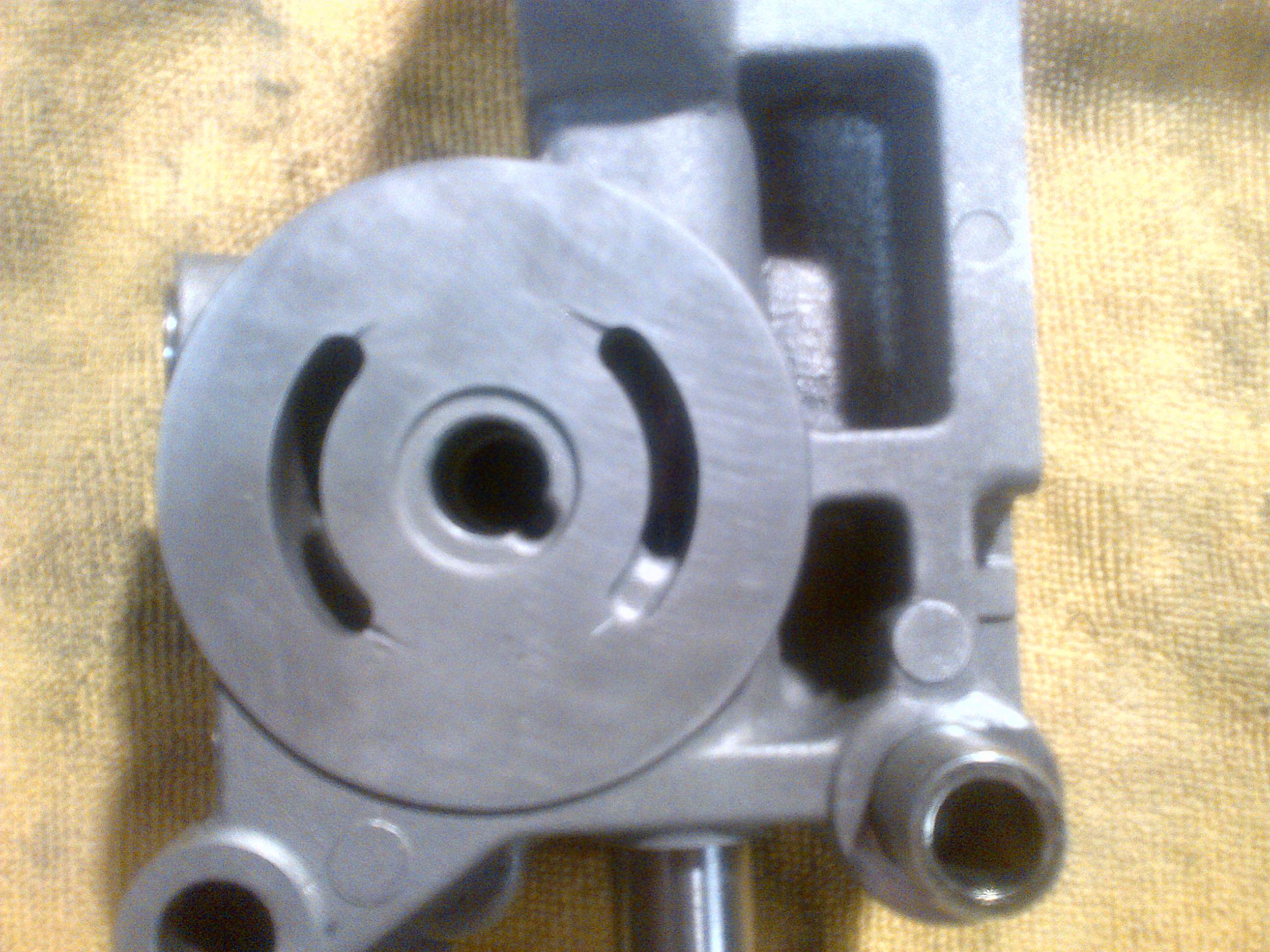

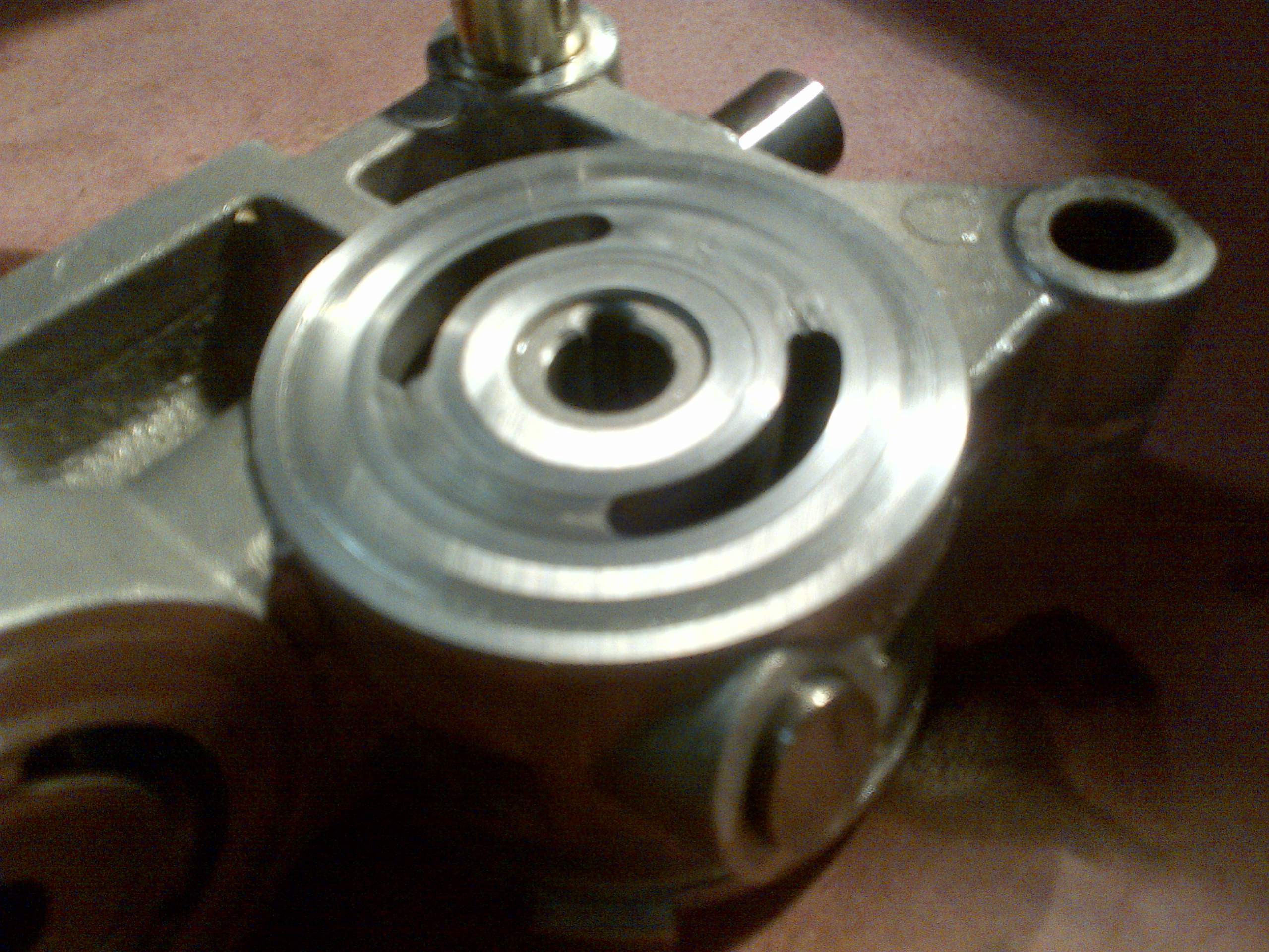

JoeBob, please correct me if I'm wrong and/or you disagree with any of this. I just successfully rebuilt my TT K62 using your "machining method", instead of having the parts 'machined', I carefully did the following:
1. I sanded the motor, pump and case assembly
2. I used a small piece of oak (any extremely flat surface) and used 3M sticky back sand paper (320 grit, 400 grit and finished with 600-grit)
3. each side/piece took me about 15-20 minutes of careful sanding in a circular motion
sorry in advance, I know these aren't great pictures, however... you should be able to understand the point.
CENTER CASE BEFORE: note the scoring or rings. (BAD)
CENTER CASE AFTER:
CENTER CASE new vs old: (I purchased a new center case assembly, but decided to try sanding my original center case assembly first - worked like a champ)
Additionally, I also carefully sanded both surfaces of the matting pieces (the revolver pistol chamber looking thing). Unfortunately I forgot to take any pictures.

   / TuffTorq K46 Repair Guide with Pictures #426

Just a thought.... Is that gowning moaning sound caused by the uneven surface of the Centre Case??
   / TuffTorq K46 Repair Guide with Pictures #430
Neo,
Regarding "moaning / uneven surfaces", to be perfectly honest w/ you, I'm a computer geek by trade. After having read through this entire post a couple of times, JoeBob's idea of resurfacing the wear points made sense to me. My problem was I don't know any machinist. So I thought that I'd try carefully sanding the worn areas.
END RESULT:
Without question I haven't had this much power with my Scotts S2048, TT 62 in years! how long this repair will last I don't know, but I have 1,150 hours on her already. So if I get a couple more years out of her, that would be awesome. (I'm actively looking for a JD 455 AWS & would love to get a hold of one that's in need of repair...)
