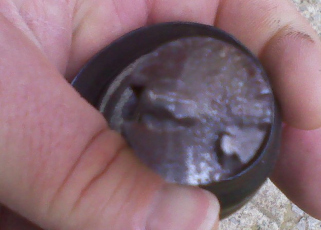

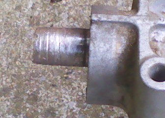

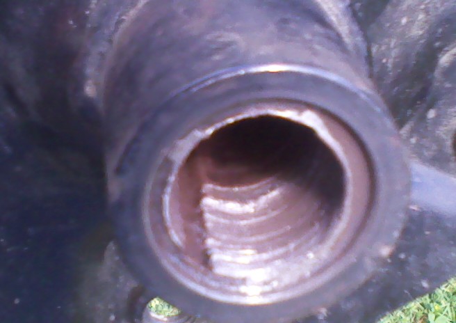

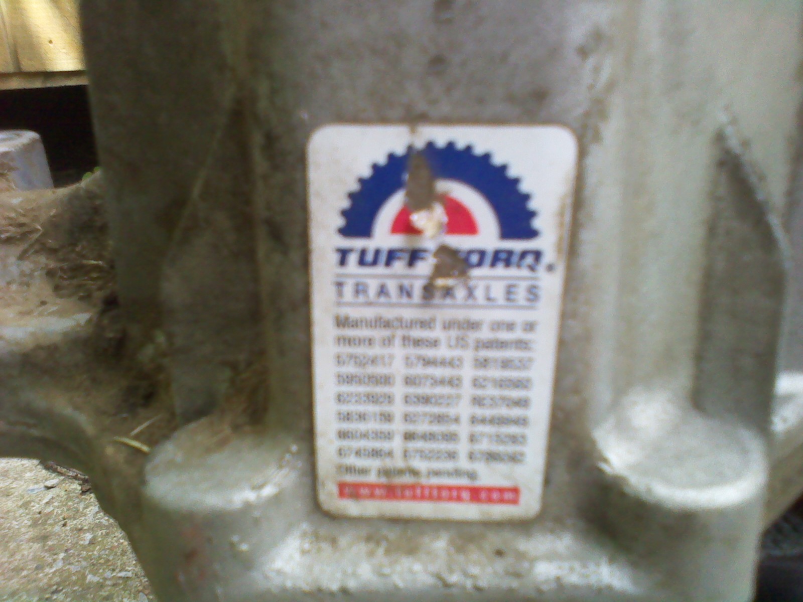

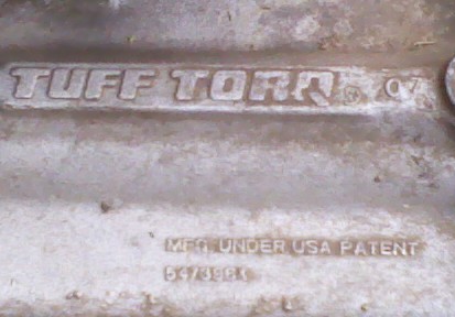

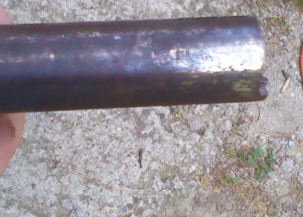

I have some problems with a Husqvarna LGT 2654 Lawn Mower. I have a Tuff Torq K46BN transmission. The problem is that the axle broke on the left side. It has the wheel hubs and broke inside the wheel hub. I called Tuff Torq and the directed me to Husqvarna. Husqvarna doesn't want to cover it even though its a factory defect. They want to push it back on the Tuff Torq. Its my girlfriends parents mower and they are wanting to get it fixed. I am not happy with the situation at all. I told them today. They don't have to worry about me ever buying any of their products. The mower was purchased at Lowes. The mower was made in 06 according to the manufacturing date that is posted on the serial number at Partstree.com. The mower was bought in 08. Tuff Torq will not admit or even look at the pictures of the transmission. I could understand it was a pump or something due to wear and tear going out.
The guy at Husqvarna customer service was implying that they didn't take care of the mower. Gee I don't think an axle is a maintenance part. It has signs of not being a clean fresh break all the way through. So thanks to Tuff Torq and Husqvarna. I have 3 options or 4 actually. 1. try to get it welded, 2.replace the manufacturing defective axle $80 plus the hub assembly that sits around the axle, plus S&H and time, 3. buy the transmission assembly for anywheres from $616.81 plus shipping and handling to over $868.87 plus 15% on shipping and handling, or 4 buy a new mower. Definitely will not be a Husqvarna. We have a Toro and I am glad to have it. We also have a Cub Cadet Model #2185. I have had no problems out either of those mowers. The Cub Cadet has had some work done, but to be expected since it was built I think in 1994. I really hope that if any you out there buy a new mower. Look at your warranty. You would think that it being a manufacturing defect and having several people who weld for a living and know what they are looking at tell me this. You would think that they would honor the warranty and make a happy customer. I will send some pics when I get it figured out for you to see for yourselves.....View attachment 321270View attachment 321271View attachment 321272View attachment 321273View attachment 321274View attachment 321277View attachment 321278View attachment 321279View attachment 321280View attachment 321281View attachment 321282View attachment 321283View attachment 321284View attachment 321285View attachment 321286

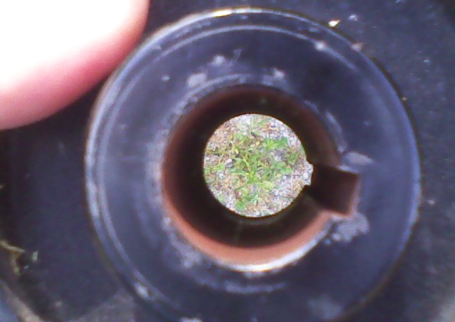

I have the same problem you had, almost the same story - Husqvarna LGT2654, 150 hrs, K46 Transmission, Left axle, Manufactured 2006, Purchased 2008, Lowes, etc. Any luck with either of them covering it under a warranty? Have you fixed the axle yet? I went to the TuffTorq site and found the Axle Kit for $96 including shipping. I have a farmer neighbor who is going to look at it tomorrow to see if he can weld it, but it's doubtful since it sheared off inside the wheel hub right at the end of the notch where the axle key inserts into the shaft which is about 1/2" inside the wheel hub and about 1" from where the axle ends at the transmission. Does anybody know of a website that gives directions on how to replace the axle shaft?

I have basically the same problem GranadaMan had, almost the same story - K46, Husqvarna LGT2654, 150 hrs, Left axle, Manufactured 2006, Purchased 2008, Lowes, etc. I went to the TuffTorq site and found the Axle Kit for $96 including shipping. I have a farmer neighbor who is going to look at it tomorrow to see if he can weld it, but it's doubtful since it sheared off inside the wheel hub right at the end of the notch where the axle key inserts into the shaft which is about 1/2" inside the wheel hub and about 1" from where the axle ends at the transmission. Does anybody know where to find a website that gives directions on how to replace the axle?
   / TuffTorq K46 Repair Guide with Pictures #624
https://www.tufftorqservices.com/EnvEEdefault/FlatHTML/TechInfo/docs/Repairprocedures.htm
Simple to do. I changed axles in a K58 with no problem. Open Case top down. At differential, pull two C-Clips/thrust washers out and pull out axle. Change seal, tape and lube new axle, Slide in, put C-Clips/thrust washers back and and make sure they are seated in differential. Repeat for other side. Hopefully you bought two drain plug kits as it is easy to drill the holes out in the lower case and tap them. You will need to scrape all gasket sealant off the case and reapply new. Wait 24 hours, fill with 5W50 and put the top plugs back in and you are good to go.
