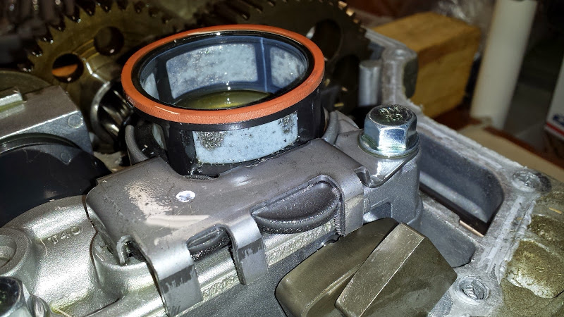

My update: I'm 83 hrs down the road(434 hrs now) and finally pulled it apart to do again. Here is a little bit about what I found and learned this round.
First off, 83 hrs is really too soon to be rebuilding the transmission. I've seen others on the thread with much less hours per rebuild, so I guess I'll try to feel lucky.
The 5w50 Synthetic looked really bad coming out. Think in the direction of muddy. I thought it would still be clean, or near it.
The "updated" filter I got with the last rebuild was nearly plugged up with filings and grease like gunk.
The aluminum housing part was scored up like they all are. The magnets had plenty of metal filings on them.
The pump and motor blocks also scored up as usual. I saw minimal signs of gears degrading.
I used the 400 grit wet(with oil) sanding method on the aluminum block surfaces, they shined up quickly and fairly easily, straight forward.
The motor and pump blocks were a different story. I believe I learned something here, which may have been said on here before, but there are a lot of pages of people talking here and I didn't catch them all.
When I started sanding down the pump and motor blocks, the outer of the 3 scoring rings quickly sanded smooth. And I kept sanding and kept sanding and sanded and sanded and eventually gave up. I never did get to smoothing out the 2 inner scoring circles. For some reason the 2 inner circles were worn down a lot more than the outer one and I eventually came up wondering if that surface is even supposed to be flat across??
So, cleaned up. My sanding experiment gone about as well as it could, filter cleaned, magnets cleaned, I put it all back together. I would bet I'm a bit past 2.5 quarts of new 5w50 synthetic in it, I believe I was seeing 2.2 as the right amount. I filled it up, tried to burp it and then filled it more.
Put it all back together and gave it a go.
It was super tight. I am heading into the future with the weakness of the tranny design on top of my mind, but I also mowed a couple solid hours without feeling the first sign of soft. That is like getting a pardon from a life sentence for someone who's been driving on a soft tuff torq for 30 hrs.
In my mind, the key to the operation is the fact those pump and motor blocks were worn more in the middle than on the outer edge. Sand them puppies down a lot or the job isn't going to go tight for you. At least that's my new personal theory on it. That idea may be old and all over this thread, so I just want to couch my "findings" as quite possibly being found already a long time ago by a whole bunch of people. If they weren't... I hope it helps out now and from here forward.

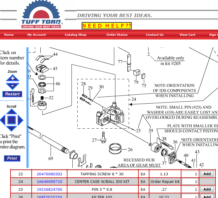

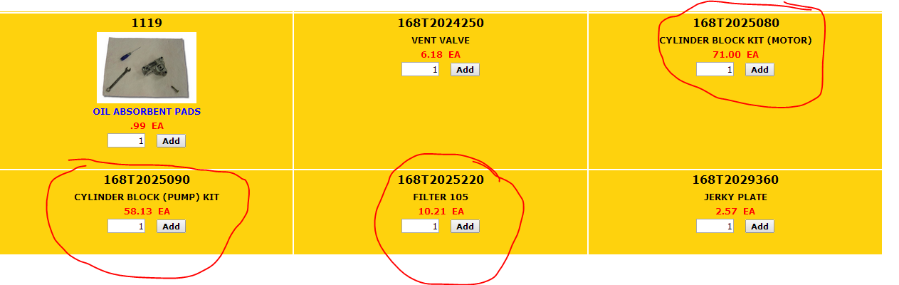

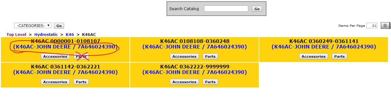

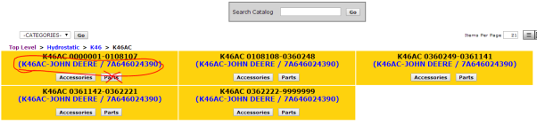

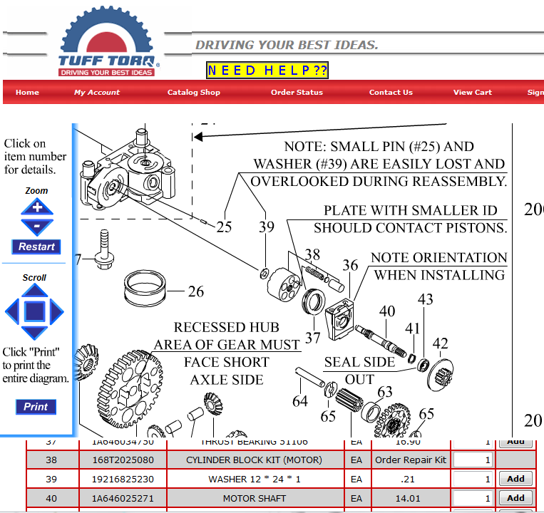

This is what I get from my K46AC shopping screen:
They removed the Add button next to select items including the pump, motor, & case.
   / TuffTorq K46 Repair Guide with Pictures #770
View attachment 388810View attachment 388812
I see what's going on. Instead of clicking parts, click the blue serial number that matches your's. Then you get a screen like attachment number 2 where you can cherry pick pieces!:thumbsup:
