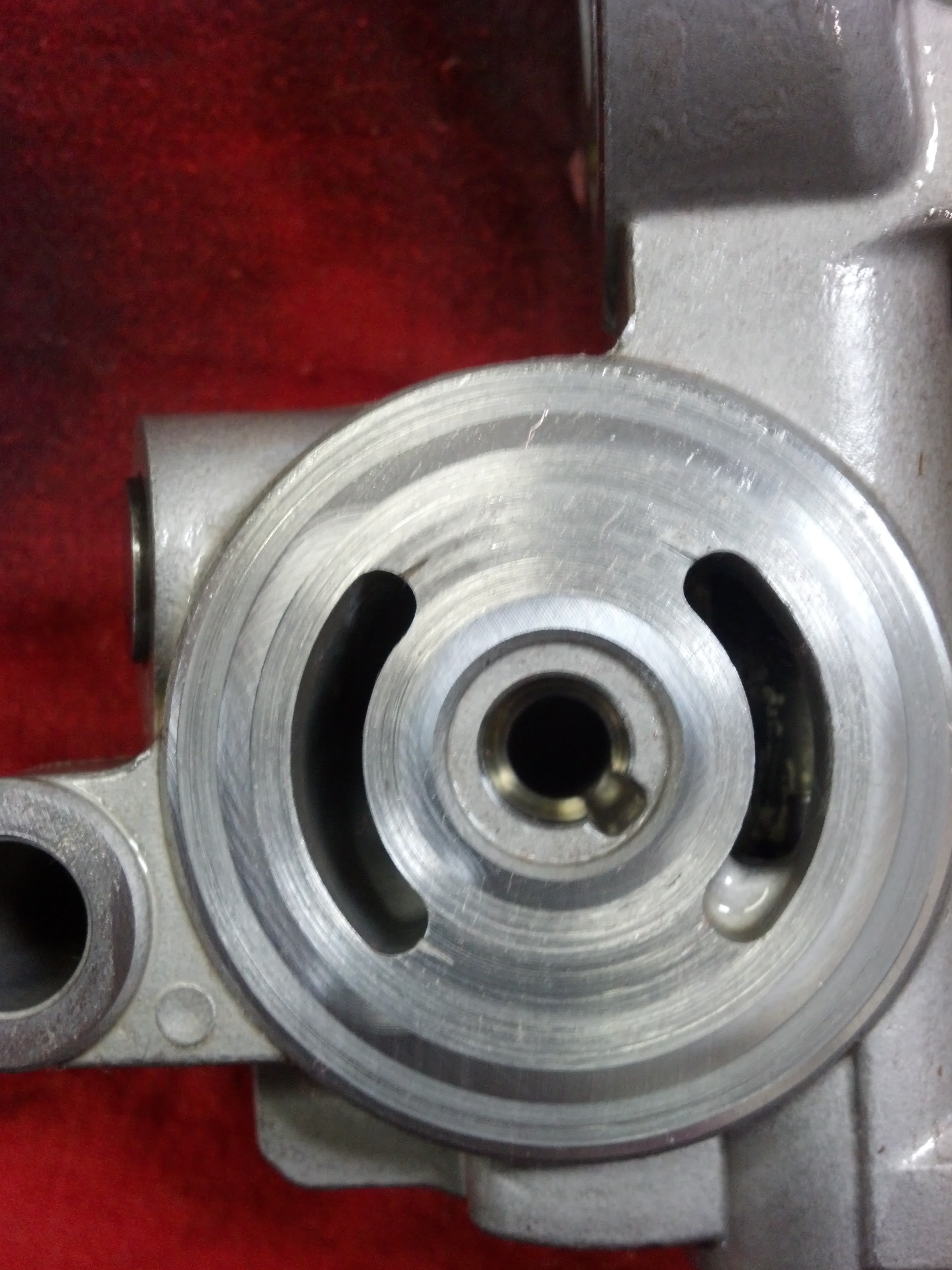

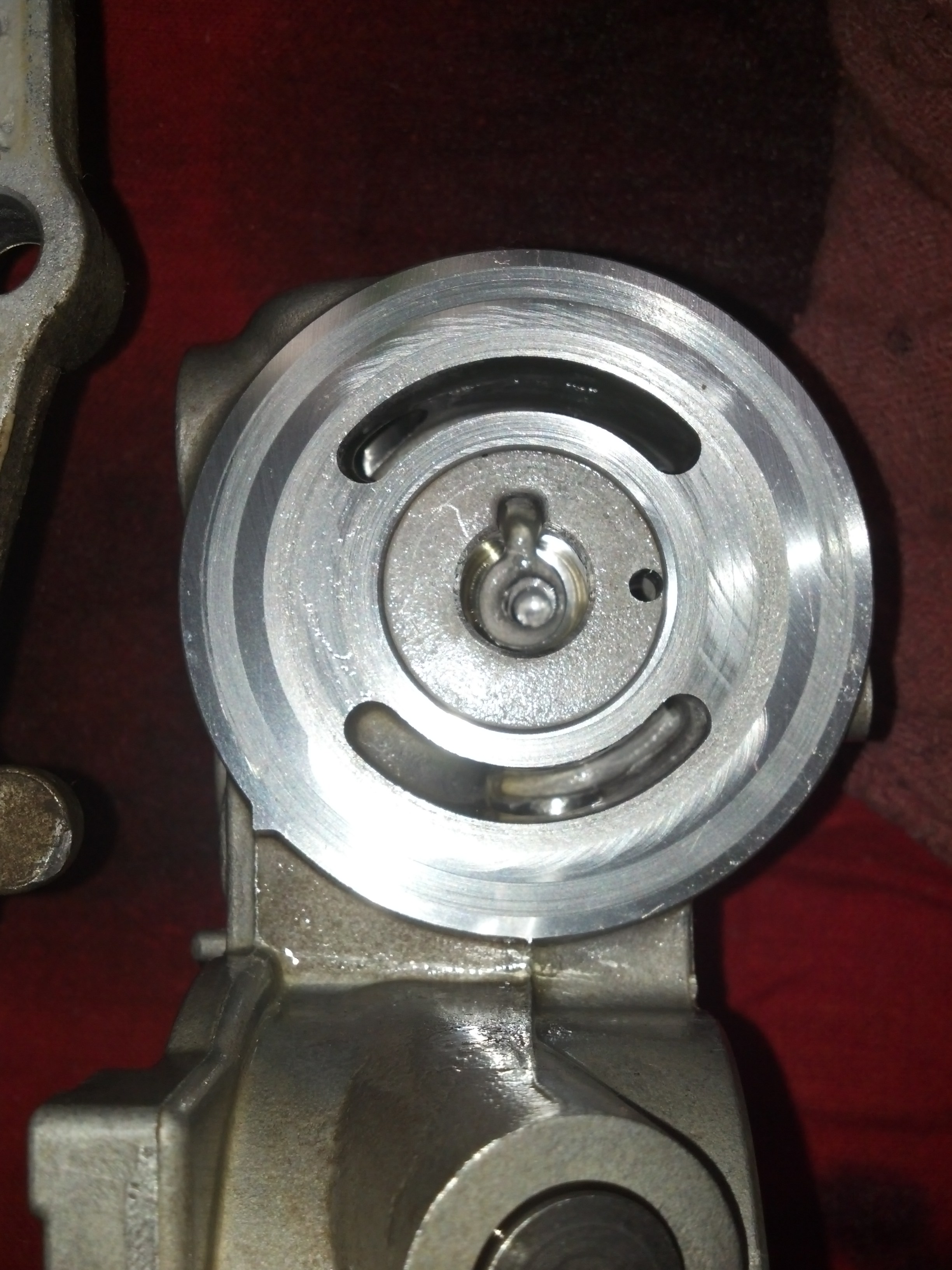

One last thing to note when doing this rebuild...
I can see now why tufftorq wants to sell you the whole motor/pump block assembly. when you get yours apart, check the surface that the pump and motor rotate on. If it's heavily scored or damaged, you will loose oil pressure here as well. Mine is not too bad. It won't catch a finger nail so I'm gonna go with it. I'll lightly clean it up with some emry cloth and see what happens. I'll let you all know.
I have attached photos of how mine looked. Good luck to all and thanks again to the OP for his great information.

LotsofGreenGrass is amazing, Thank you!!! Repaired my TuffTorq K46 for $170 vs $750 for new transaxle. I did have to take it back apart, apparently I misaligned something during the first assembly and the axle wouldn't turn. I took greater care the second time and it works great.
