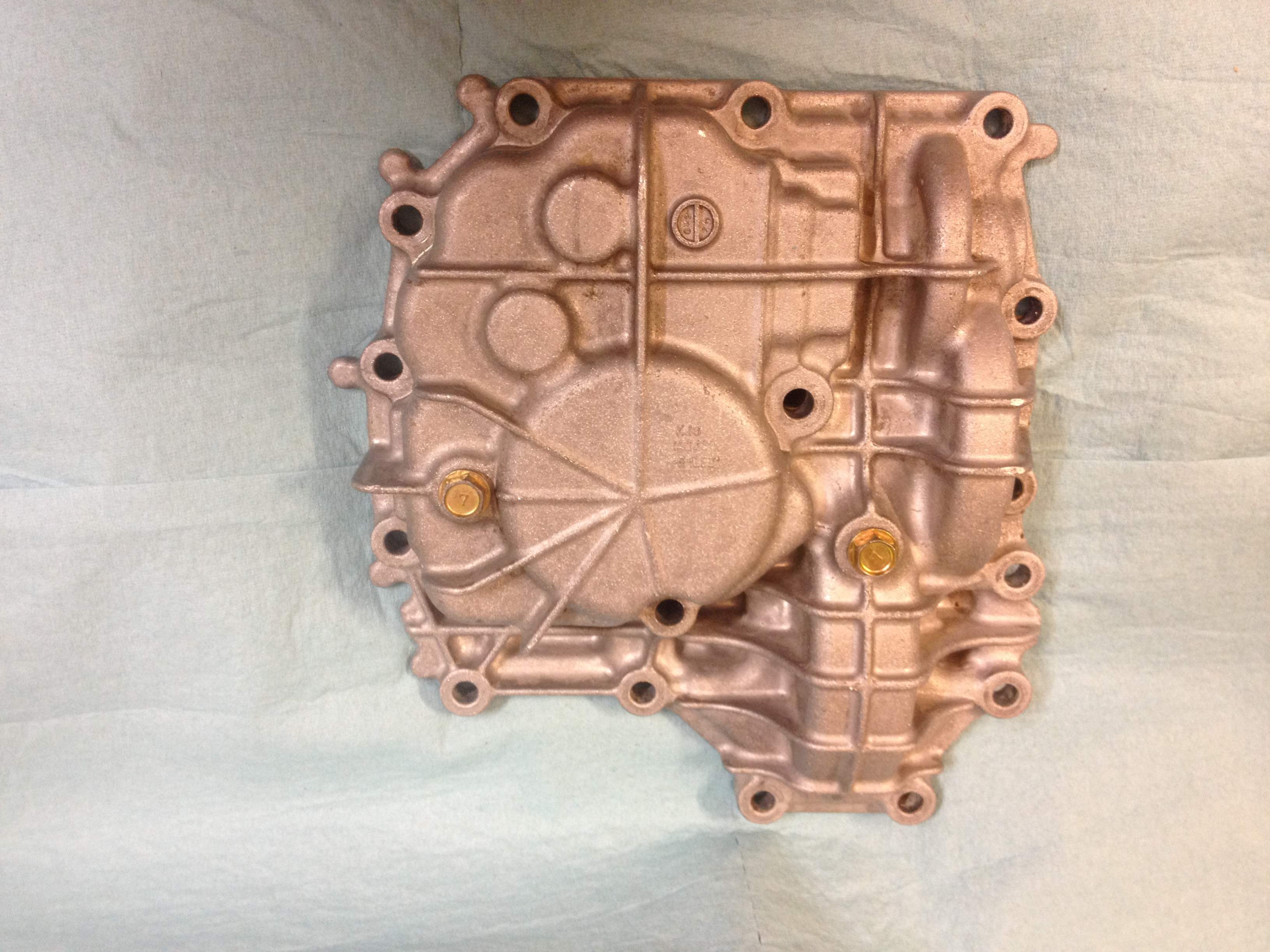

Hi from England
I have a tractor fitted with a K46E. It is apparently fitted with 2 drain plugs but it is not clear which of the bolts on the underside are the drain plugs, the exploded diagram on the TT site is also unhelpful. Any advice available please?
Also for replacing oil. I have the black disc under the Fan which also houses the magnet but I also have a 'header tank'. Most instructions say fill from the port under the black disk but after purging air, top up via the header tank. Can anyone please clarify the situation. It would be more logical to fill from the header tank access.
Thanks in advance.
The K46i from my Husqvarna Rider 155 has two drain plugs as well. Both of them have a sort of washer under them that makes them sit up slightly and they also have the number 7 stamped on them (see attached photo). I hope that helps. I'd still fill the unit through the hole that houses the magnet as it seems to have a more direct route to each side of the case.

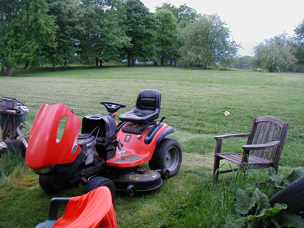

5 20 13 074.jpg5 20 13 089.jpgWell now that I spent $300 on the Scotts L2548 trans. pump block (works fine now) the rest of the mower is falling apart.....Brigs engine pops and backfires...the starter clicks and randomly engages, then sticks on after the engine starts, and the new mower deck belt is fraying at the edges after the first use....Not to mention the time spent on snapped bolt on the electric pto a few years ago. I suppose my 3 acres is just too much to ask for this home depot machine. I found a starter on e-bay for $33. will maybe buy a new fuel pump and new fuel hose to the gas tank, try to fix the deck (maybe spring for the kevlar belt). Sorry I had to Rant. Will borrow my dads old 210 next weekend. Oh yea the steering has broken several times too.
