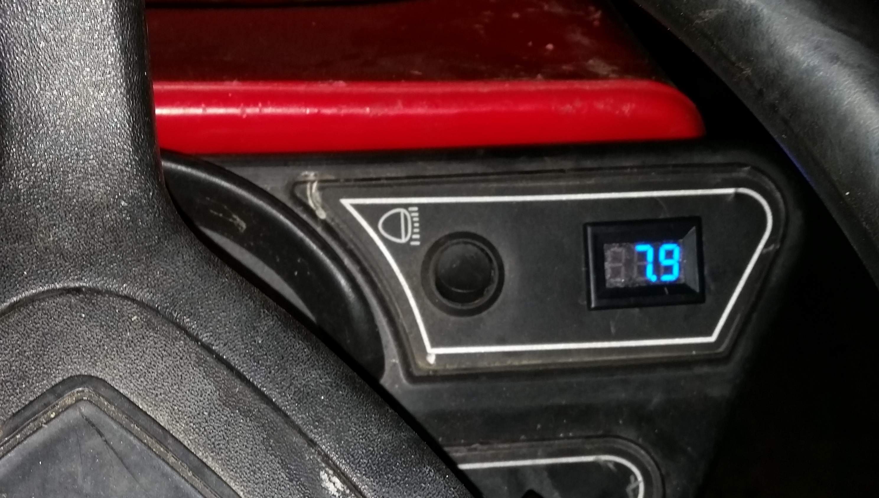

After a year using my last K46 rebuild (with lapped casing, rotors and 5w40) it developed an oil leak around the rubber plug so it's been replaced with the spare unit for this season. The spare has had the lapping done plus new planetary gears and a couple of spacers to remove the ridiculous amount of slack in the differential.
As I intend using it with some small chain harrrows (yes I know I shouldn't) I've added an oil temperature gauge to the Countax dash just in case.
Countax have an oil header tank so I just dropped the sensor through a grommet in the tank and down the header pipe into the top casing, just and inch or two into the oil and tied it off.
The digital readout fitted nicely into the dash too.
So hopefully I should now see when I'm overworking the K46.
For the work involved I'll be happy if I rotate the units every couple of seasons.
the temperature stuff came from;
DROK® Digital Thermometer Electronic Temperature Monitor with Long Probe Sensor Portable Light Pocket Temp Test Measurement Meter Gauge Device for Fridge/Refrigerator/Lab/Wall/Pool/Baby Bath Water/Body Temperature/Inside & Outside Auto/Car/Indoor & Ou
   / TuffTorq K46 Repair Guide with Pictures #815
Follow up, first attempt using the rebuild with a temperature gauge and 5w40 synth - all the store had at the time of the rebuild ;-).
FYI, running well without the harrows, oil temp creeping up slowly no noticeable problems, haven't recorded a typical temp as I was more concerned about general running.
With the added loading of the chain harrows, once the oil temp start to rise to above 37-40 c the tranny starts to loose power noticeably and when left alone to cool down the power comes back again, in fact just dropping the harrows and riding around lowers the temperature. The 37-40 variation seems to be dependent on the degree of roughness and slope so I'm assuming it's internal temperatures at the motor/pump is rising quicker in some areas of the landscape than others while dispersing the heat at an equal rate.
The infra red temp at the hottest spot is 2 about degrees higher than the gauge.
Interestingly the Countax service bulletin from 2000 says at PDI, top up with standard SAE30 engine oil.
