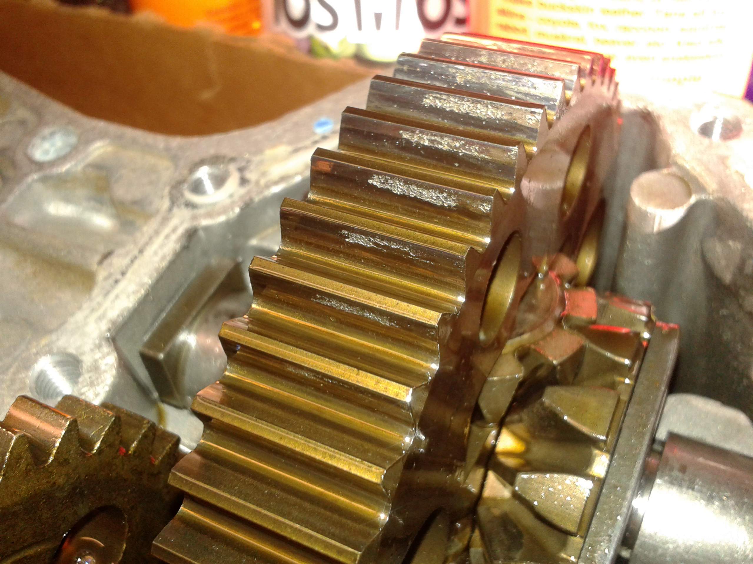

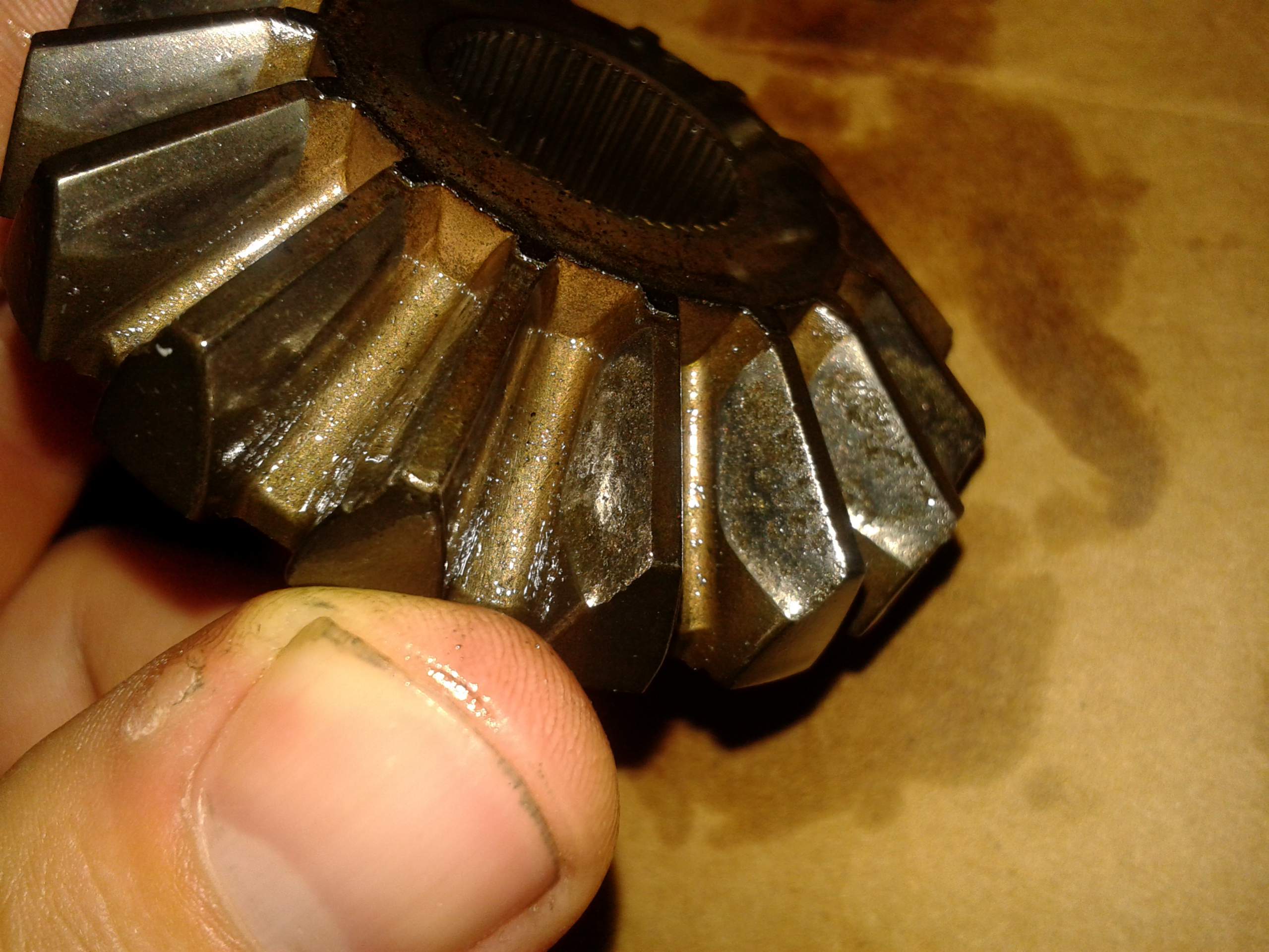

Hello. I recently replaced/rebuilt my K46 after the differential gears got shredded. I did not replace the pump or motor assembly, just cleaned them and reinstalled correctly. The other day I cut my brothers lawn and after about an hour, it started making a lot of whining noises and would no longer go over small concrete ledges in his yard while in reverse. I called tuff torq and he thinks I need a whole new rebuild kit, near 400 dollars in total.
What do you guys think? I would really not like to spend all that money and wonder what my options are and if I can just replace a certain piece and make it work.

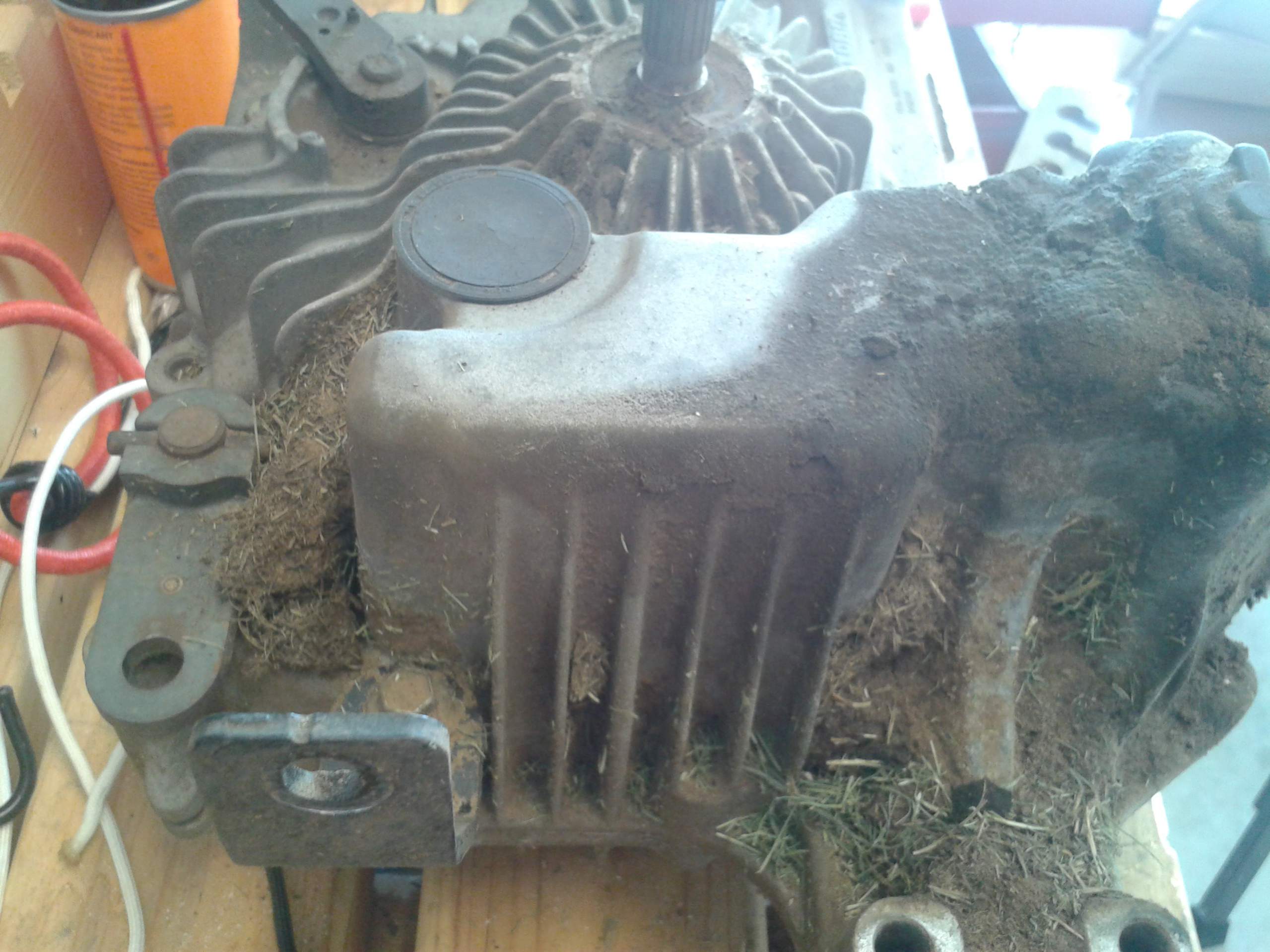

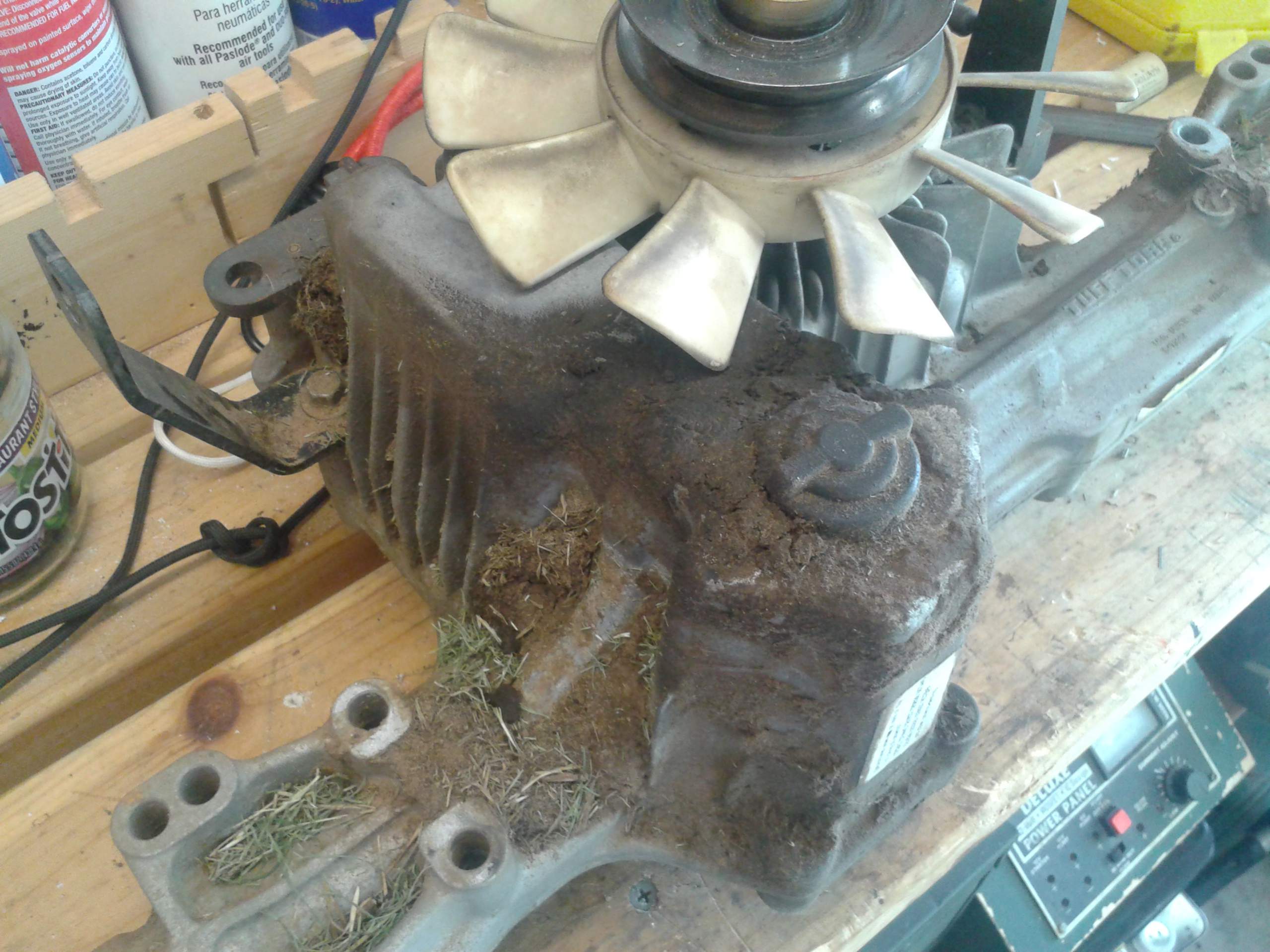

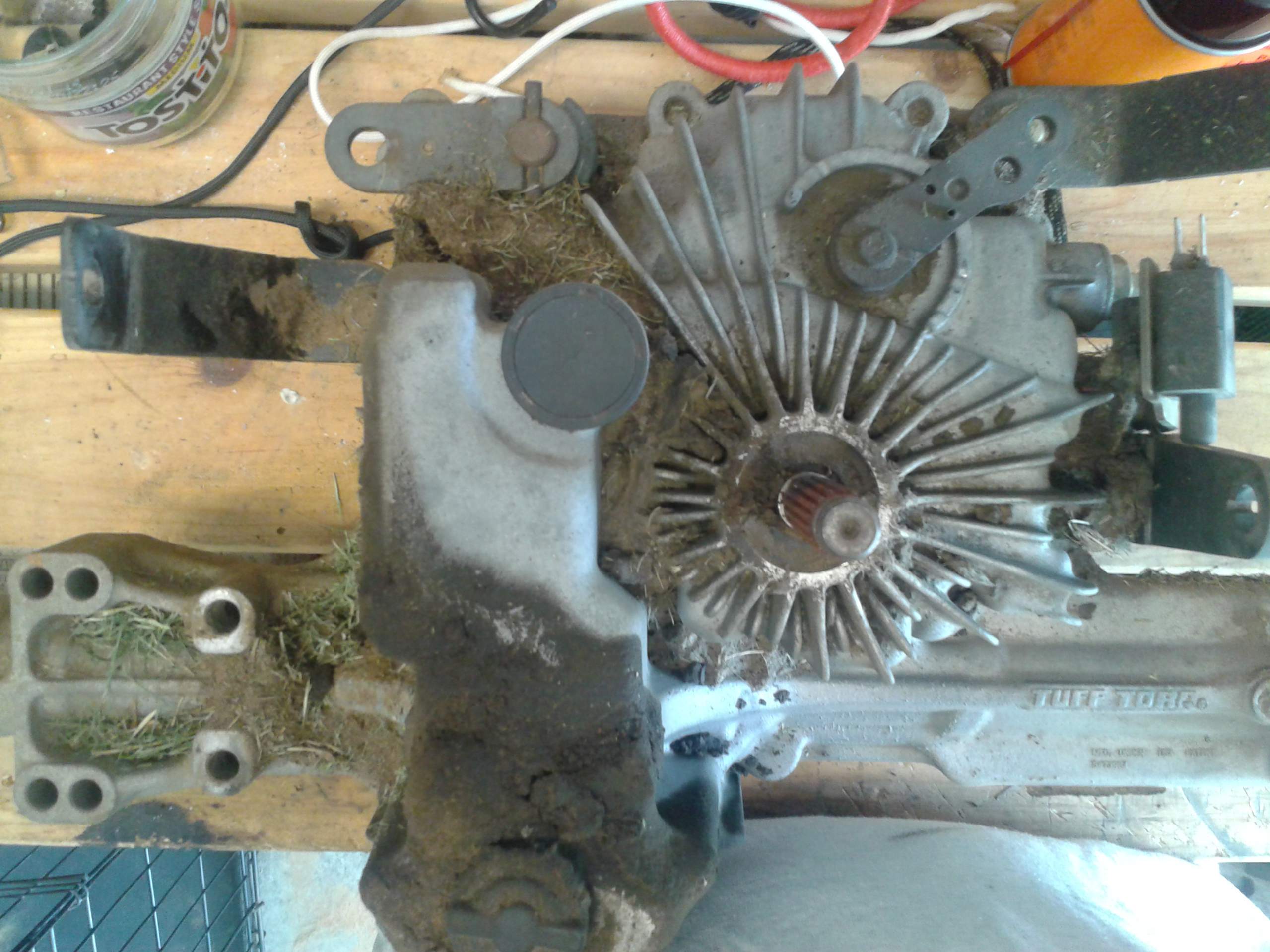

Some K46's last a long time, while others do not. What is the secret? Read on..
The K46 Transmission, found in many models of small lawn and garden tractors, is often cursed at for it lack of durability. This transmission often requires replacement long before the rest of the lawn mower dies. Replacement cost reach 50% or more of the tractors original cost, if the work is done by a smiling JD Tech. Thus the phrase disposable tractor and transmission is often tossed around. Owners are stuck with few options.
I had noted that my John Deere L110 max. speed was down a bit, and the groans from the rear end had increased. I knew the end was nearing. I found very little information on how to do this rebuild on the net. Most of what I found was pushing for an upgrade to a K66. At over $1000, I felt this is not viable option. After all, I only paid $1495 for the tractor! My feeling is that this tractor is not really designed for what a K66 can do. Something else is likely not going to hold up in the long run, even if the transmission is bullet proof. I decided to rebuild the K46 myself. After all, what's a good weekend project without the Fire Department involved?
My journey began with a discussion with a TuffTorq service tech at the TuffTorq Service Center in TN. Their telephone number is (423) 585-2000. Their web parts address is: https://www.tufftorqservices.com/EnvEElogin/html/login.html. Derrick Dalton was quite helpful. I had heard there was a rebuild kit, but it was over $300. So I asked the question of the Derrick. "What are the parts that are most often replaced when the K46 fails?" He graciously provided this information. My parts totaled $162.95 delivered with tax. Amazingly the parts arrived in 1 day!

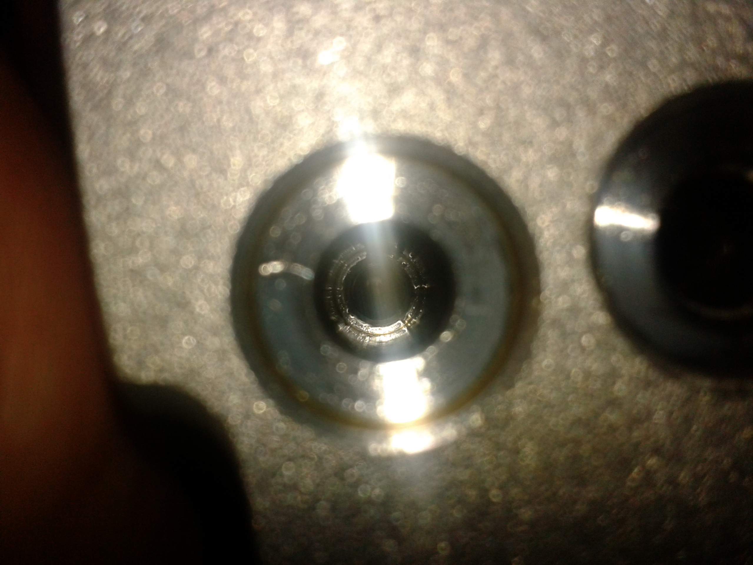

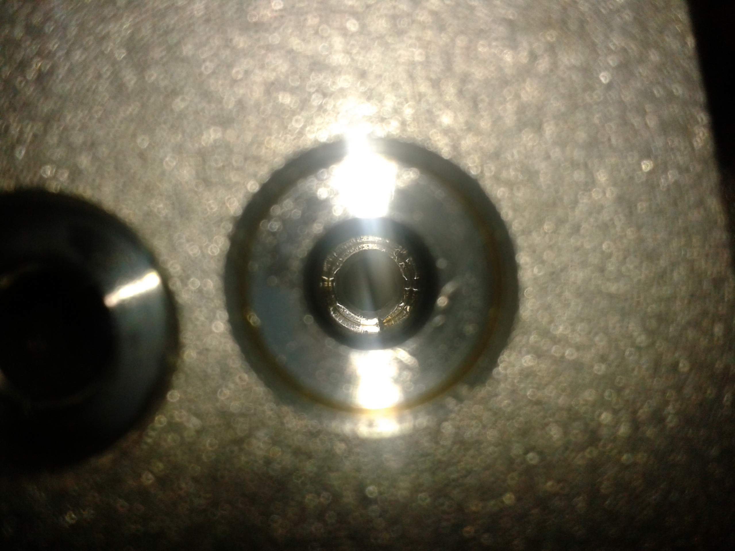

Does anyone know what the "Ball IDS" and "Filter IDS" do?
Are these fluid relief valves? If they are fluid relief components, has anyone tried stiffer springs to improve pulling power?
Restorer
The IDS valves are fluid relief components that smooth the transition from moving to stop. If they were not there the transaxle would stop turning completely when you took your foot off the forward pedal and the wheels would lock. They are open or closed based on grooves machined into the plate they push against. The springs are there to keep them against the plate.

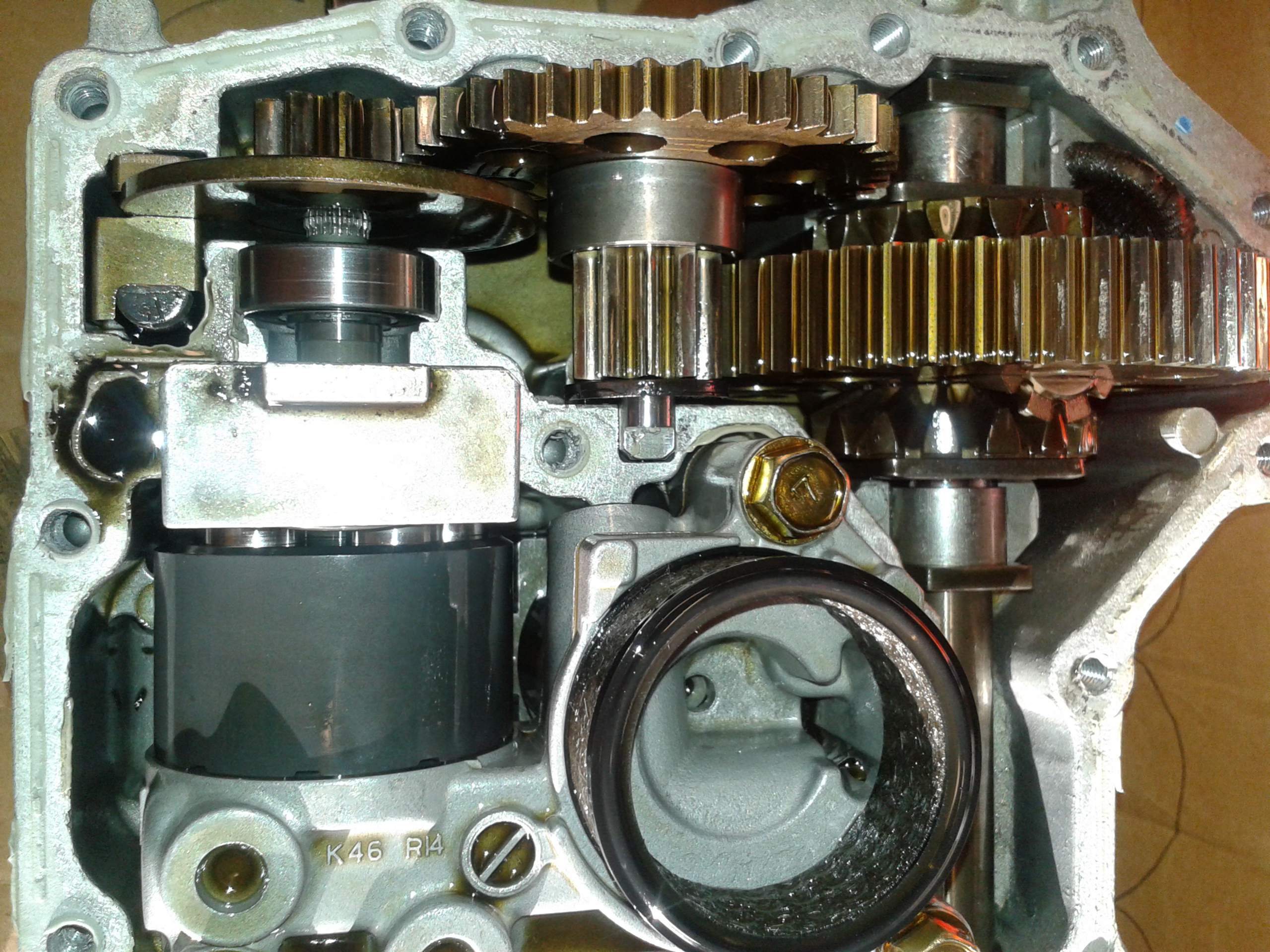

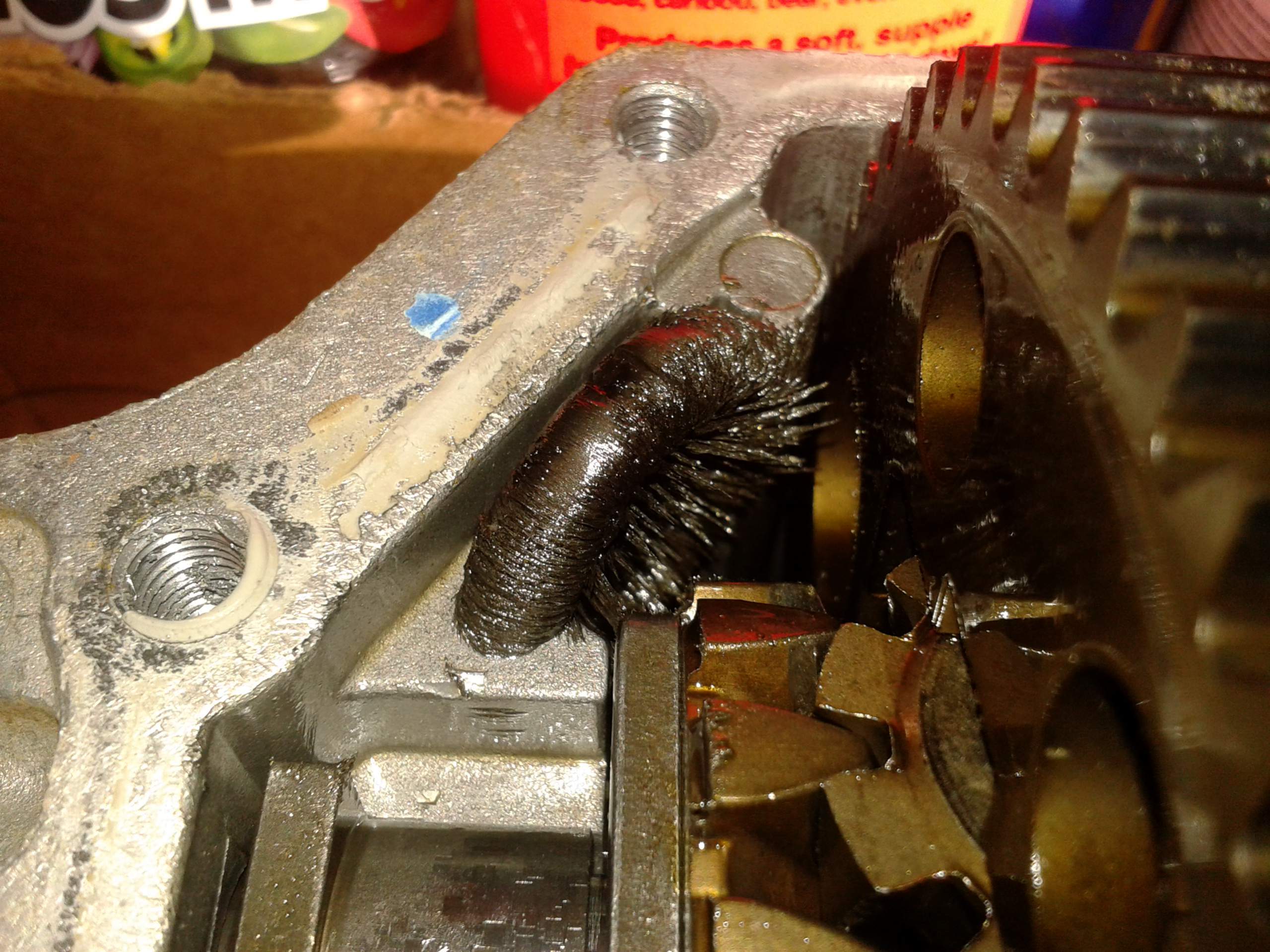

I have an L120 with 450 hours. The K46 needed a rebuild as it would lose nearly all power after driving 30min of warm up. This thread and forum was extremely useful and great videos out on youtube as well. I'm posting because my findings seemed different than most. After research, I ordered the motor, pump and filter from tufftorque like others...and fill cap!...by the way, stick with the tufftorque website. There is more than one avenue to see/order parts separately even though the over all parts list looks hopeless. copy the part number u want and enter it in the search window. Opened my K46 and really didn't find any defects with my motor and pump although I did replace them. I found that my gears were fairly worn (fretting corrosion) so i ordered and replaced them. I also pulled the IDS valves out of the center case and found that the ports on the center case were damaged...not smooth at all. I ordered and replaced the center case with the new improved center case with filters and magnets (probably a reason the design changed....). I used 5W50 synthetic. The tranny is tight and runs strong and quiet. After my rebuild, I think I would have to recommend opening and inspecting your parts before you order anything. I'm pretty sure the center case was my smoking gun in my case and I'm glad I have new gears and filter in there. Motor and pump were wasted money I believe. Here's some pictures for reference. 20150623_193024.jpg20150623_162712.jpg20150625_213906.jpg20150623_193035.jpg20150623_162724.jpg20150625_213917.jpg20150623_193311.jpg20150623_193012.jpg20150623_161920.jpg20150624_211613.jpg
