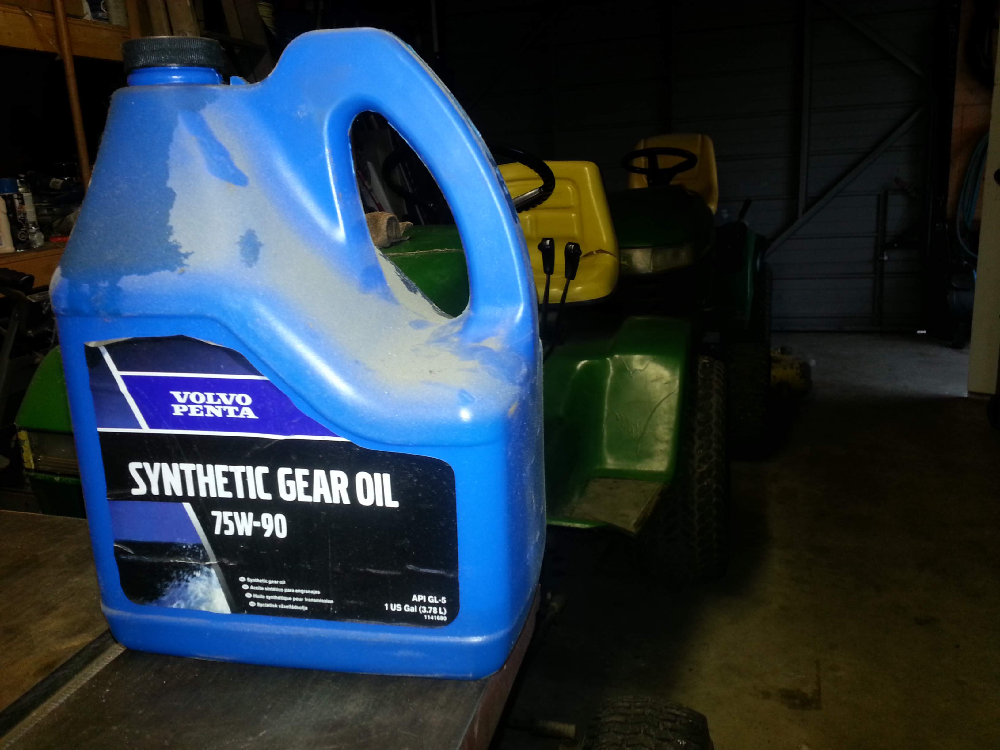

I have been running this oil for a month now and have about 15 hours accumulated.
It is working as good as it did when I first started using it.
Here's Two example of the differences between 5 Winter 50 synthetic and the Volvo Penta 75 Winter 90 synthetic.
Don
Hi mate, a couple of questions.
1/ Can you explain re Winter synthetic - is there different types eg; one for summer and one for winter
2/ Did you open up the transmission and clean it out before changing to this oil, or just turn it upside down and drain it.
3/ Being a thicker oil I assume it takes less to fill the transmission, any idea how much less.
4/ Have you used it for more than an hour yet or would you be confident it will do so.
Many thanks
Curious Aussie.

1.) You can google to find out what the 75w 90 means but a simple version is it is a winter rating for oil to pass through an orifice at a certain temperature
2.) The 5w 50 was not too old so I just drained it out.
3.) No less, the same amount.
4.) Have used it for over two months approx 60 hours. No problems. Very confident.
You guys are going into summer down there, stay cool!!
Cheers Mate!
Don
