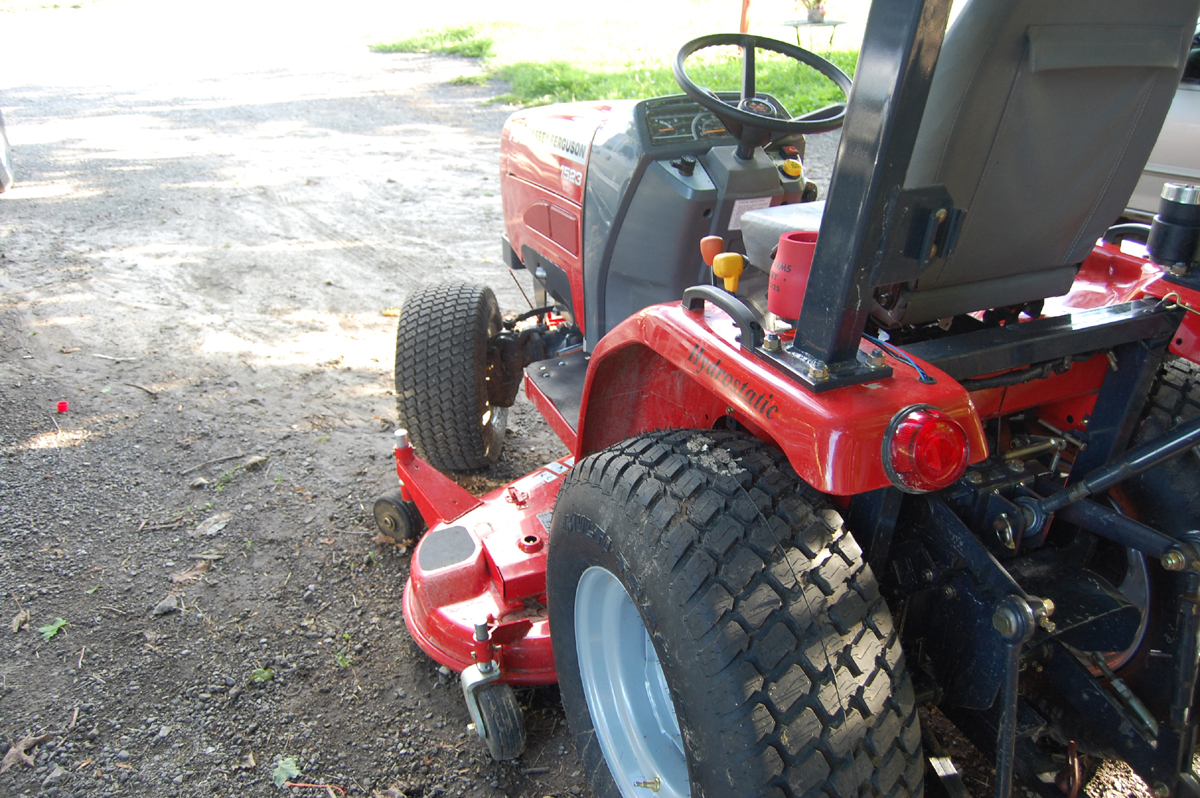

Glowplug said:
Here is what we will be using on our 1523 this winter!! :) We will be adding chains tho'!!
