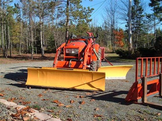

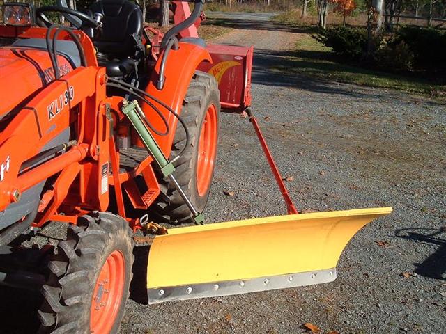

Answer a bunch of other questions and you may get closer to your answer.
1. Wet snow or dry snow, you'll know which one if you've had any amount of snow at all?
2. Paved or gravel?
3. Ground frozen or soft?
4. Is the lane level or hilly?
5. How much snow are we talking about? (worst case)
6. How much weight on tractor?
7. Do you want to plow right down to the surface or leave a layer?
8. Do you plow at an angle, straight ahead or blow it off?
9. etc, etc, etc, etc
You can boast all day long, but it comes down to preference.
Steve
