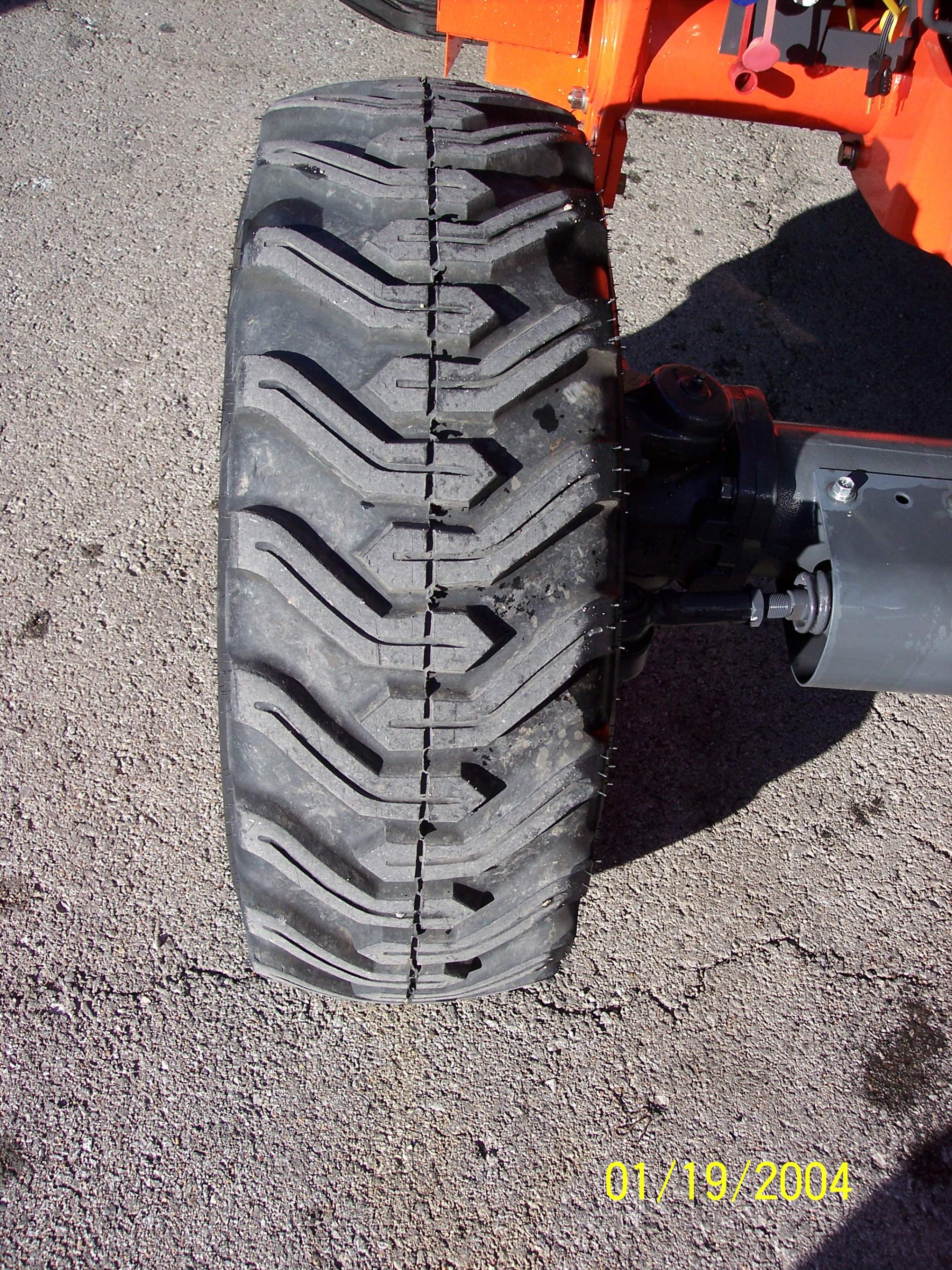

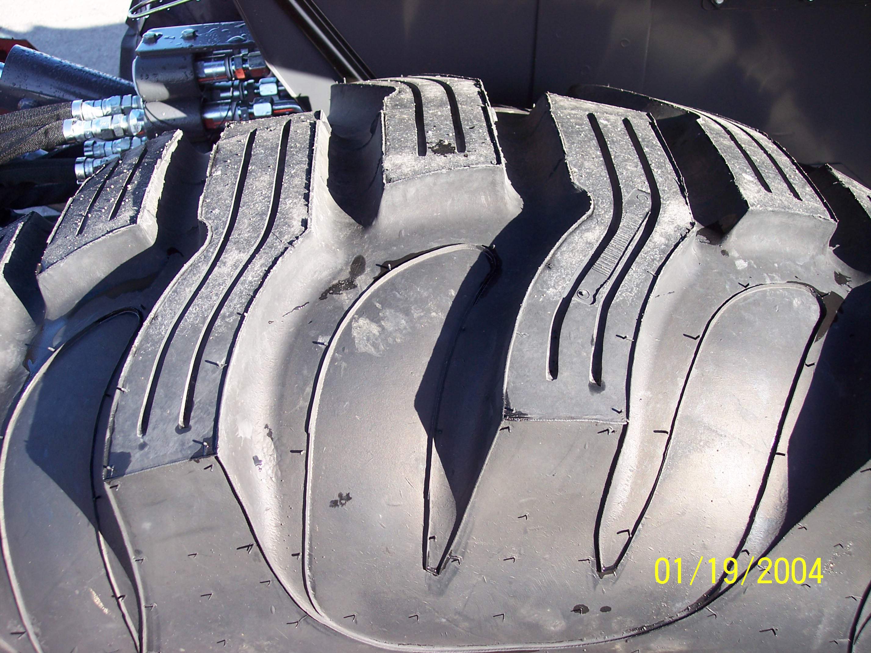

Weight is your friend when pushing snow. And my experience is on pavement, turf tires get the best traction in snow and on ice with no chains. I have had two tractors with turfs that I pushed with for a lot of years. No chains, just Rimguard in the rear tires for ballast, and my salt spreader on the 3pt. My R1's were horrible until I grooved them. More biting edges = more traction. (snow and ice) :thumbsup:
Obviously the date was wrong on my camera. :laughing: :ashamed:
