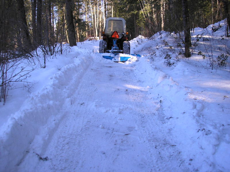

BrokeFarmerJohn suggested very good turf tires I ran them for 4500 hrs. on my last tractor replaced the front ones once and the rears are still going strong for the fella that bought the tractor.
Plowing snow up a steep hill no chains. Only put chains on 3 times in over 20 years due to straight ice.

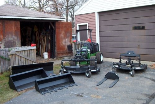

That's pretty much exactly the same tread I have on my Carlisle turf tires on my PT425... 16 years and still good.
511711d1496710382-turf-vs-r4-industrial-tire-pt425mainpic-jpg
